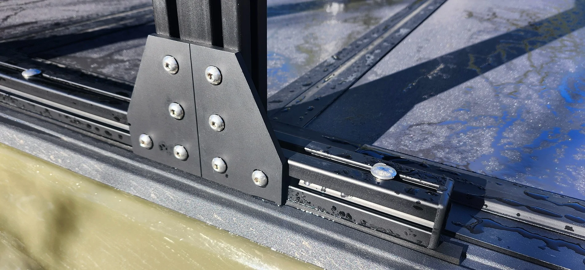

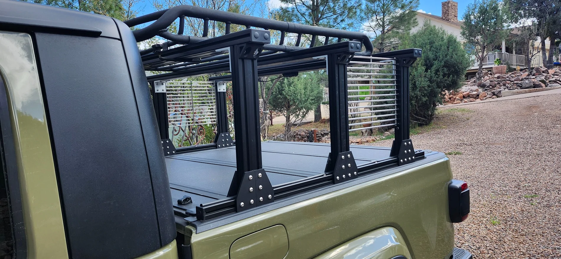

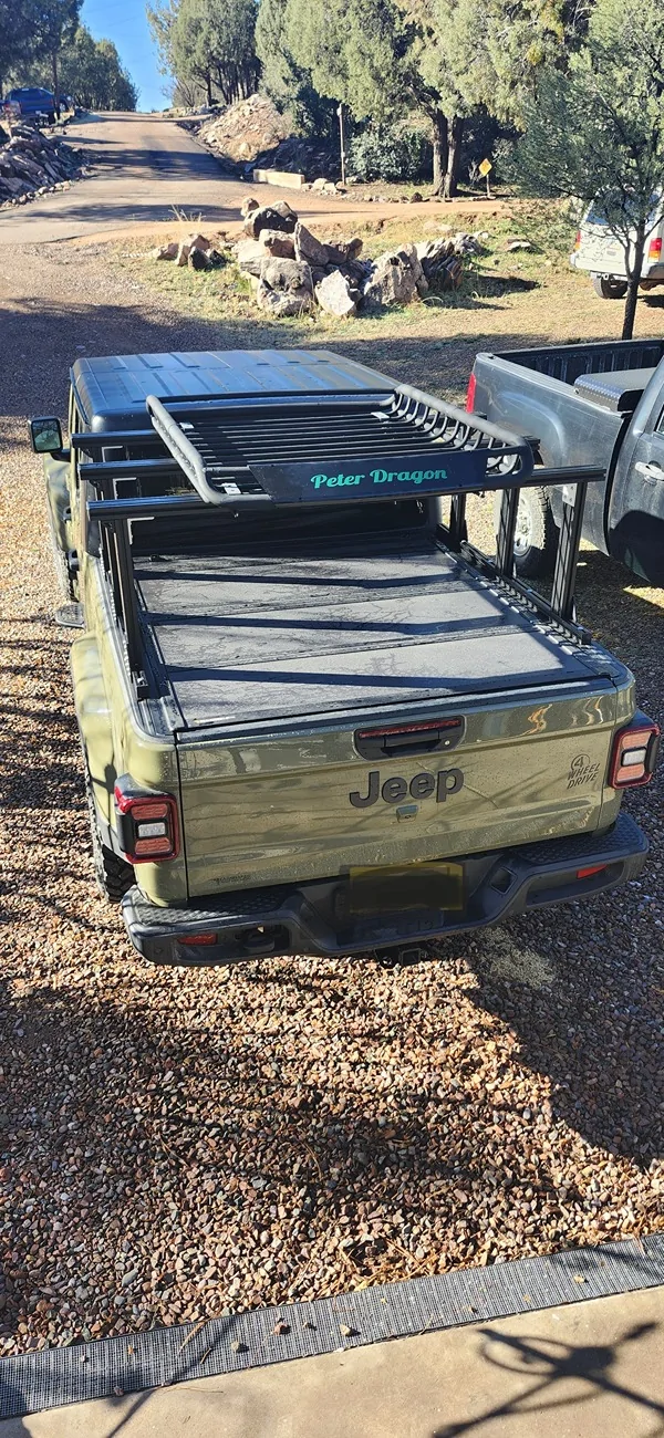

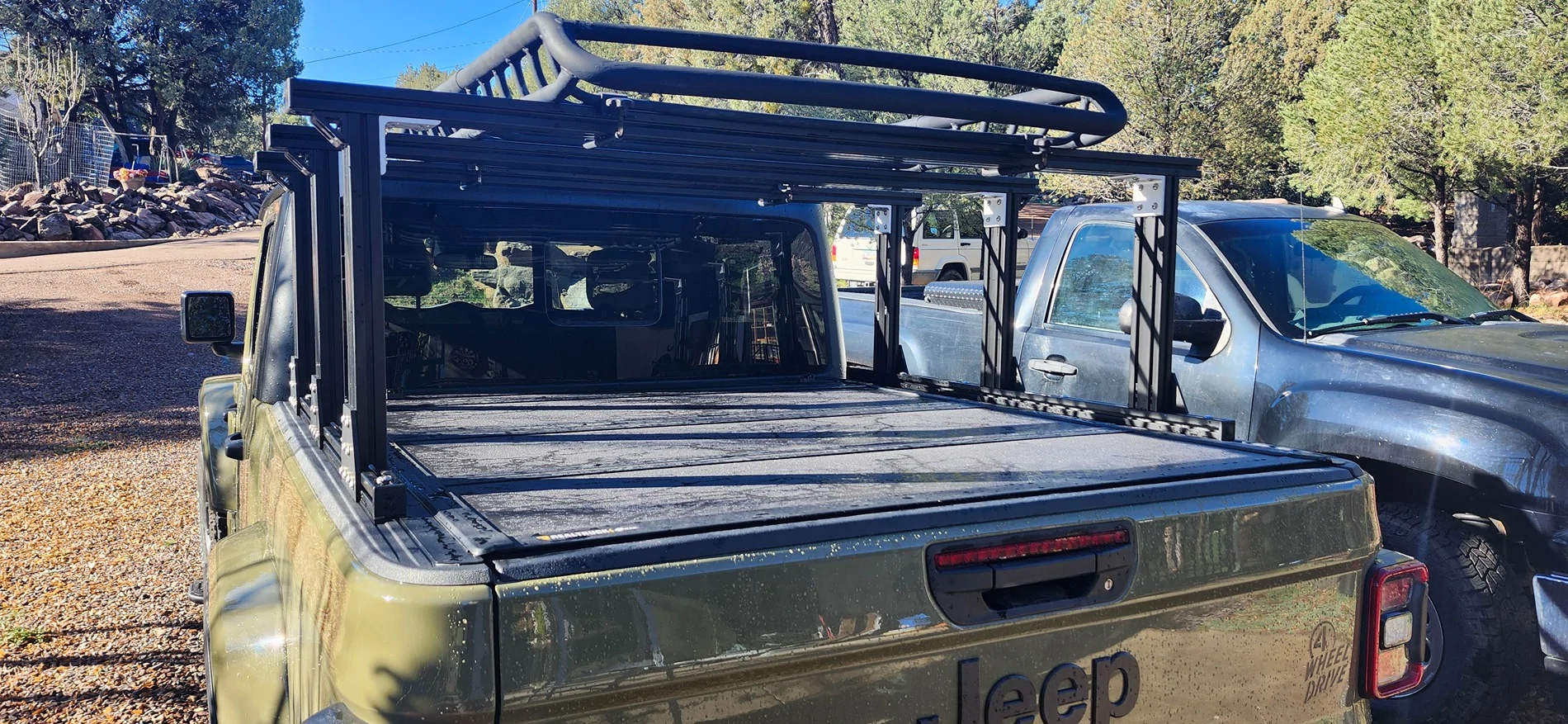

Pretty much finished with the rack. Came in about $900 but includes the center support (which isnt attached to anything and not necessary). Rack~80lbs, Thrule~40lbs. The main thing is that the MX4 cover works and the rack is solid! Ill add a fold down shelf and maybe molle racks, hooks, handles etc. The extrusions are the heavier thickness, maybe could have gotta a way with the Lite version and saved $100 but no complaints. This thing would double as a roll bar! Notice the 3x5/16" SS carriage bolt fits in the rail groove nicely. I have some rubber gasket still to go, to shed water.

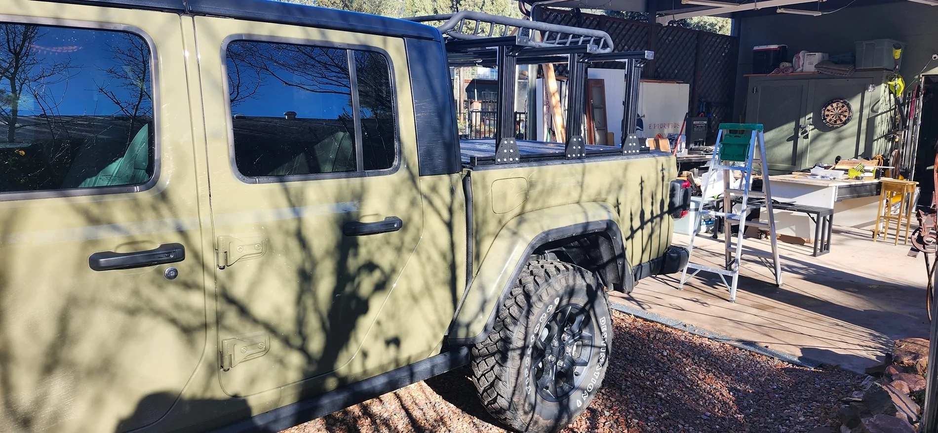

Done with the rack finally. Looked into molle boards but they can be expensive for what I needed. So Charbroil helped me out with some replacement grates that fit the Tslot channel perfectly. 7mm rod into an 8mm slot. 2 for $34. A dab of RTV keeps them from rattling. The whole rack is solid and I could put a RTT up there but dont like the idea of climbing down a ladder in the middle of the night to take a wiz.

Hi @peter dragon, this is exactly what I want to do with mine. How is it attached to the bed? Is it using a t-slot in that tonneau cover? I have the Mopar tri-fold, which doesn't have a t-slot.

I used five sixteenths by 3 inch stainless steel carriage bolts and drill through the top of the bed. It doesn't attach to the cover at all it rests on the side flange of the cover

ah, gotcha. Thank you for clarifying! I'll explore that option. I'm guessing, but it looks like like you used 3 total for one side? Is it still holding up well?

3 is plenty for each side. i have lock nuts and washers underneath. no problems so far.
