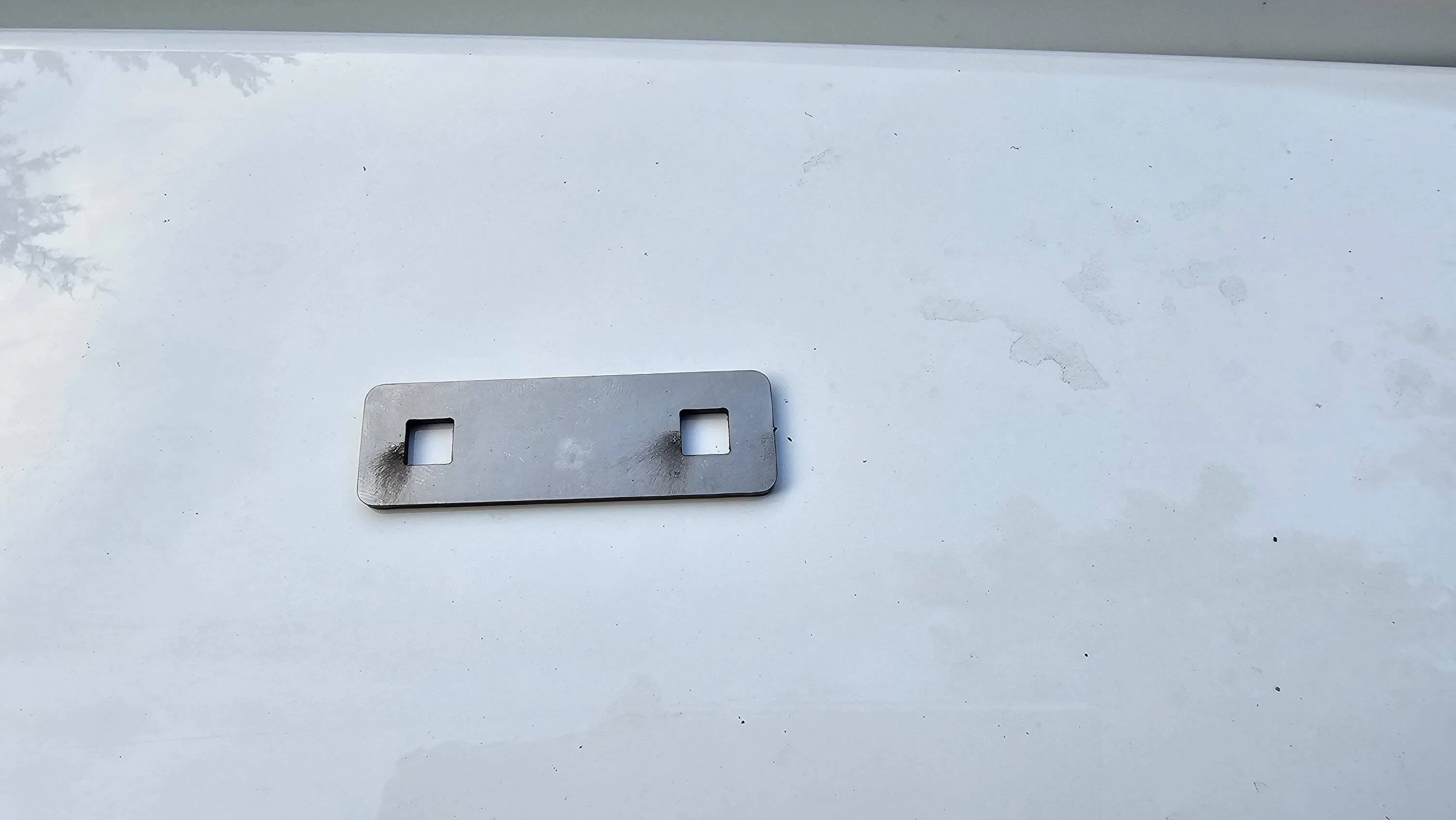

I have stock cargo rails in the bed, front and sides. And installed bed rack that blocks entry slots on the rails.
Looking for something like roll-in Tnut, ideally. For example, this it regular t-nut that fits - https://a.co/d/02IbpuR
Or a thinner plate that can be pivoted and inserted in a slot from outside, together with a carriage bolt. Photo attached.
Couldnt find either of these online. Please share your mounting ideas.

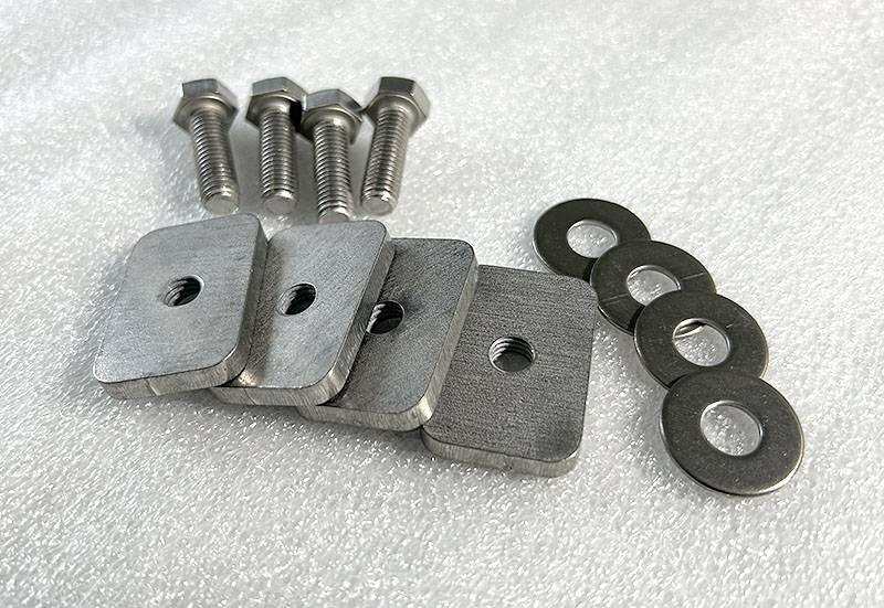

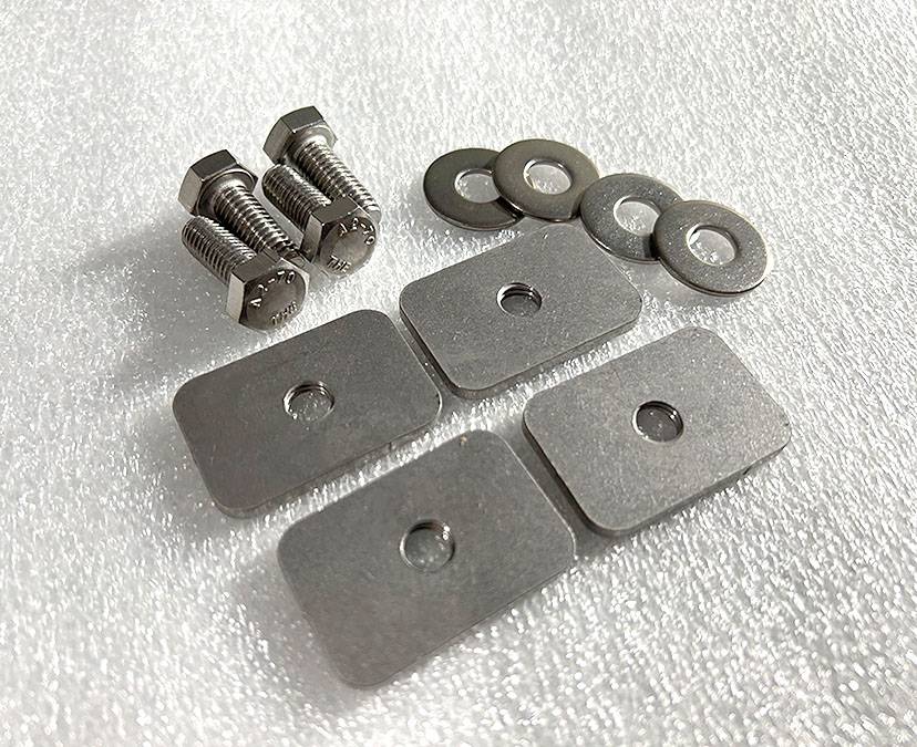

I have two sets of stainless rail nuts that I designed to work with my compressor mounts and MOLLE panels. Two different thicknesses depending on what you are mounting.
https://www.813fabrication.com/product-page/heavy-duty-stainless-steel-bedrail-nuts-187-thickness
https://www.813fabrication.com/product-page/stainless-steel-bedrail-nuts-125
Let me know if you have any questions! These drop in without having to remove anything.
Jeep Gladiator Bed rails mounting options rail-nuts-187-3
Jeep Gladiator Bed rails mounting options rail-nuts-125-1

Oh man, I wish I knew about your brand sooner. Love having aluminum molle panels. I just bought and installed full set of JCR bed panels, their bed rack and bed rack molle panel that covers the rear cabin window. Their molle panels are nice but HEAVY!
If you put two rail nuts side to side what is the distance between threaded holes? I need to check if I can use them behind JCR bed rack "leg" that has double holes for bolts.

Glad you like my stuff!
1.5" center-to-center for the threaded holes if they are sitting side-by-side.
