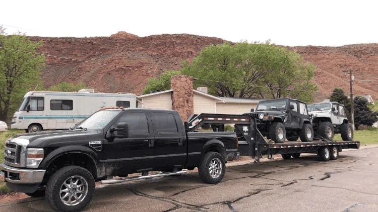

V10 and my son's and my Jeep.
Jeep Gladiator Beefier towing rig 1677129581261

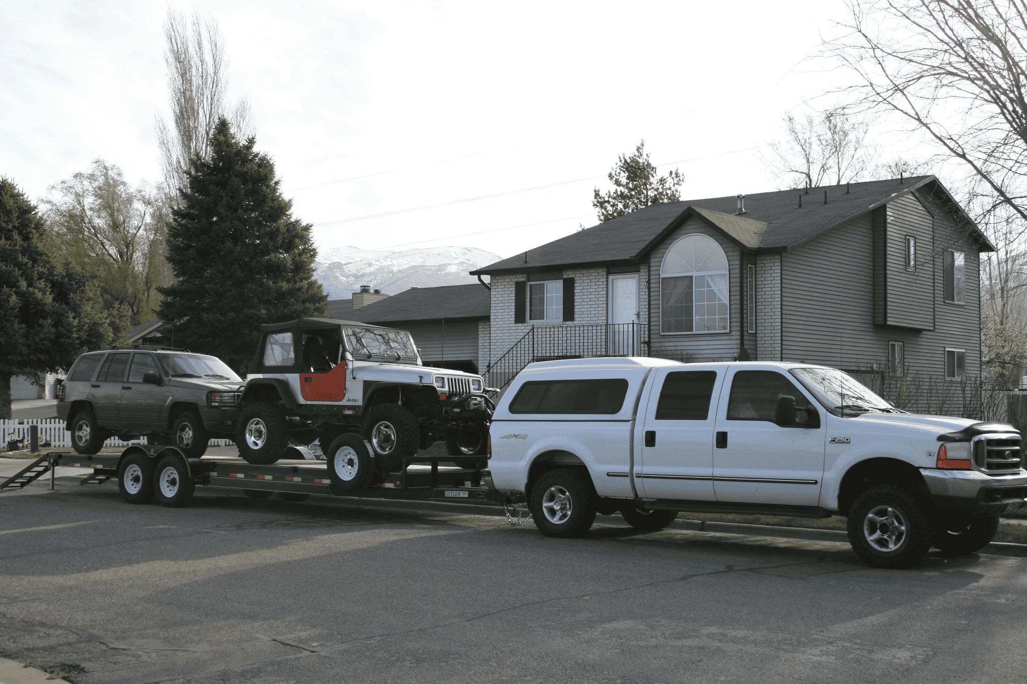

'99 Powerstroke
Jeep Gladiator Beefier towing rig 1677130185329

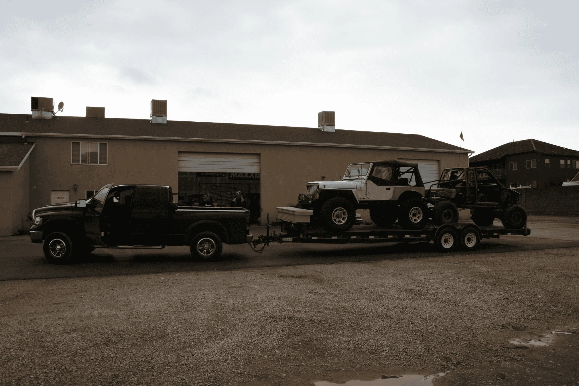

'04 Dodge
Jeep Gladiator Beefier towing rig 1677130703234
