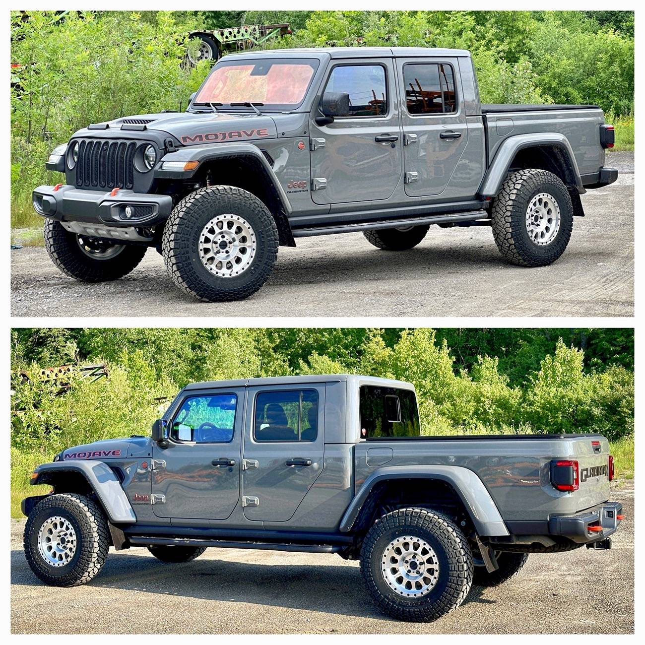

2022 Jeep Gladiator Mojave. First Jeep.
2” AEV w/GCBs and nothing else mechanical. The GBCs utilize their top hole (of 3). Drives as exceptional as anyone would hope for/expect it to. I could not imagine being any happier with its driving characteristics. I am a firm believer in PROPER hub bore size wheels, which is 71.5mm.
35x10.5x17 on 17x8.5 and 0 offset Method wheels during the warm weather months.
255/85R17 on stock Mojave wheels with (pictured) or without 1.5” wheel spacers (aesthetics).
Jeep Gladiator Best Mojave Lift & Tire Setups? IMG_3996
Jeep Gladiator Best Mojave Lift & Tire Setups? IMG_3997
I am holding my phone. Don’t hold the shakiness against me. Hah!

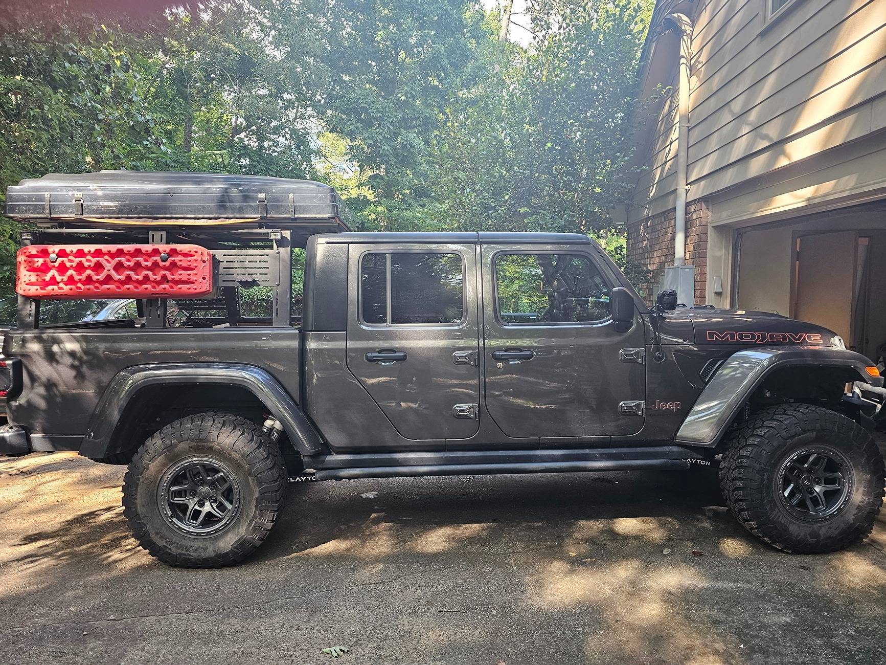

I have ran a couple different setups on mine
1.5” Clayton on 35’s, with factory shocks and it didn’t take long for the front to settle way to much for me
Jeep Gladiator Best Mojave Lift & Tire Setups? IMG_4374
here is where it is at now with 3.5” Clayton front and 2.5” rear with falcon sp2 3.3 shocks and the same 35’s and the ride is amazing even better than factory. It does still have about a 1/2” rake and that is plenty for what I haul (cooler, ground tent, shower tent, fishing poles and chairs)
Jeep Gladiator Best Mojave Lift & Tire Setups? IMG_4964
Sorry for the crappy pictures not much of a picture guy, the 35s will be getting upgraded to 37s once I wear these out but I have no issue with it sitting on 35s

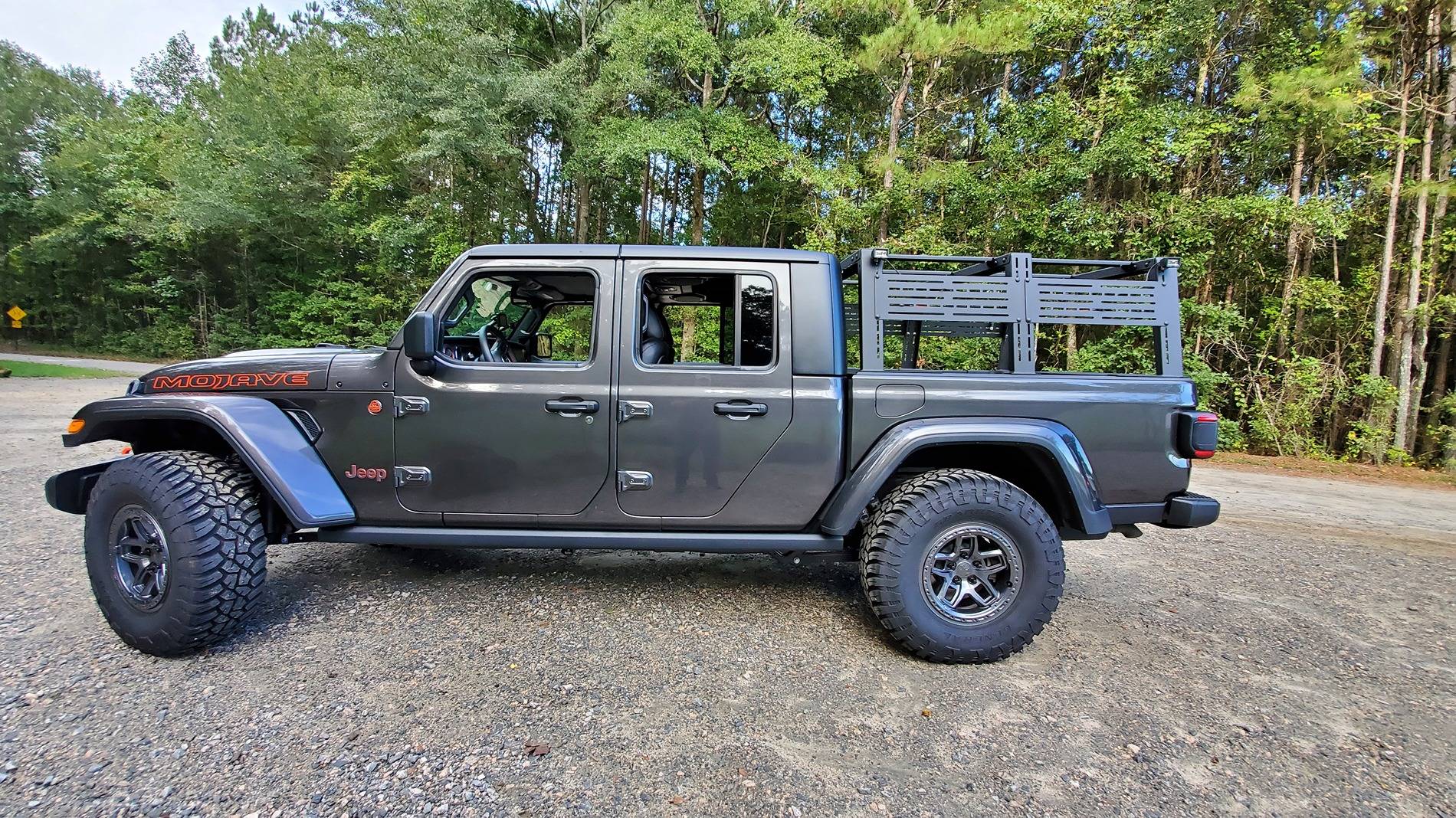

2021 Mojave Granite Crystal
Software Engineer

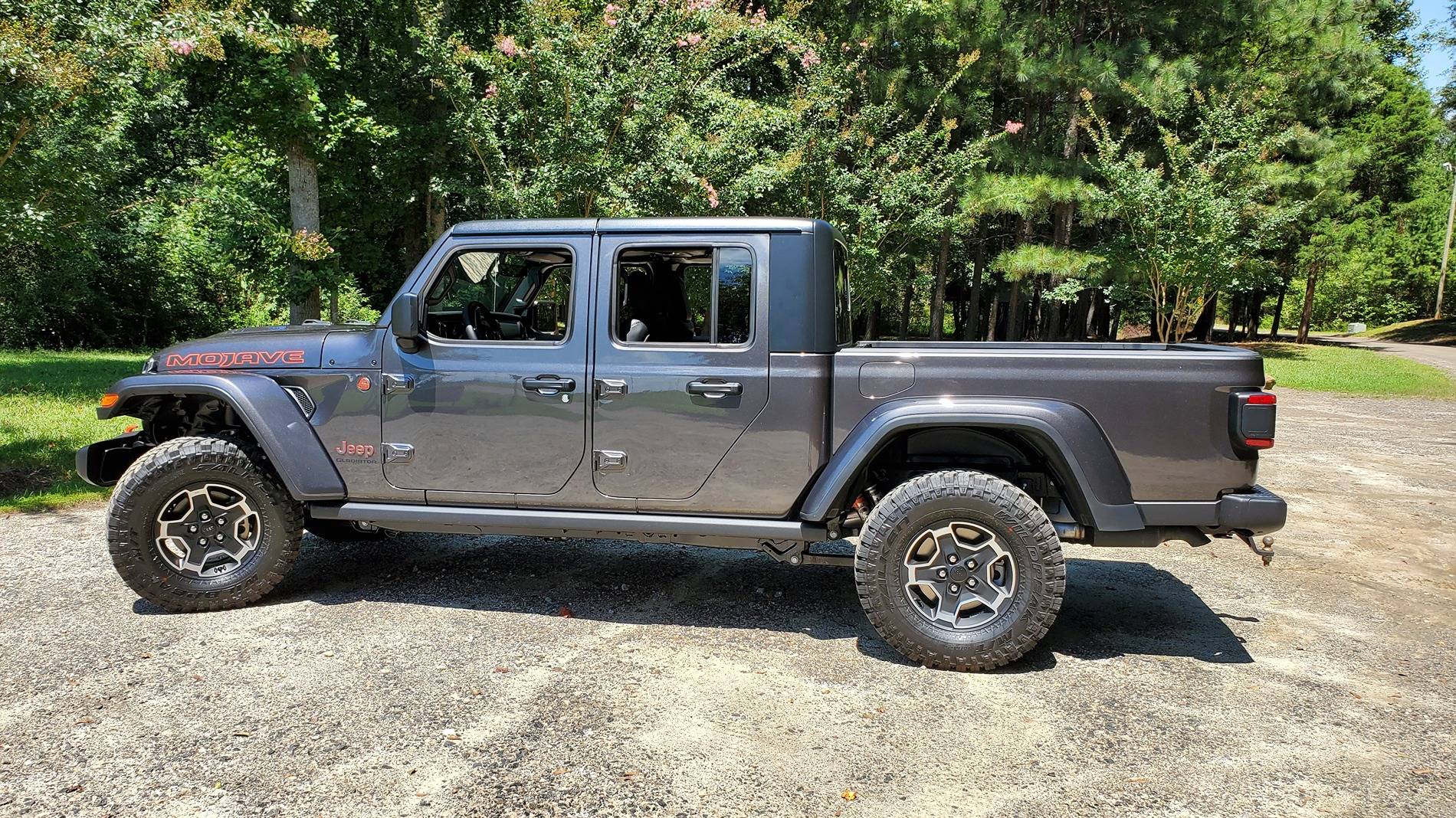

Brand new
Jeep Gladiator Best Mojave Lift & Tire Setups? 20210820_130909
35's - Original Suspension
Jeep Gladiator Best Mojave Lift & Tire Setups? 20210922_175359
2.5" Clayton Overland+ Lift w/ Falcon SP2 3.3 Adjustable Shocks
Jeep Gladiator Best Mojave Lift & Tire Setups? 20240603_173242

Nice.....did you keep the factory Fox shocks, using extensions?
I hope He didn't the factory shocks was toast by 35k and Way Way too soft
zxd9
Mark
Apr 7, 2020
196
249
Athens, GA
Software Engineer
No, I replaced the Fox shocks with Falcon 3.3 SP2 adjustable shocks. The fox shocks had 68k miles on them so it was time. Really like the Falcons.
