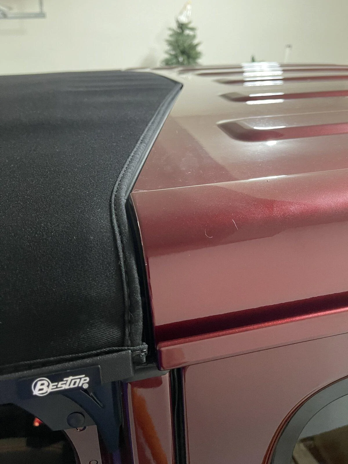

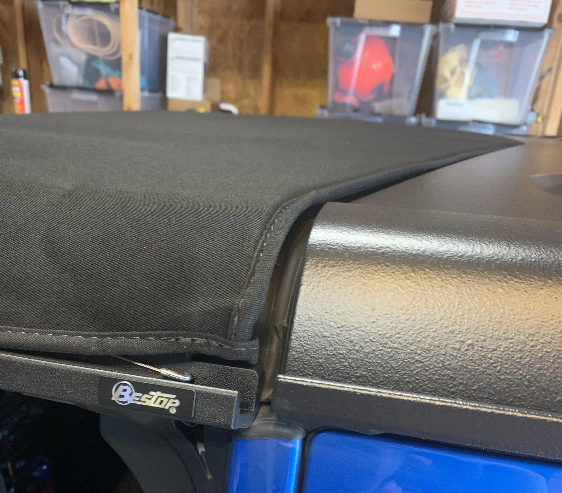

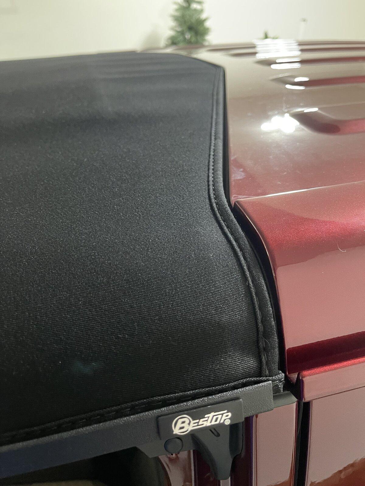

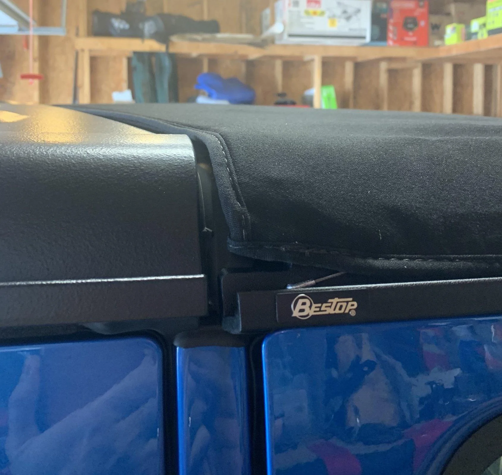

My driver side at the seam seems to go up a little compared to the passenger side which is flush with the top up. Does anyone have this going on with their sunrider?Is there anything I can do to adjust it? It doesn’t seem to be much just concerned about water getting under that part of the seem.
