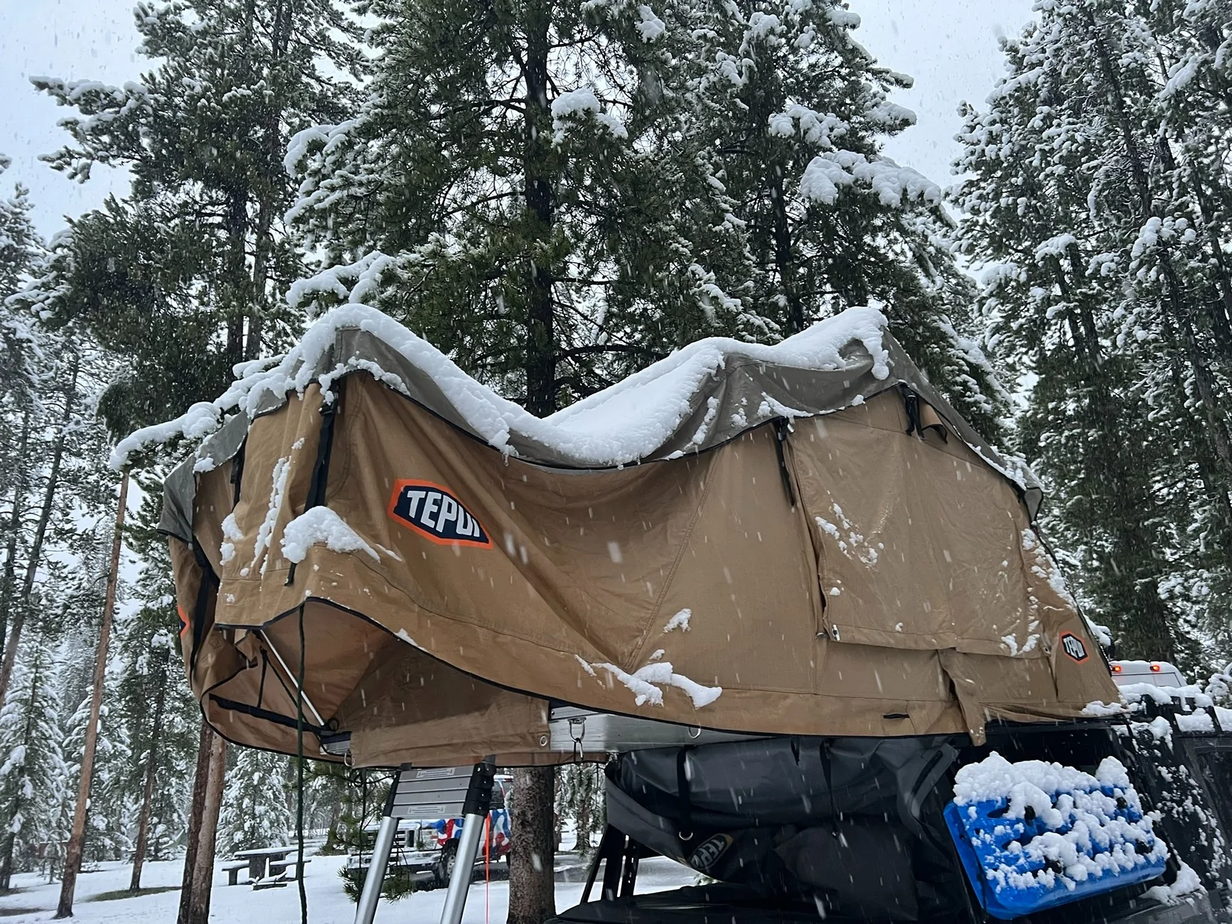

You know a few years ago when Yellowstone NP got hit with all the flooding and roads got washed out? This was just before then - Memorial Day weekend. And yes, we had the Sunrider on.
Jeep Gladiator Bestop Sunrider and snow? IMG_0345
It was wet snow, so it did sit and as the truck warmed up, water did seep in a little. But we're talking a couple drops. The inside was damp, and I brushed the snow off.
The top will be fine overnight, just clean the snow off before you warm up the JT to go anywhere, or if it gets really warm while there's still inches of snow on top of the truck.
