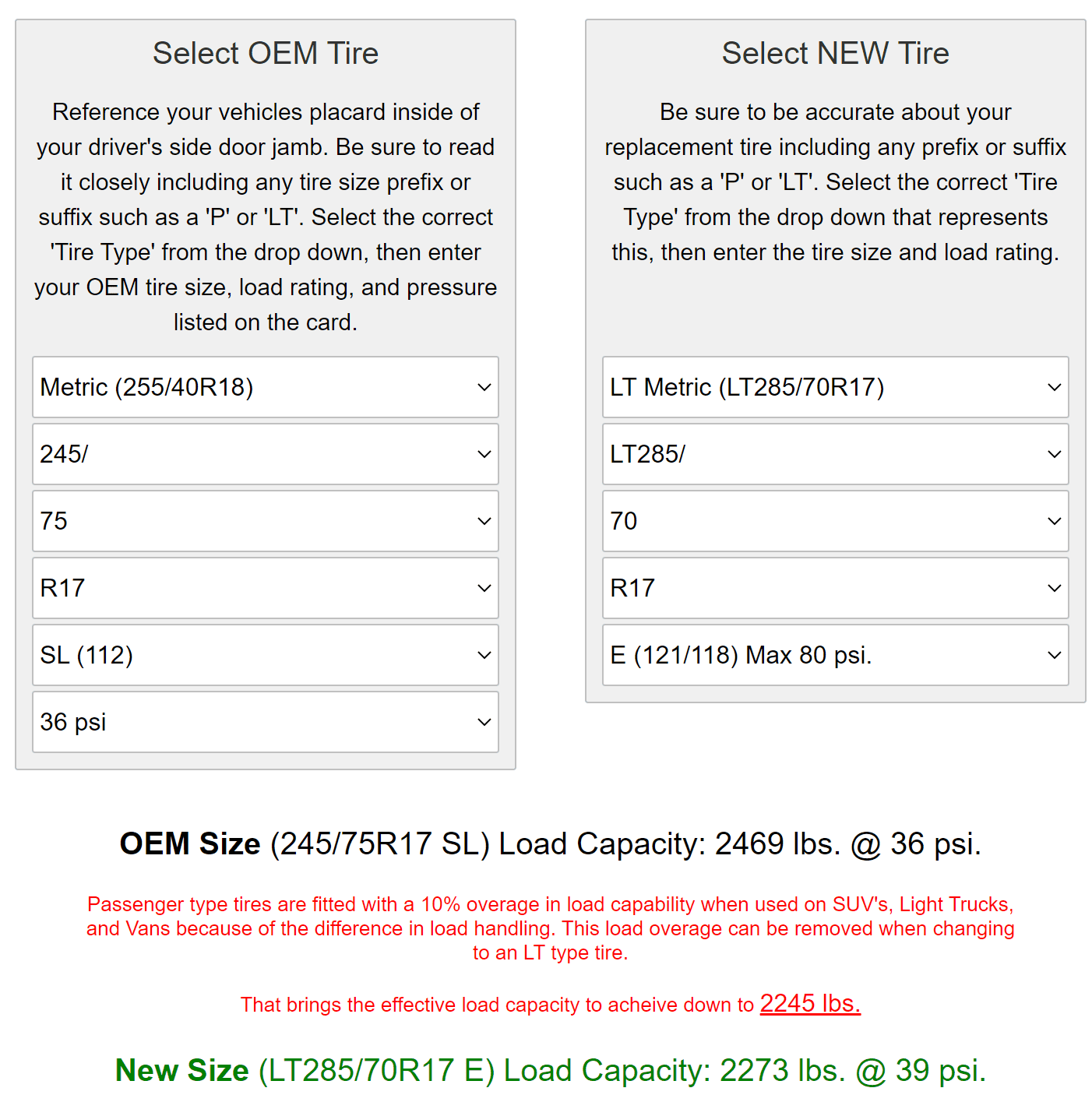

I've been using Tire Pressure Calculator (tiresize.com) to give me a better idea of the pressure I should be running in my KO2. I haven't done a chalk test yet, but I'm planning to do one to confirm. So based on that I've been running my KO2 at 39 psi. That is to achieve the same load capacity as the OEM Bridgestone Dueller that the Max Tow is equipped with from factory. I could likely run my tires lower when I'm not at capacity, either load wise or towing, hence why I need to do that chalk test. And of course I "air down" when I'm offroad, it makes a big difference comfort and traction wise.
Jeep Gladiator BFG KO2 LT285/70R/17 Tire Pressure (once and for all) Screenshot (3)
