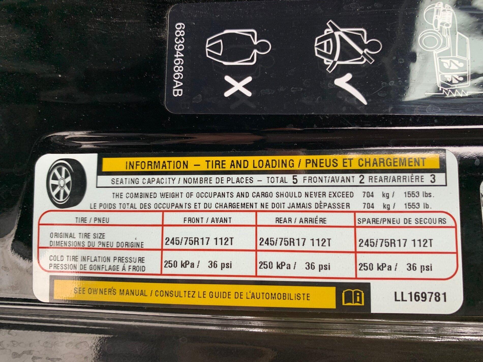

I must admit that I did not, however I'm using the numbers on the door sticker, which doesn't start with a P, so I assumed that it was Metric and not P-Metric.
Also, from what I can find on the Bridgestones website, the Dueller in that size is a Metric one, not P-Metric. I could be wrong, but I think I was correct in using the metric dropdown vs the P-metric one.
My mistake, I think you were correct that they are the regular metric! Took mine off and did not remember correctly it seems.
