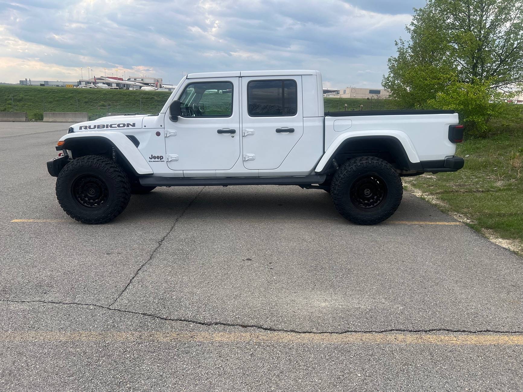

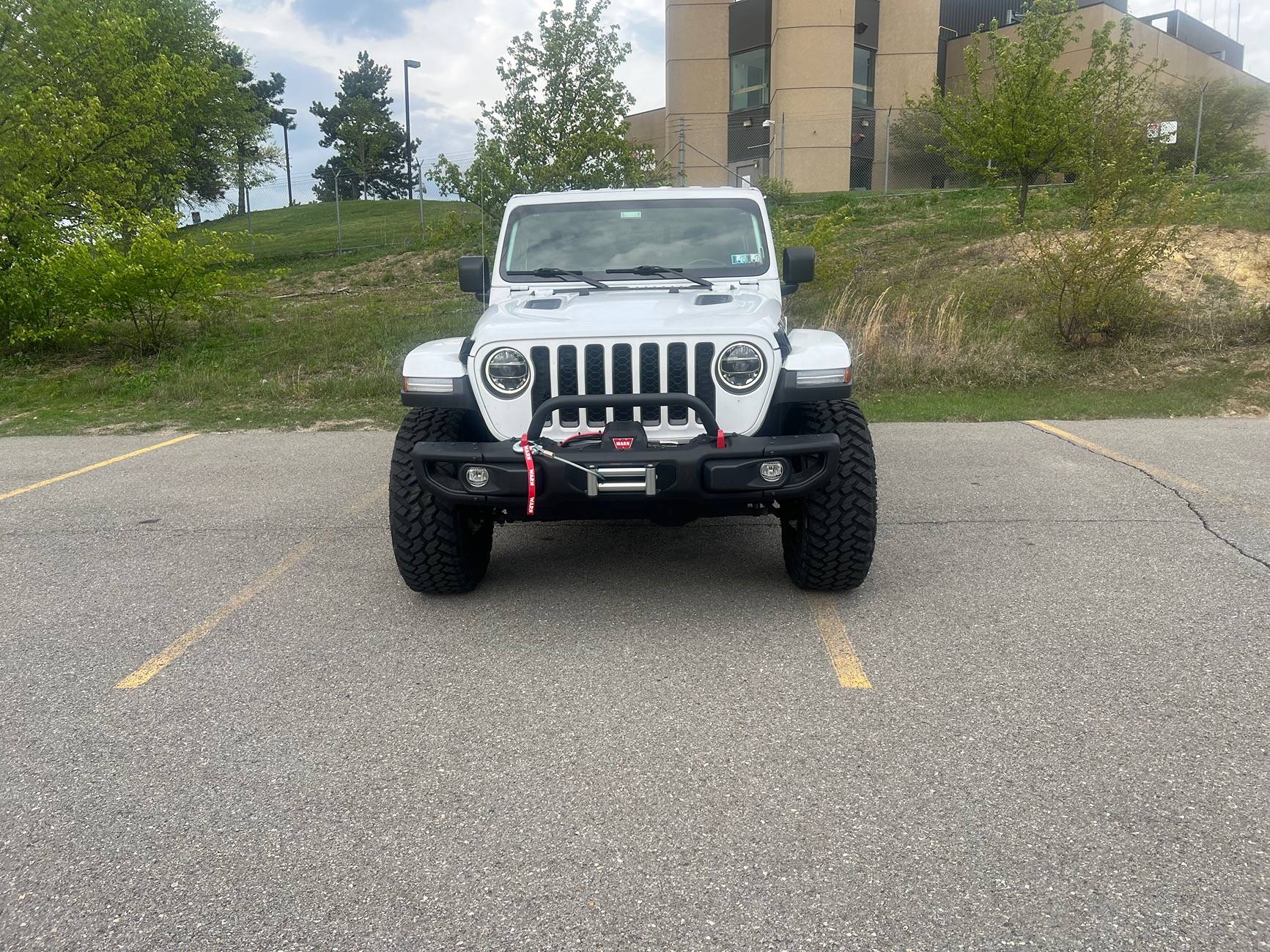

Pretty much what the title says.....Discount Tire says these won't fit my 2022 Mojave? Wanted to see if they could price match what I found elsewhere.
That’s what I have on my rubicon -18 off set with 35x12.5x17 NITTO trail grapplers with 2” mopar lift.
Jeep Gladiator Black Rhino Armory 17X9.5 - Discount Tire says no fit IMG_3945
Jeep Gladiator Black Rhino Armory 17X9.5 - Discount Tire says no fit IMG_3944
