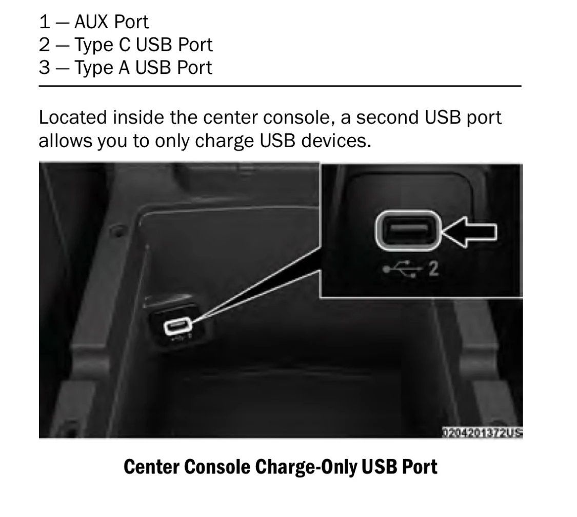

The center console is for charging only.

Not on my two Gladiators. Android Auto works through the USB port inside the center console.
I'll be honest, I can't speak to either of these because I have never plugged my phone into any of the USB ports.

Center console on mine works for android auto
Oddly, when I got a new phone the center console has issues but the media hub or whatever it's called by the radio worked fine with usb. I think the new phone maybe draws more power? No idea.
Regardless, a wireless android auto dongle plugged in the center console is a great option imo. Has been great for me for a few years now. Phone connects right to it via wifi. If you want to try this option get a dongle that shuts itself off when the radio is off so your phone doesn't keep trying to connect to it when you're not in the truck. There are threads on this already if you search wireless android auto
This is from the owners manual
Jeep Gladiator BLUETOOTH RANDOMLY DISCONNECTING AND DROPPING IMG_2462

Look above, see 1,2,3?
Yea I see that it just doesn't look like a type c in the photo. I suppose maybe mine has a 1 on it then I'll have to check. After i unplug the fully functional AA wireless dongle that's plugged in and definitely working 😎
