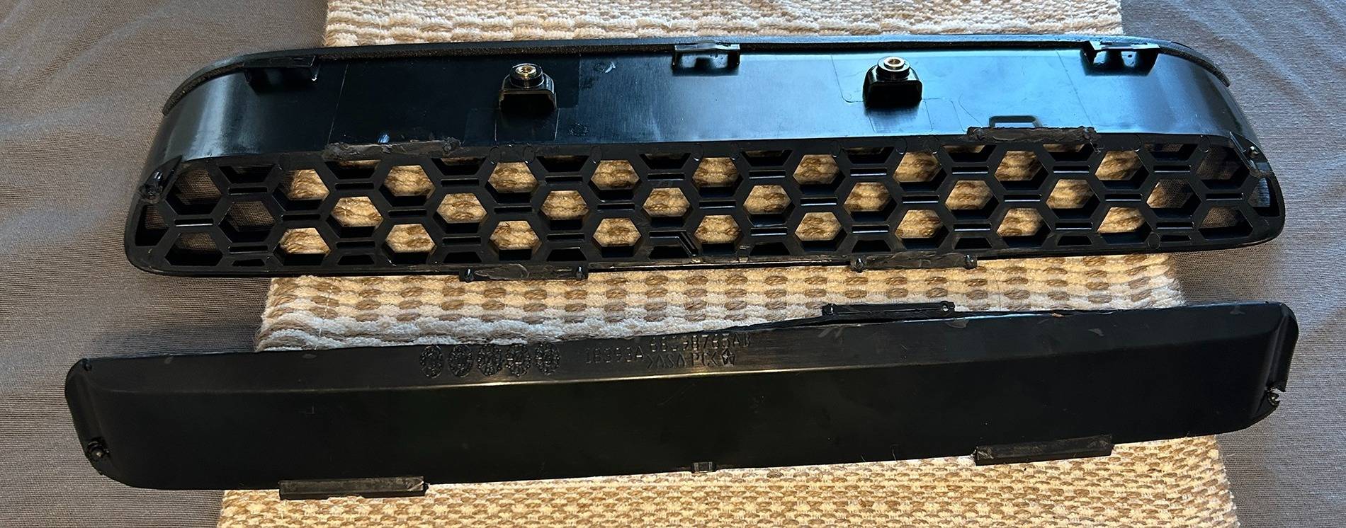

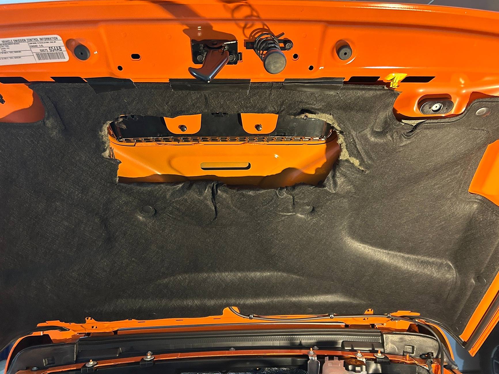

At first I was going to use the Rubicon 392 hood bezel then learned that the Mojave scoop is a 2 piece design. I removed 2 pins holding the front of the hood insulation to drop it somewhat. Then I removed the 2- 10mm bolts holding the scoop to the hood and unclipped 3 clips in the front of the scoop tilt it back out of the hood. Then I pried the back side of the scoop so that it would flow air.
I had to experiment with how much to cut out of the insultation. Measuring 3" from the front of the pad I cut a 19"x8" section of the pad. The pad doesn't cut very well and tends to tear easily I've seen some people just leave the pad off.

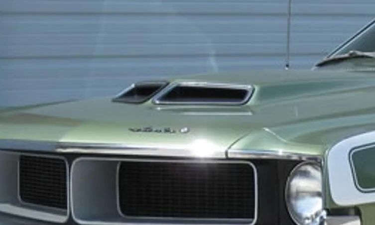

At first I thought you meant functional as in it shoved air into the air box........... in this case, tromp the throttle and it operates a vacuum motor that opens a flapper to let air into the open-top air cleaner-
Jeep Gladiator Bought a JOOSE Mojave 1753829082563-9x
That would be cool to rig up a way, but then, the air box is all wrong for such a thing on the 3.6

I did something similar on my 2020 Rubicon when I installed the S&B intake scoops and had to cut the hood liner. Used HVAC insulation duct tape to cover and wrap over the cut liner material to keep it from getting frayed.
Not that fancy it's ventilation for under the hood like the 2019+ Challenger Scat Pack hood which is the 1st gen Hellcat hood. My JL Rubicon hood is functional too and is great at ventilating heat out.
