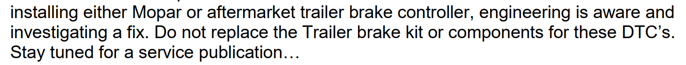

With some older Gladiators, the ABS goes crazy and lights up the dash when the Brake Controller is manually activated. There is a TSB for a software flash to fix it, for those that need it. The aftermarket resolution was a diode in the line on the Gladiator versions of the harness. This was one of the reasons for the original delay in the release of the Mopar Brake Controller (waiting for the software fix).
I bought one of the other harnesses without a diode to try and get the problem to show so they would perform the TSB. It worked without the ABS issue, so I just left it installed. I have the harness with a diode sitting in a box in case I need it.

Cutoff date for the ABS update is January 2020 so it's only needed if the JT was built sometimes in January 2020 or earlier. A really small group in reality. Any 2020 after January 2020, and any subsequent model year won't need any changes.
The controller came out months after January.
The instructions for the kit are dated late February 2020, but the controller itself wasn't released until months later.
The fix came well after the release of the controller. I worked with a dealer to report it to STAR - and STAR team had never heard of the issue and had no record of it.
The tech I worked with spoke directly with STAR and gave them details - the codes and so on so they could even look it up.
It wasn't until November that they said "gee, we realize there's a problem........."
This was released in november 2020 so it was still broken after the trailer brake controller was released..
