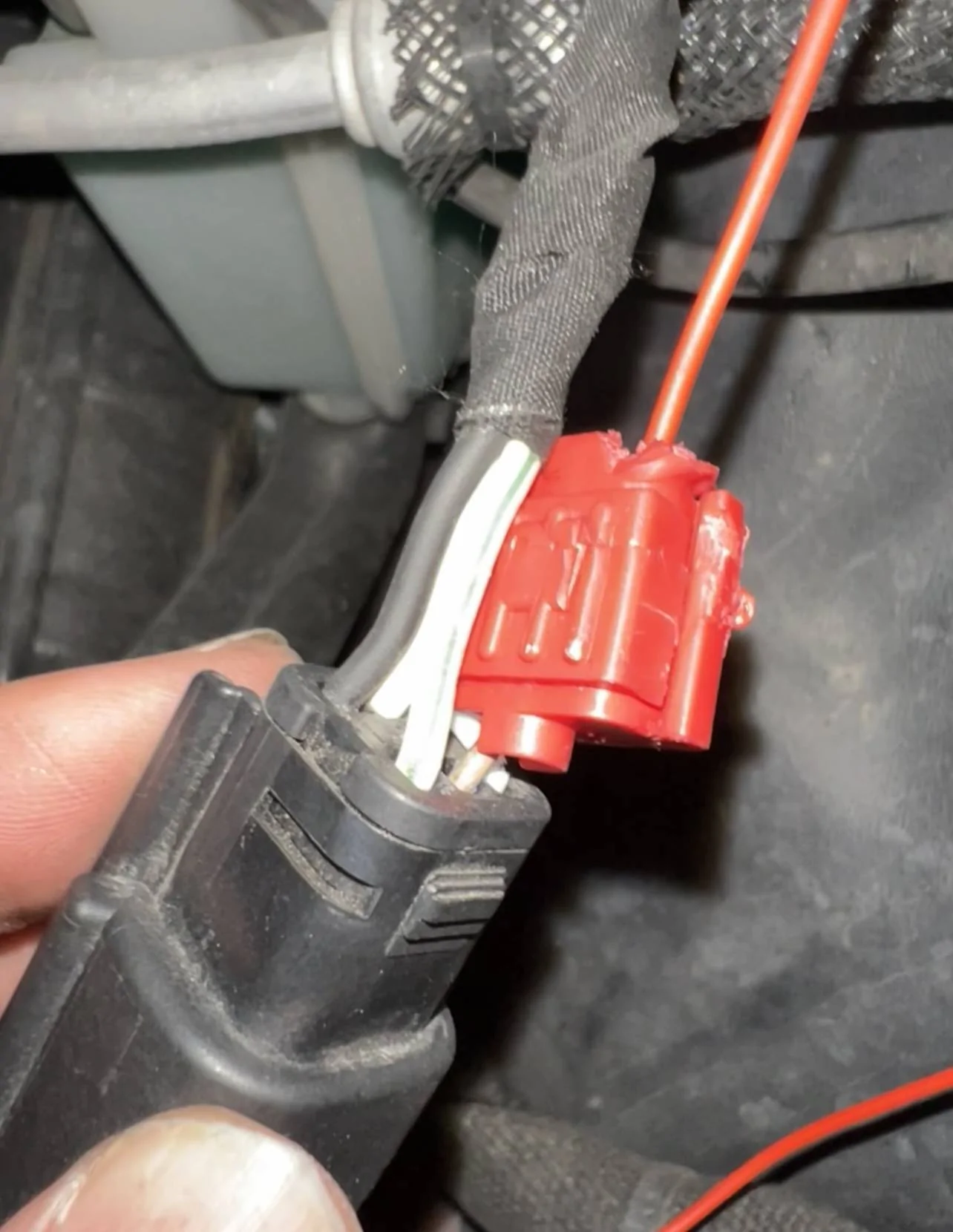

I see you have the Max Tow too. Mine is a ā€˜21 model which I remember reading somewhere on this forum might be important for this (not sure though). ā€˜21 Model Year has a designated signature lighting wire on the headlight harness (see image below). Don’t bother tapping the DRLs if you have the same model year as me. It won’t work.
I tapped main headlight harness (signature lighting wire) and used my JScan to make sure ā€œSignature Lightingā€ was enabled. However I think I remember it working even before messing with the JScan anyway.
I meant to go back and wire it with a more permanent setup instead of this vampire clip, but it has worked fine over the last couple years.
Existing harness red wire tap and provided red wire from LOYO (I’m color blind just fyi, but this is the setup that worked for me. I’m also just now remembering from this old picture that I never taped this up lmao).
Many thanks. I ended up using one of the auxiliary circuits but nice to know that there's an alternative in case I need that for something else later.
