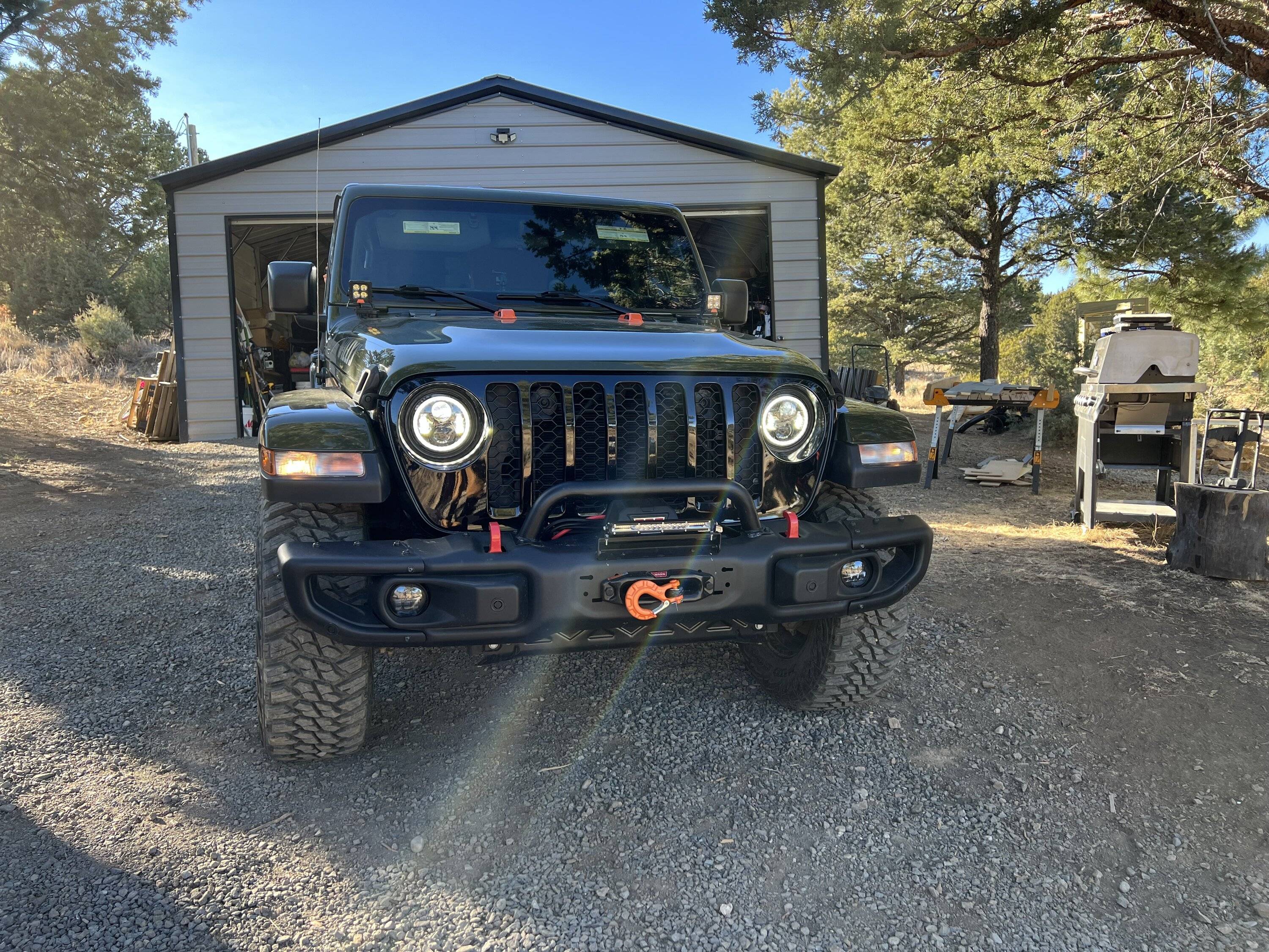

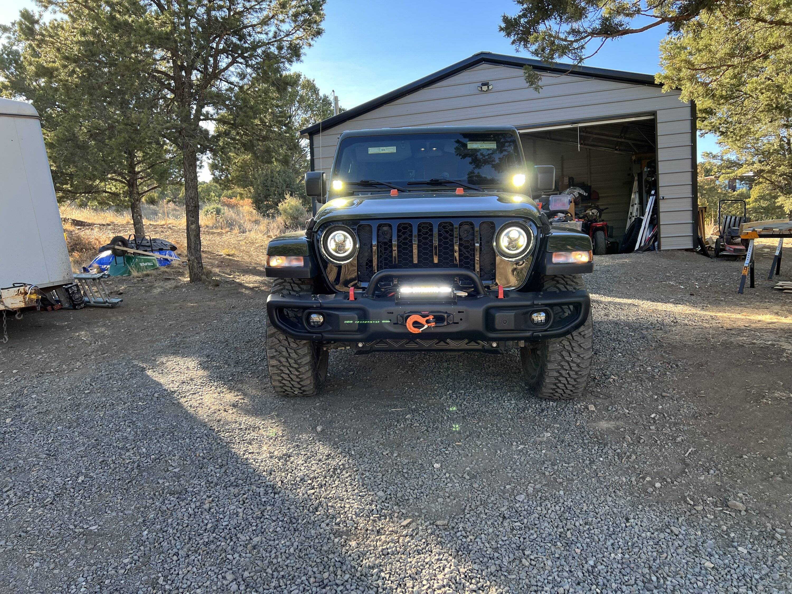

Got the headlights installed. Pretty simple install. Followed Amazon instructions from the vendor and turns out the leads going out for the DRLs were inverted. They turned amber. Fixed after I swapped the leads. Now they turn white. Still have to aim the lights and change to LED with JSCAN. Just need the steps to do that. Also went ahead and installed the led bar over the winch.

Forgot to mention that the Audexen ring adapters even with rubber gasket left a big gap with the grill. I remedied that with three washers on each bolt. I still need to aim the lights and figure out what is the correct beam pattern. I do have a question. How soon will the Jeep take to notice the LEDS and start giving error messages like lights out or flickering? I haven't had any of that even during a 30 minute drive last night and 20 this morning. Wondering if the previous owner had made changes. I'm suspecting this JT had aftermarkets lights since the OEM halogens seemed like they had been removed before as the harness push retainers were hanging.

Got the headlights aimed/dialed in about 90%. I'm sure I can fine tune them but I need to find a level place with a wall so I can do it. Drove around the usual roads which are pretty dark and I'm pleasantly surprised at the difference compared with the halogens. The cutoff isn't the sharpest (better aiming) but I can now see when driving our dark roads. For now I am satisfied but I can't say anything about longevity. If they last a year or two in I'm fine with that as I paid less than $60 for the pair. If all of the sudden they both fail at the same time, I still have the spot lights and light bar so I'm not concerned. It rained today so I'll check tomorrow for any condensation and report back.
