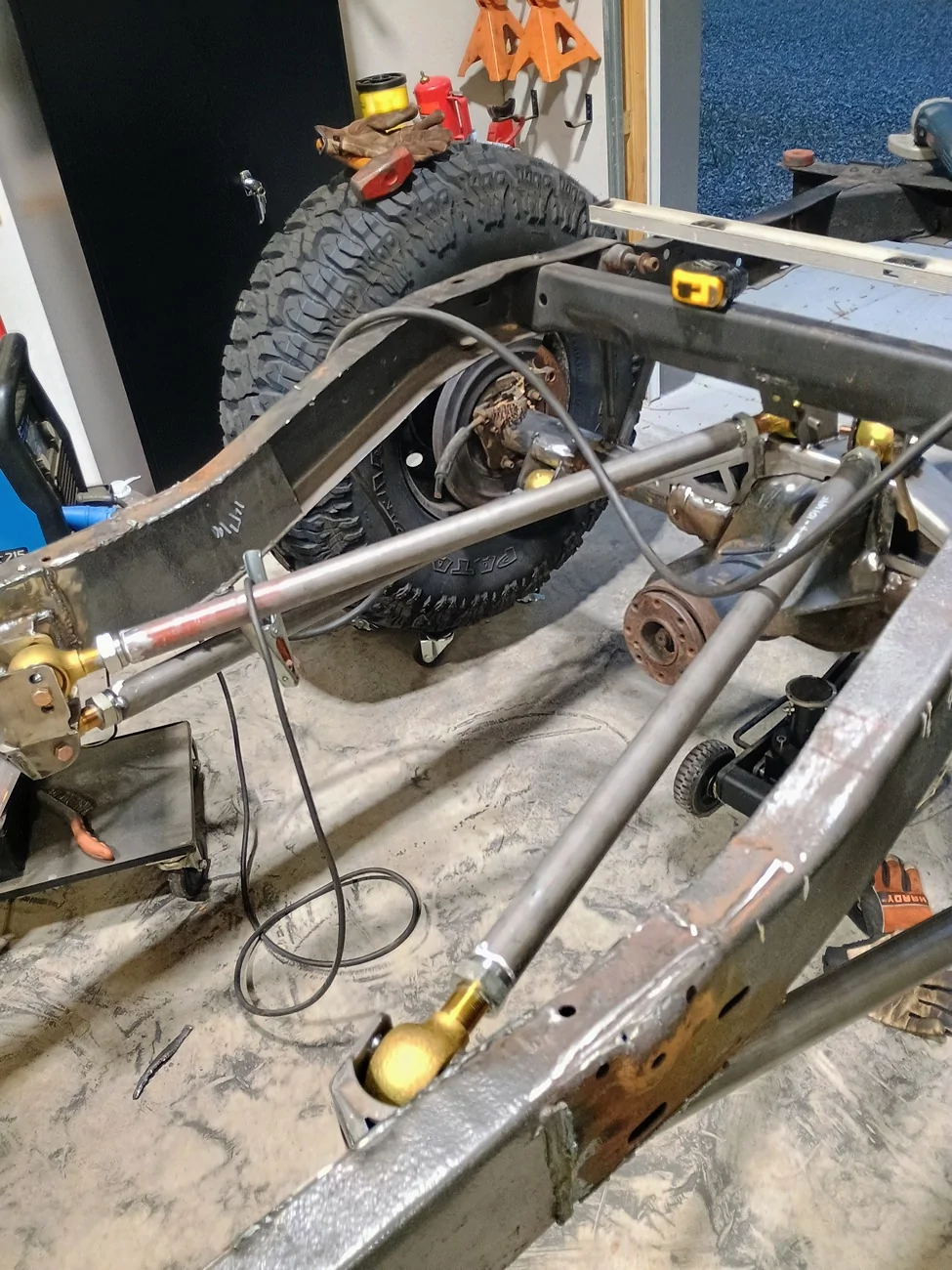

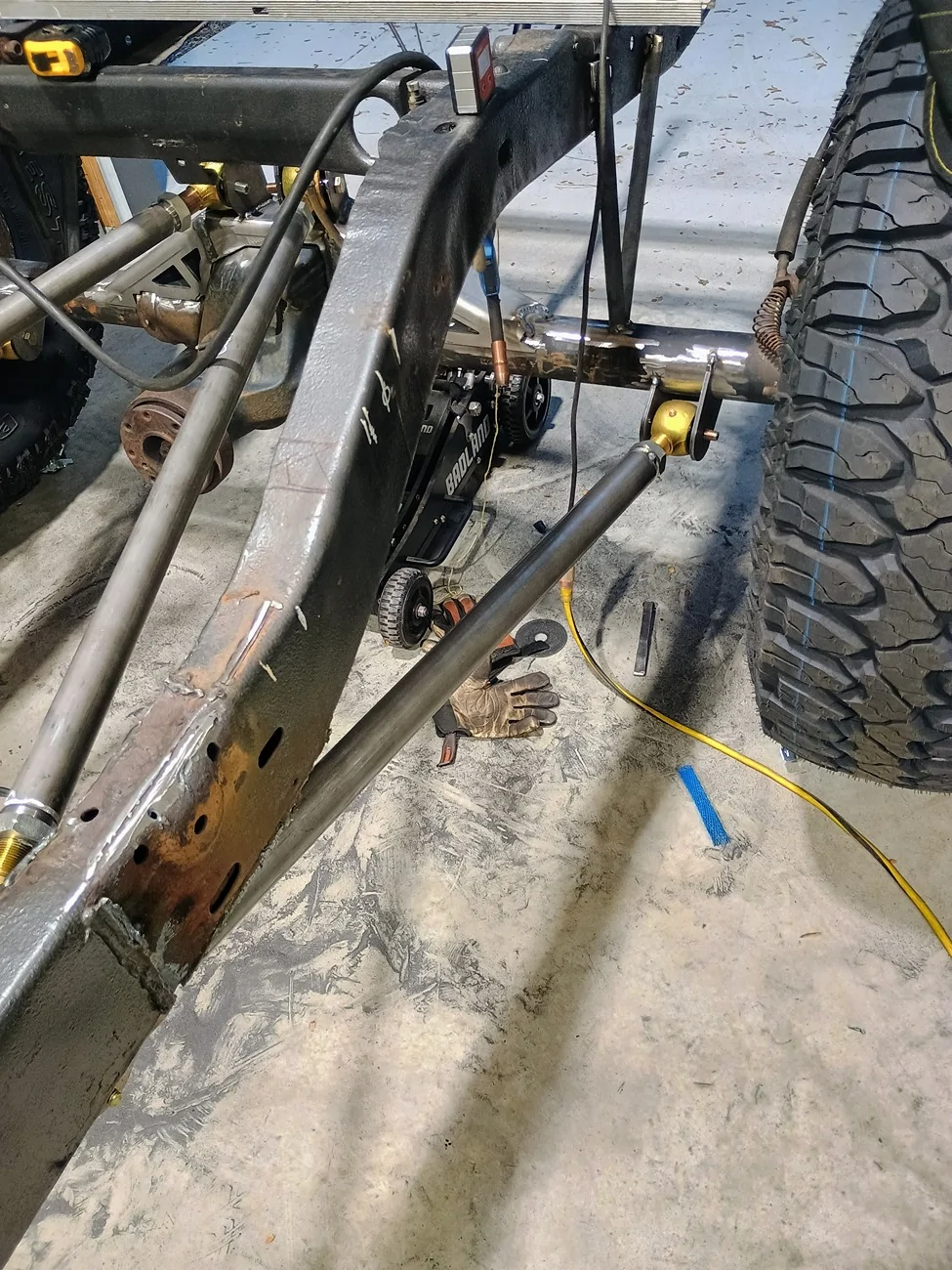

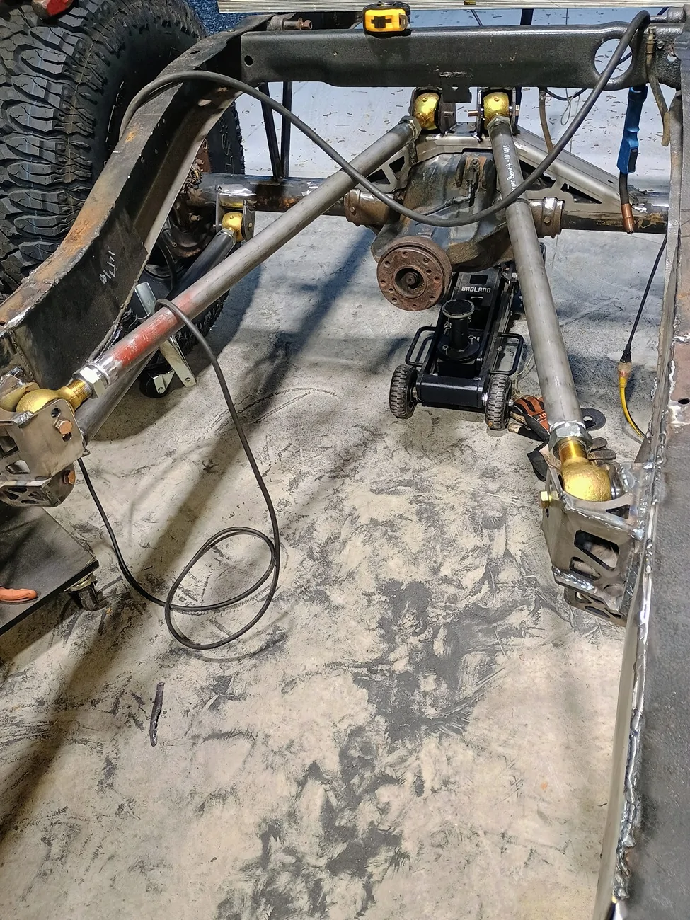

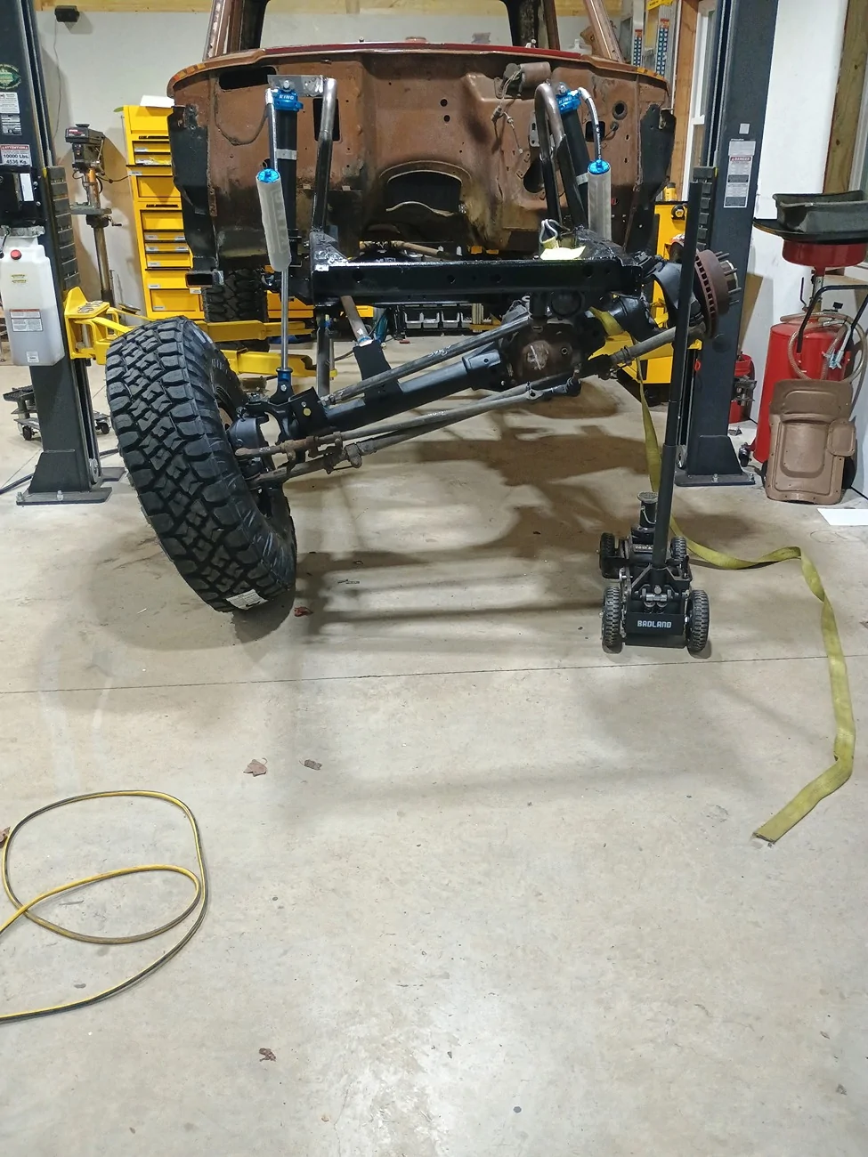

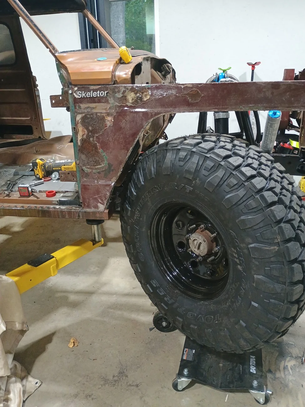

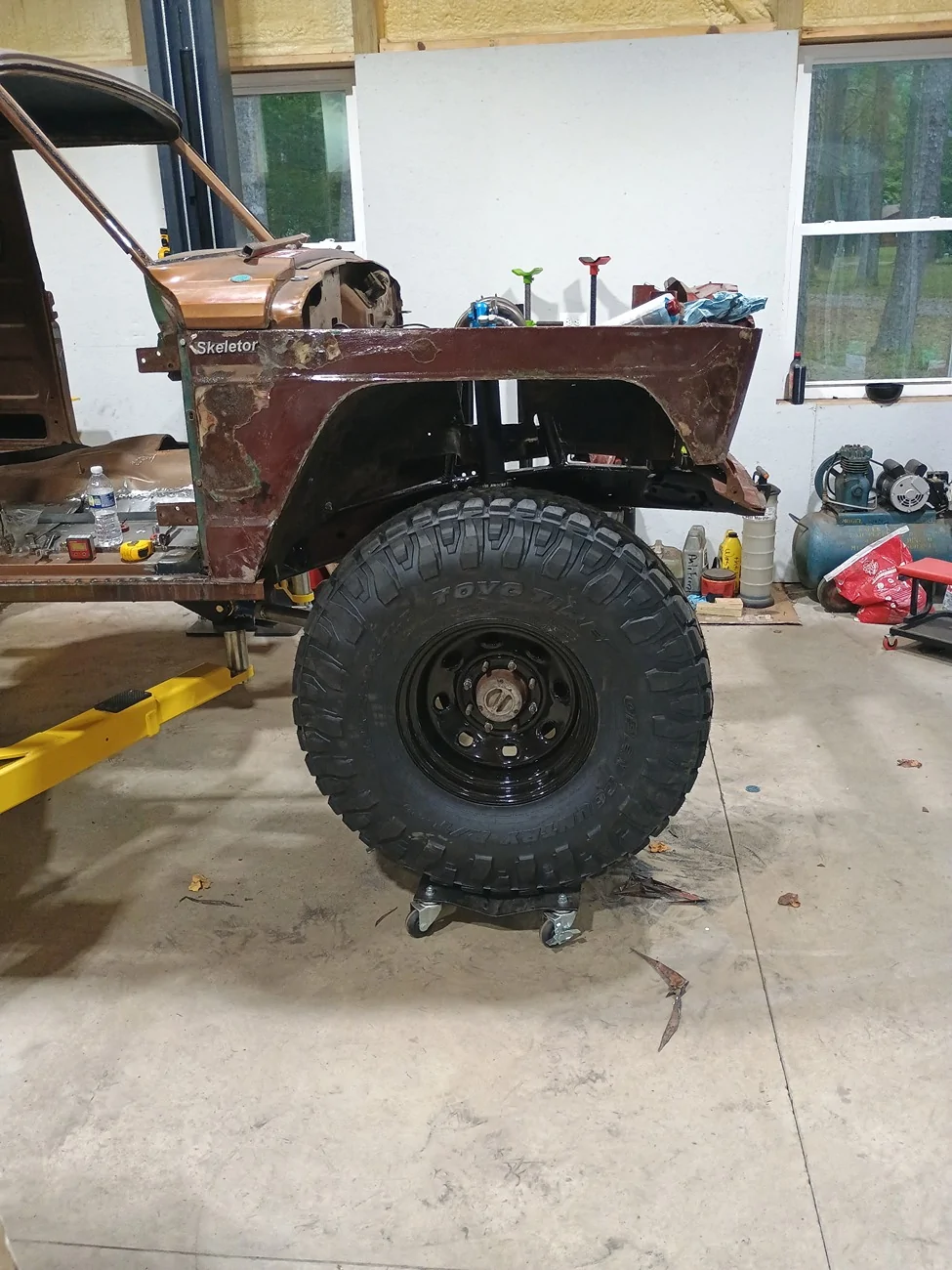

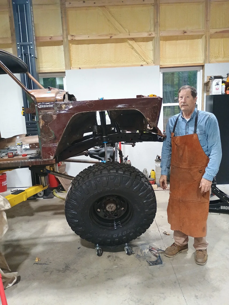

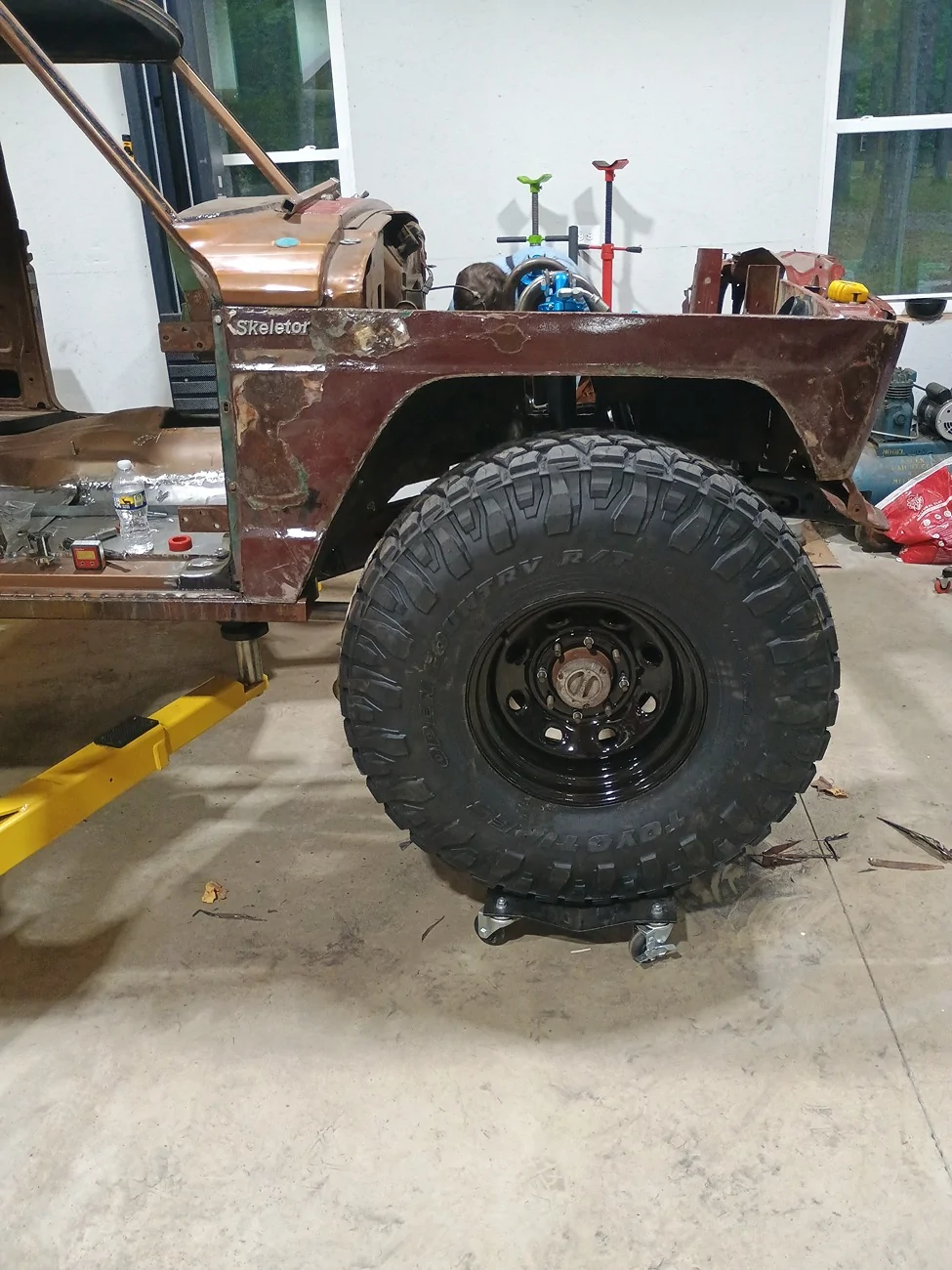

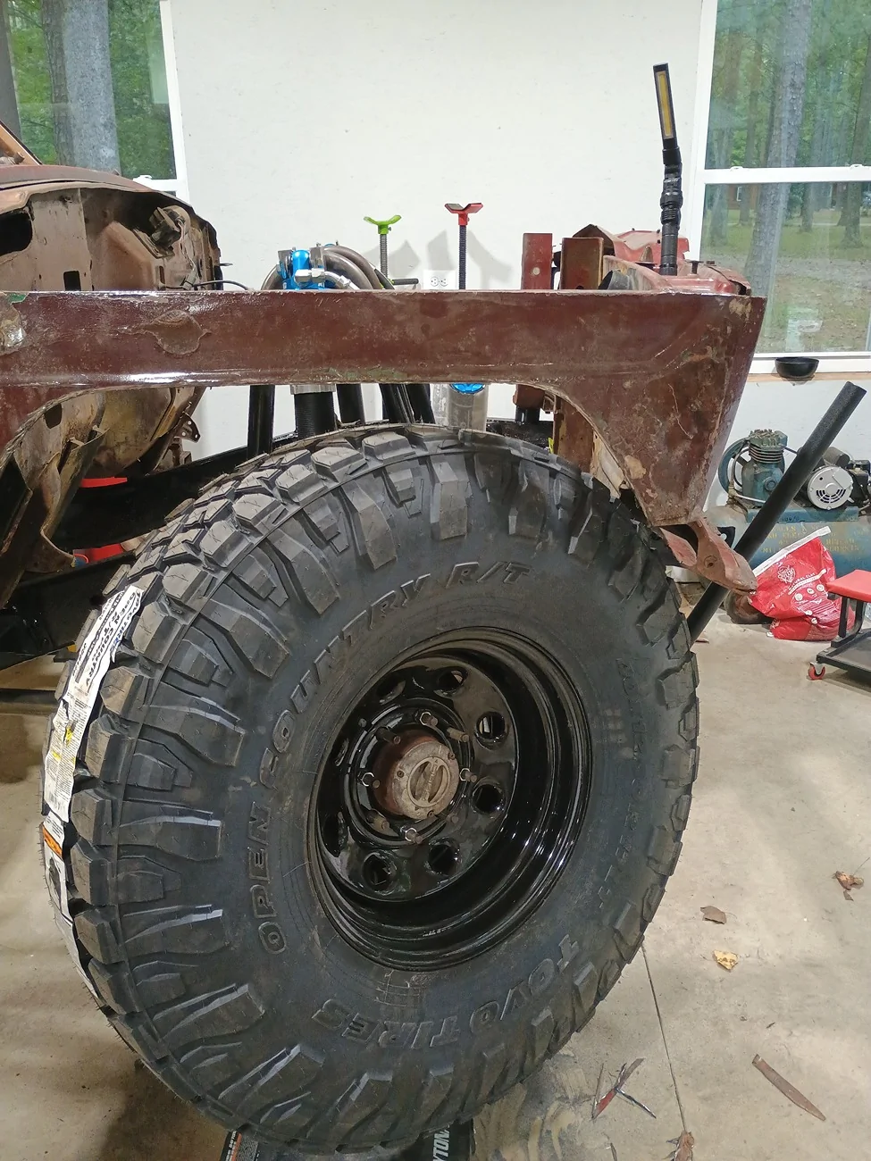

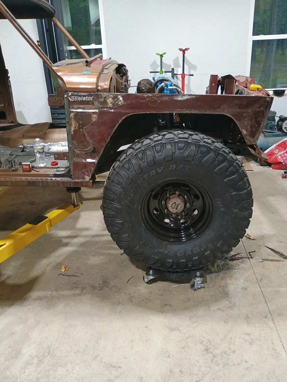

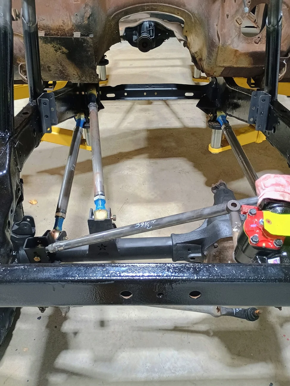

Been a minute since posting anything here. Just finished the suspension and cycled to determine clearance. Little recap.
Triangulated 4 link rear 6 inch up trave 8 down. 14 inch 2.5 King Coil overs.
Three link Front 6 up and 8 down.
Axles Super duty 2008 D60 front and 10.5 rear.
Tires Toyo Open County RT Por 40x12.50 x17.
Just finished cycling the suspension with the tires on. It is impressive how much travel you can get with the right design. Biggest challenge is how much to cut off the bodywork to make this all work. Surprisingly not a whole lot.
Front fenders, the metal flare was removed and looking at how to widen it and section the center to fit the bigger opening. Yes the owner wants to retain the OEM look here. Section the fenders is going to be a lot of work and add to that widening them by about 2 inches.
Cab... The narrower Toyos fit rather well in the space provided. No cab interference with the axle pushed forward about 2.0 inches. The core support needed a bit of trimming. At full stuff and hard lock a small wedge needed to be cut from the core support. about 8 inches in and 4 inches up. WE were both very surprised at how little trimming needed to be done.

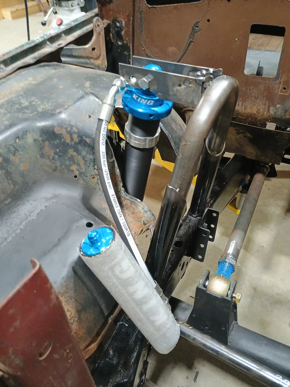

Fabricating new upper front shock mounts. Had to move the top outboard to clear the frame.
Enjoy
