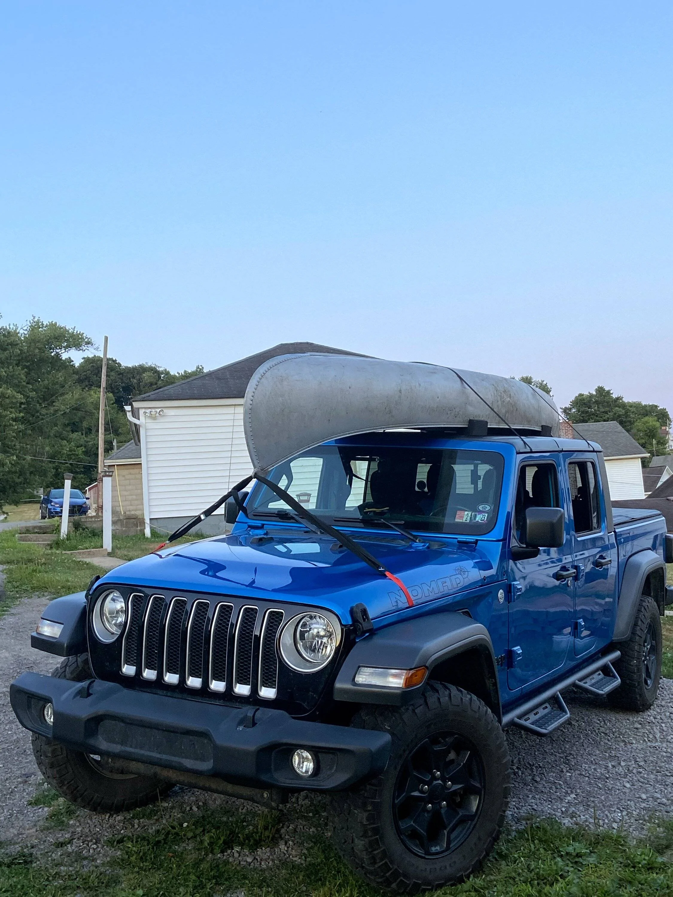

The Willys bumper is different than the Sport/Sport S, which is the one that comes with the damn dams.
Jeep Gladiator Bumper closeout panel airdams Snapseed
The one on the Willys is the same as the Overland/Rubicon/Mojave unless upgraded to the steel for the latter 2.
If you look at the silver accent parts around the fog lights on an Overland trim, you’ll find that portion is elongated compared to a Sport. On Willys, Rubicon, and Mojave that silver accent is black.
