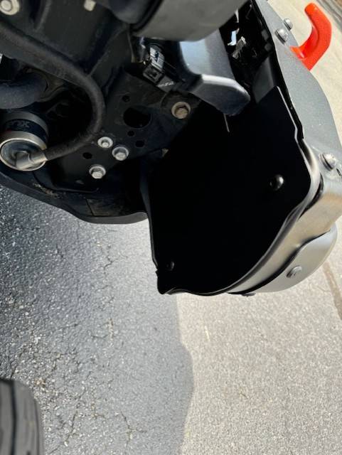

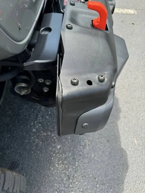

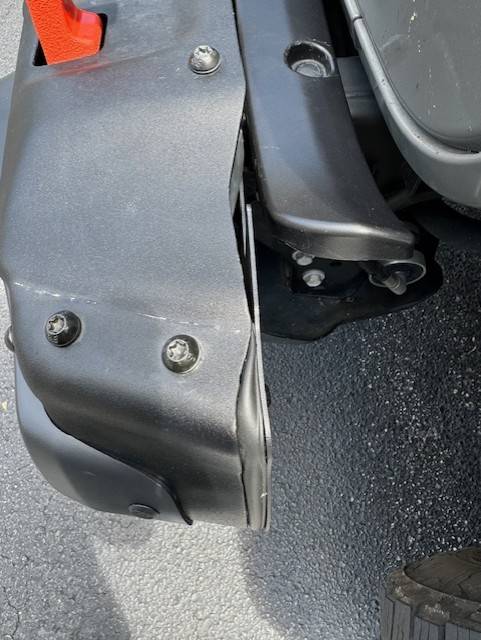

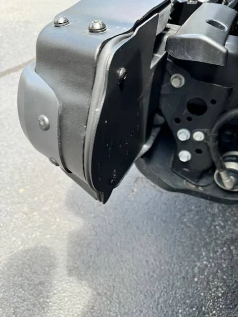

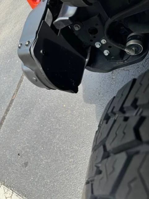

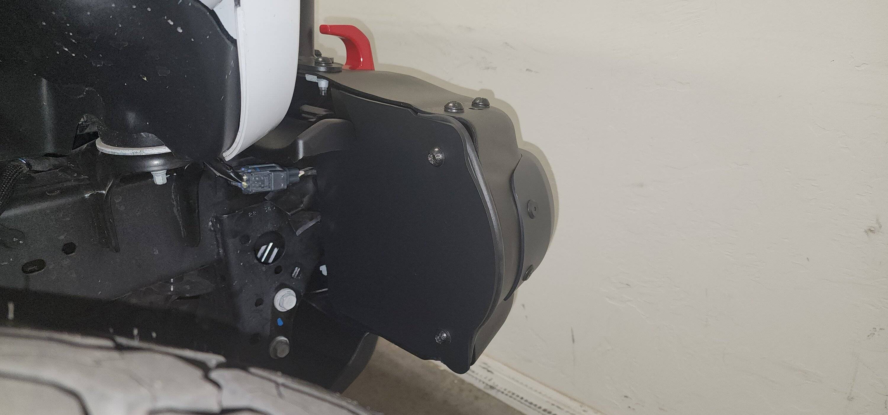

I came across these just recently and I really have no complaints after my install. They're not perfect but they do their job to keep out debris and mud. I did have to make small adjustments by bending the plate away from the light connector on the inside. The adjustment was very minimal and only enough to eliminate any contact of the plate against the rear of the connector but without compromising any seal on the edges. Due to the bend, I created a small gap at the top but my OCD meter doesn't ping hard enough for me to go back and bend that edge in.
The weather seal itself isn't the greatest to work with as you have to follow the shape of the outer edge and the glue strip on the seal itself could be better. However, that's an easy fix by applying a bead of silicone or permatex to the underside of the seal for better adhesiveness.
I live in Georgia and during deer season you'll find me in the woods a lot and if your familiar, you know that the mud and clay can be unforgiving and a pain in @ss to clean out.
I think Utah Design did great with this design considering what they're meant for. I didn't buy them for aesthetics because they're on the backside of the front bumper and unless you're looking for them, no one would notice that they're installed. If aesthetic is your aim, then you might miss the mark but I don't see why. The plate itself is a powder coated metal rather than plastic and looks like it was designed with durability in mind.

I'd be very curious, after a year, if you pull those off, what's up inside the bumper...........
As a long-time fixer and restorer of cars, I'd be interested in seeing what's between the plate and bumper after 12-18 months.
Being that it’s 2 bolts, I can see myself easily taking it off and checking often it to see if there’s any buildup. I know all too well what can happen when road debris grime and debris pile up in small corners of metal.
The good thing it’s not completely closed off and because and there’s room for debris and water to run out which helps.

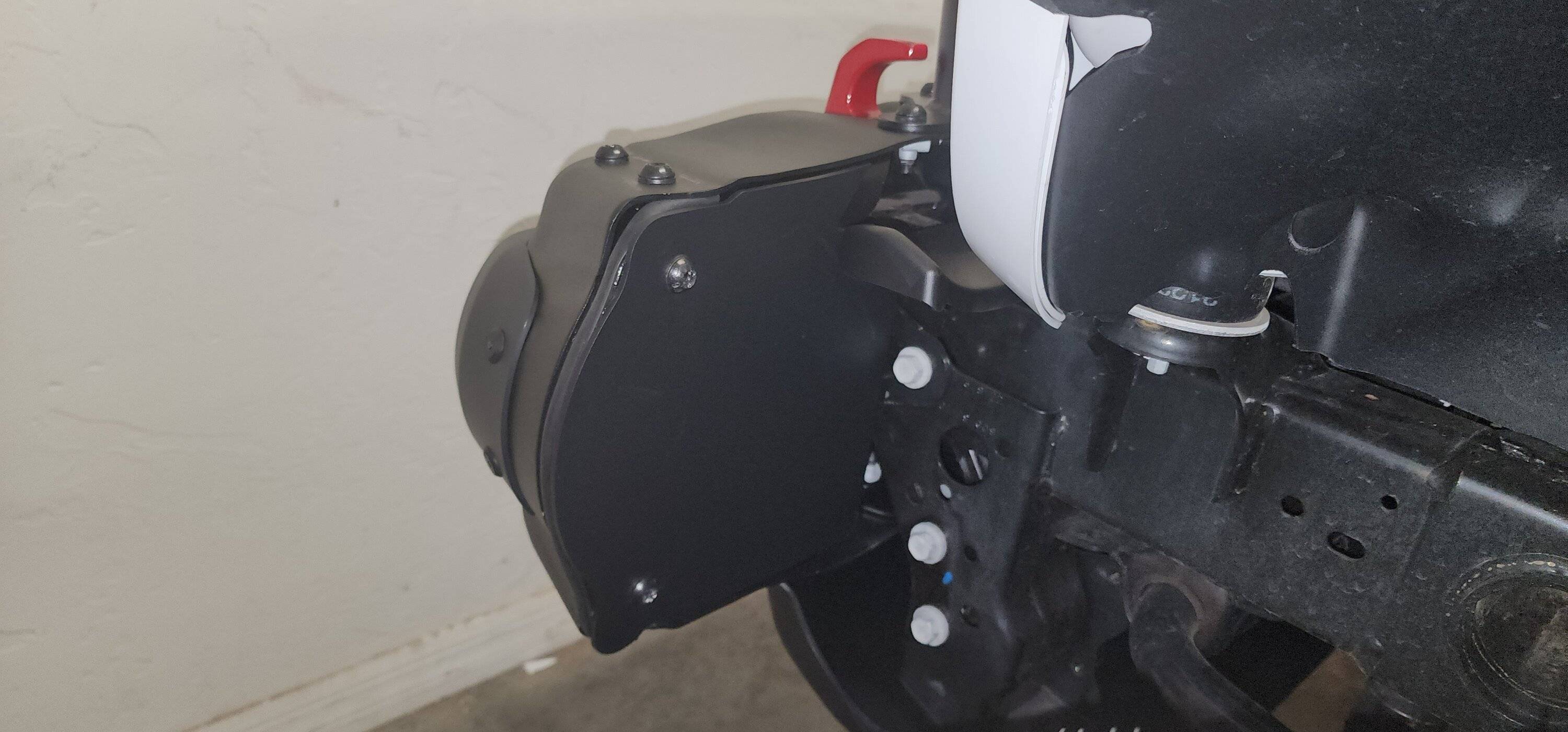

If anyone wants to give it a shot at making your own, here’s what I came up with. It’s pretty easy and should give you a head start to speed things up.

So you can’t use the Utah close plates with the end pieces installed?
250
40,624
54,314
Correct. Frankly, I've decided they'd trap more salt and sand that can't easily be washed out so stopped trying to figure out how to tuse them.

I talked to the Utah design guy. He said they will work with the ends left on. He changed the description on their website. I'm going to give them a try. I already had a set on order and was going to cancel, but he said it will work.
