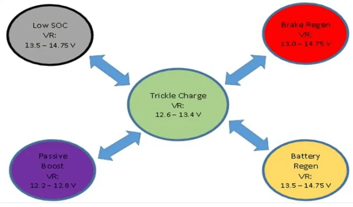

Thank you, I thought of something like that, but I am just an old school guy, and smart charging is too smart for my simple old mind.
As others have said, totally normal and a good thing. I reacted the same as you did when I first noticed it. I was going circles with the ESS and noticed the voltage changes. I modded the ESS and never looked back.
