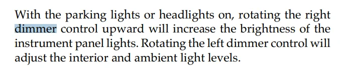

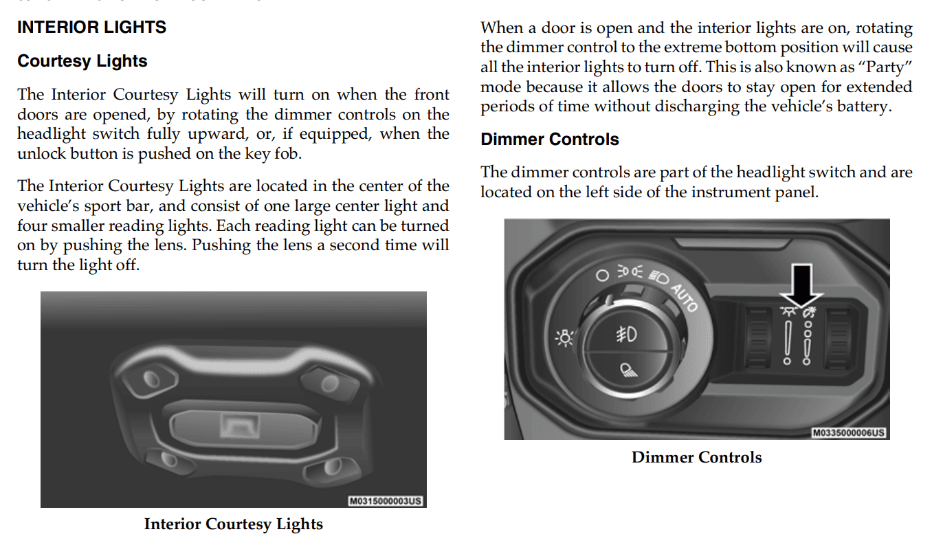

I finally learned by accident that the dial on the left ONLY works if the dial on the right isn't on the brightest setting.
248
40,500
54,073
So you didn't read the posts here? ;)
The light dial on the left is for the foot well lights, and it works in my JT. The one on the right is for the instrument panel. The left one only does something if the Headlights are on AND the other dimmer switch isn't set to maximum brightness.
Or do you mean you discovered that days or weeks or months ago?
I'm not sure if the book says that part or not - I didn't read it in great detail, just enough to get the info I wanted since I don't normally run that other dial at max anyway...

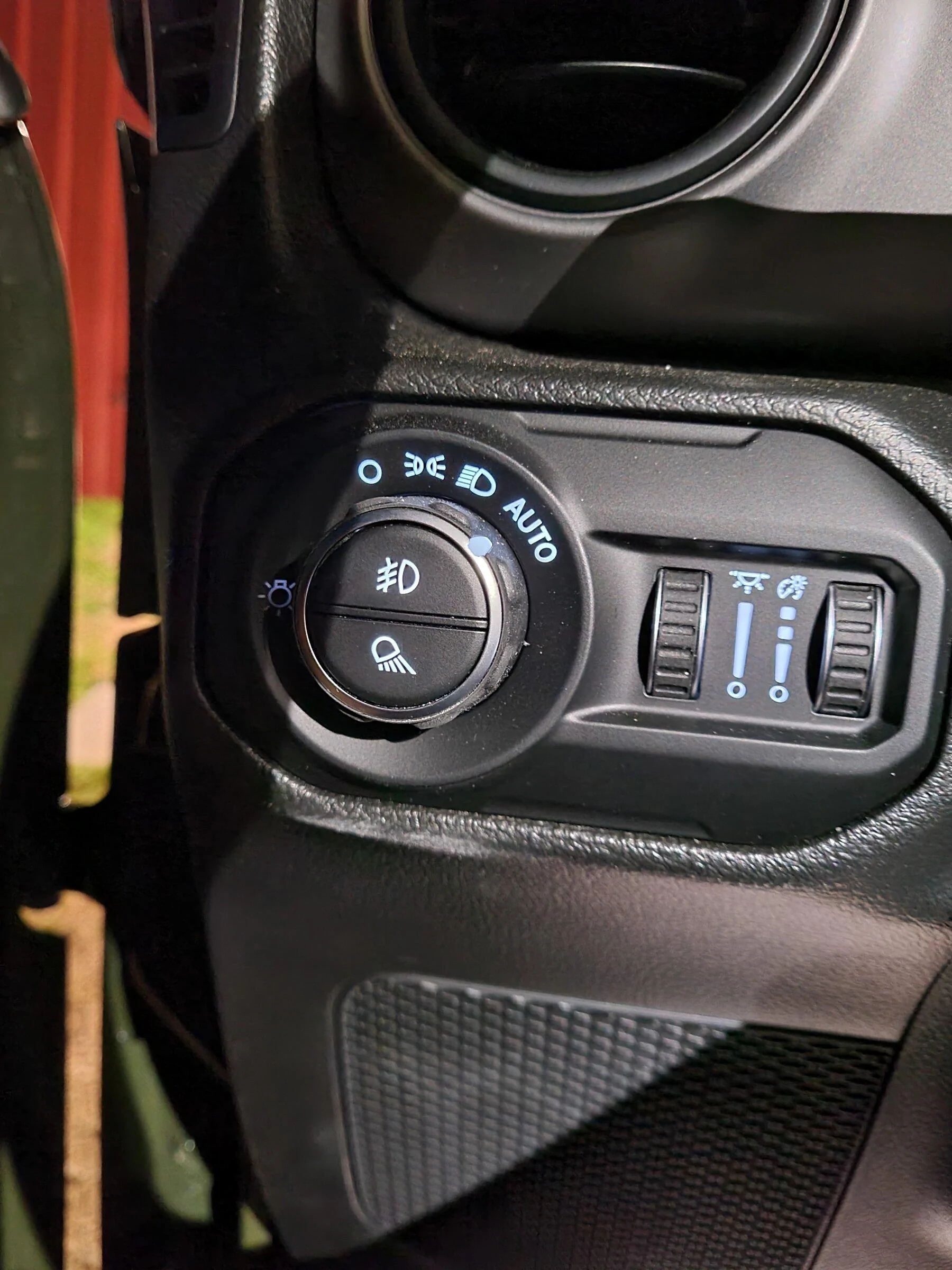

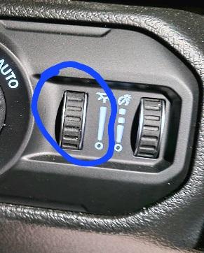

So yes, I read the owners manual and know that the dial on the left is supposed to dim lights below the dash. But, when I turn it I don't see anything in the interior changing. The one on the right dims and brightens everything, including the cup holders. So what am I missing here?

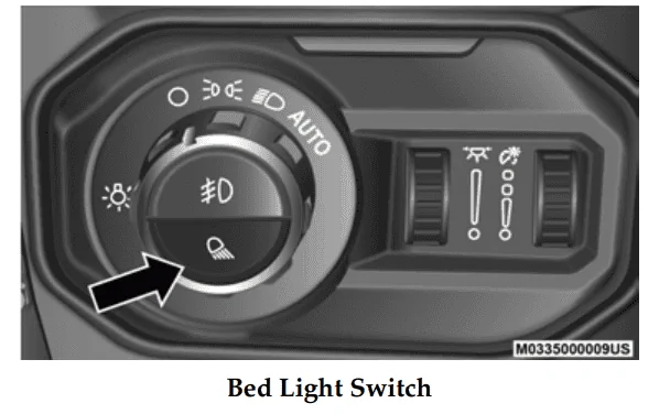

From my experience ('22 sport s) it does your bed lights if you don't have any of the interior lights.
jsalbre
Jeremy
Mar 17, 2021
676
812
Idaho
‘21 Sarge Mojave, ‘21 VW Tiguan SEL-P RLine
Security Engineer, First Sergeant
If that dial affects your bed lights then someone has messed with some wiring in your truck.
Best check it out again............
Those two dials are dimmers and not associated with the bed lights. That would require totally different wiring harnesses for each model of Gladiator and make no sense as far as - why would one DIM the bed lights?
