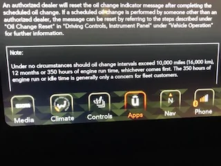

Hi everyone, I have been around CJs and JKs, but I am new to the JL/JT World. I have a small CJ business and have concerns about Jeep looking for ways to not honor their extended servcie contracts. On the Jks, it is simple to view the engine hours. I would document total engine hours at every oil change. I just assumed I should do this with JT since it is mentioned in the maintenance section of the owners manual. Thanks for everyones input. George

I'm curious in the data, just because I'm curious... but the manual does say "The 350 hours of engine run or idle time is generally only a concern for fleet customers."

I'm pretty sure the oil life is a combination of driving conditions including that 10,000 miles or 350 hrs. hell in another thread a forum member named 'The Office' idled so much he deduced that every 8 hrs of idle you loose 4% of your oil life. That would prove that the 350 hrs engine run time is definitely being utilized for the Oil life indicator. Basically change the oil when you want to but If you are worried about going over 350 hrs don't be, the jeep will let you know.
