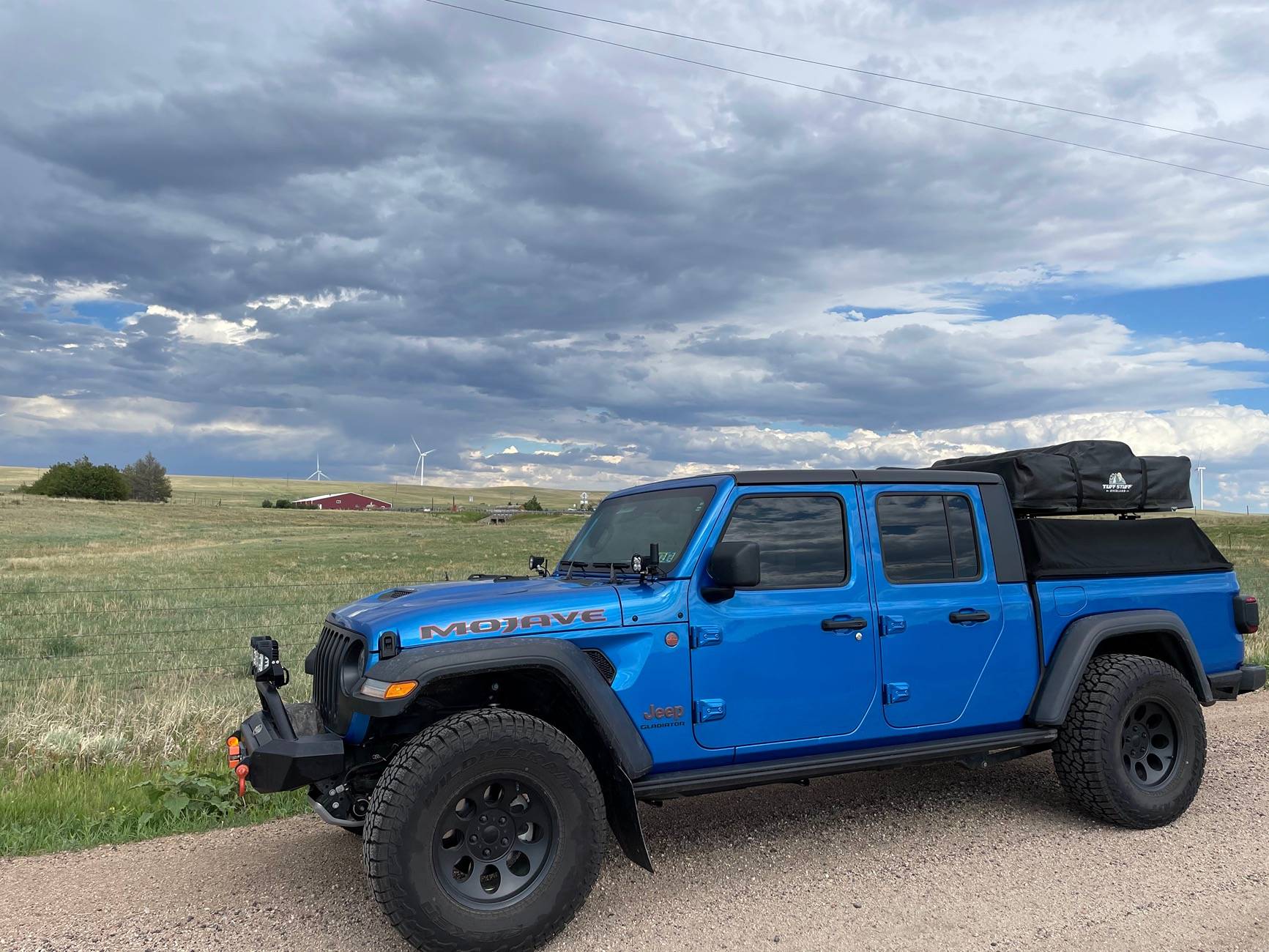

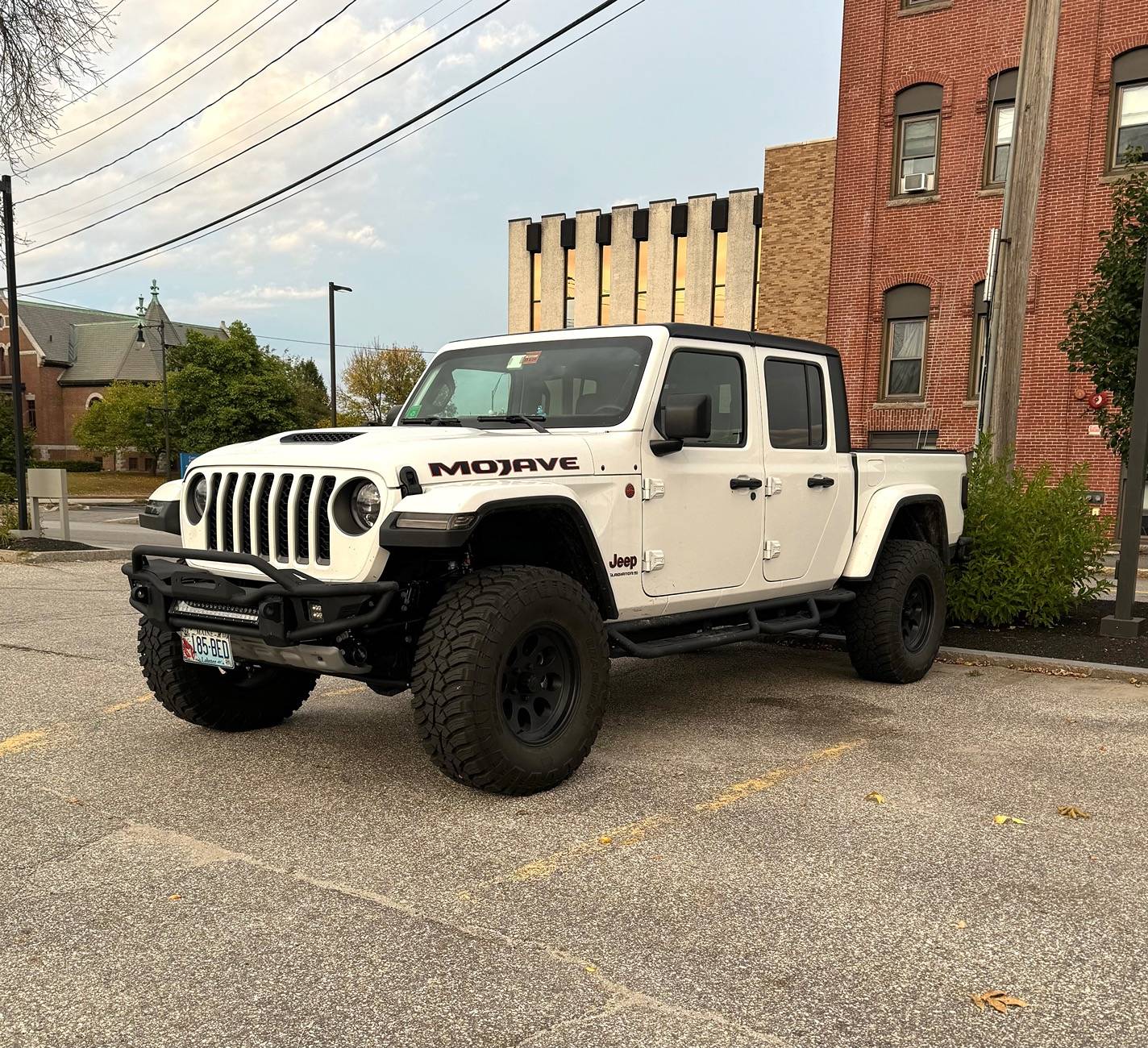

AEV 2” spacer lift with geometry correction brackets, Teraflex front track bar, 37’s & re-geared to 488s and added a front elocker

So, to clarify this thread, when you get a Mojave-specific lift, it basically means it can accommodate the larger lower shock bolt up front - if that component is included in the kit.
as for changing the ride, the Mojave fox shocks are internally bypassed; if you stretch the shock with a lift, you'll put the ride height of the shock beyond the first or even the second valve - so you'll be riding on a stiffer shock.
https://www.jeepgladiatorforum.com/...-shock-length-when-sprung.87652/#post-1411560
"The front shocks are 20.25" long at ride height (eye to eye). They are 15.75" when compressed, 23.75" when extended. That 8" of total travel is divided between 4.5" of compression and 3.5" of extension when traveling away from the ride height length.
The rear shocks are 22.25" at ride height, 25.75" extended, 17.75" compressed, also with 8" of travel."
Your experience may differ, but from a technical and mechanical perspective, if you don’t address the shock length when you lift, you are putting the shock in a configuration that creates a stiffer ride.
