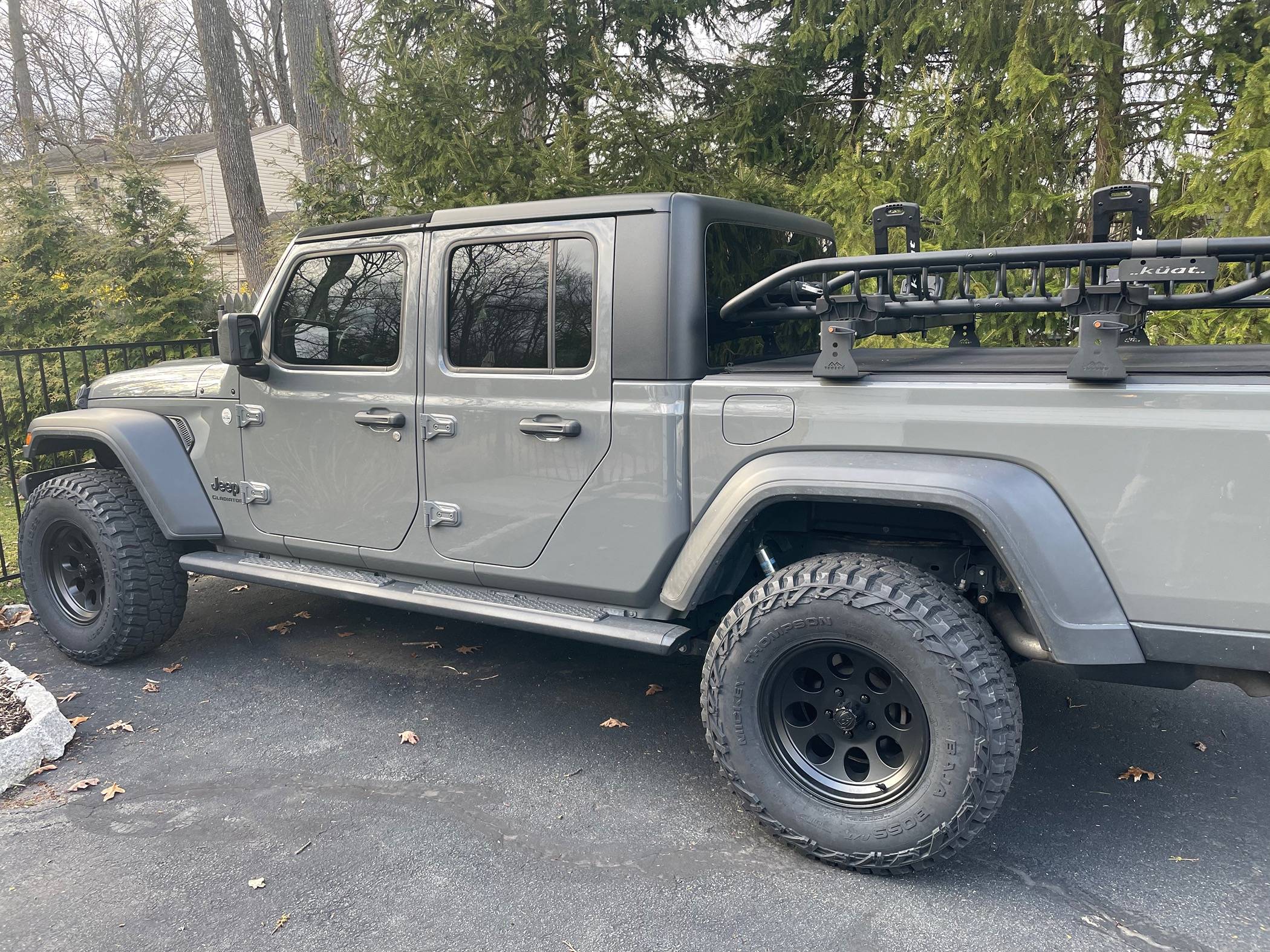

With the aev 2" lift, the mojave looks better on 37s in my opinion. Very happy with the kit so far.

1.5" wheel spacers.

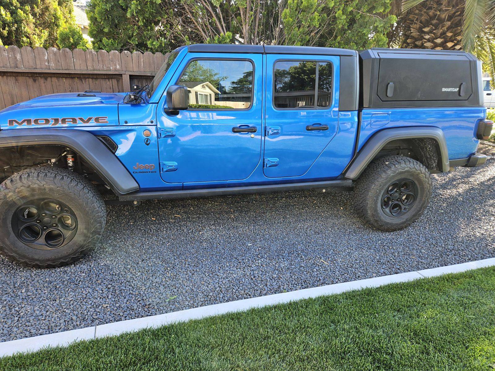

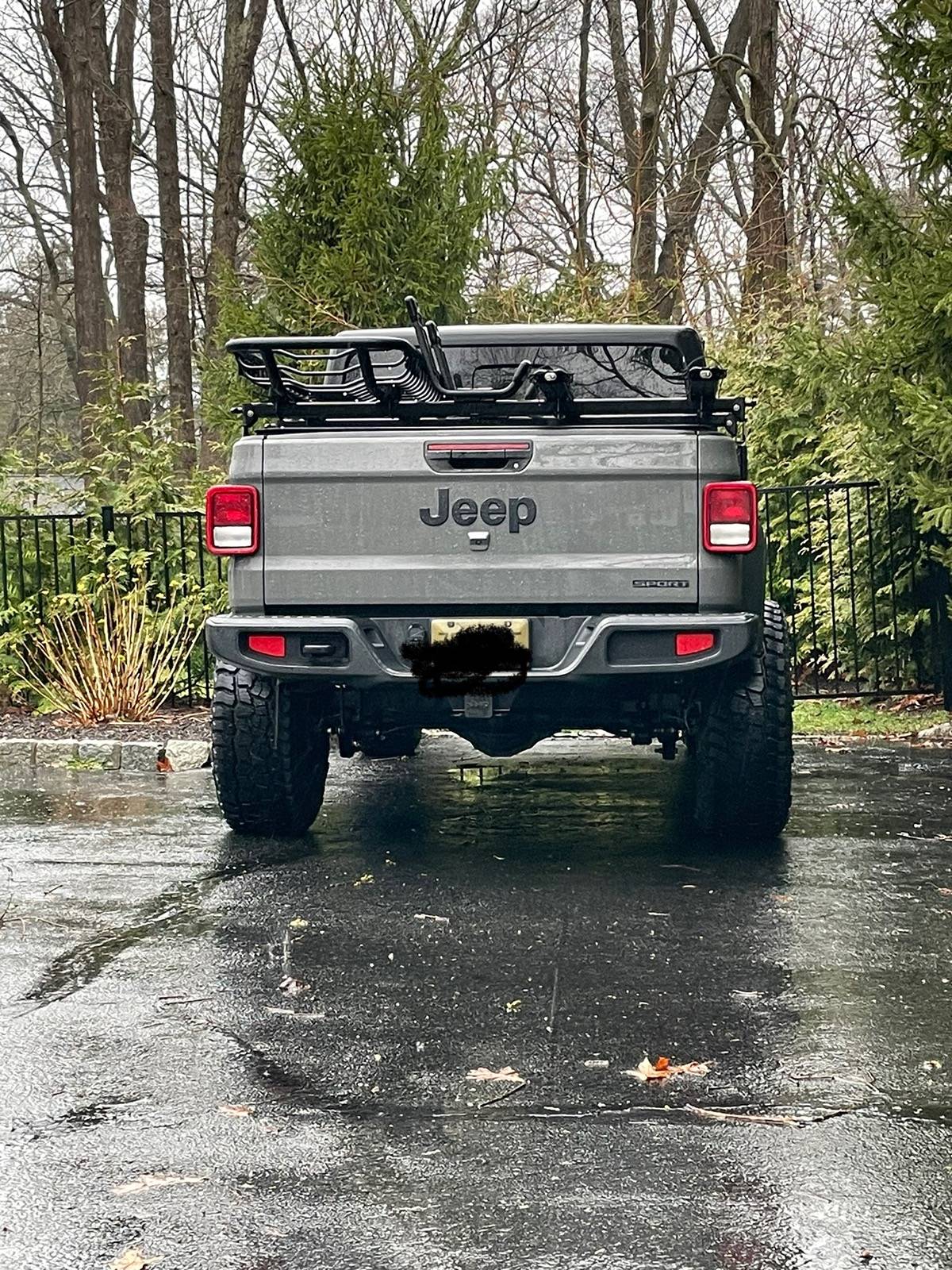

Here's my Mojave with the AEV lift plus geo brackets and 35" ko2's. Smartcap, RR Arcus with 12k winch. I do havehelper bags set at 5psi in the rear. 75% of the time I love it. The other 25% I hate because of the soft springs. I'm researching a completely different setup for the future.

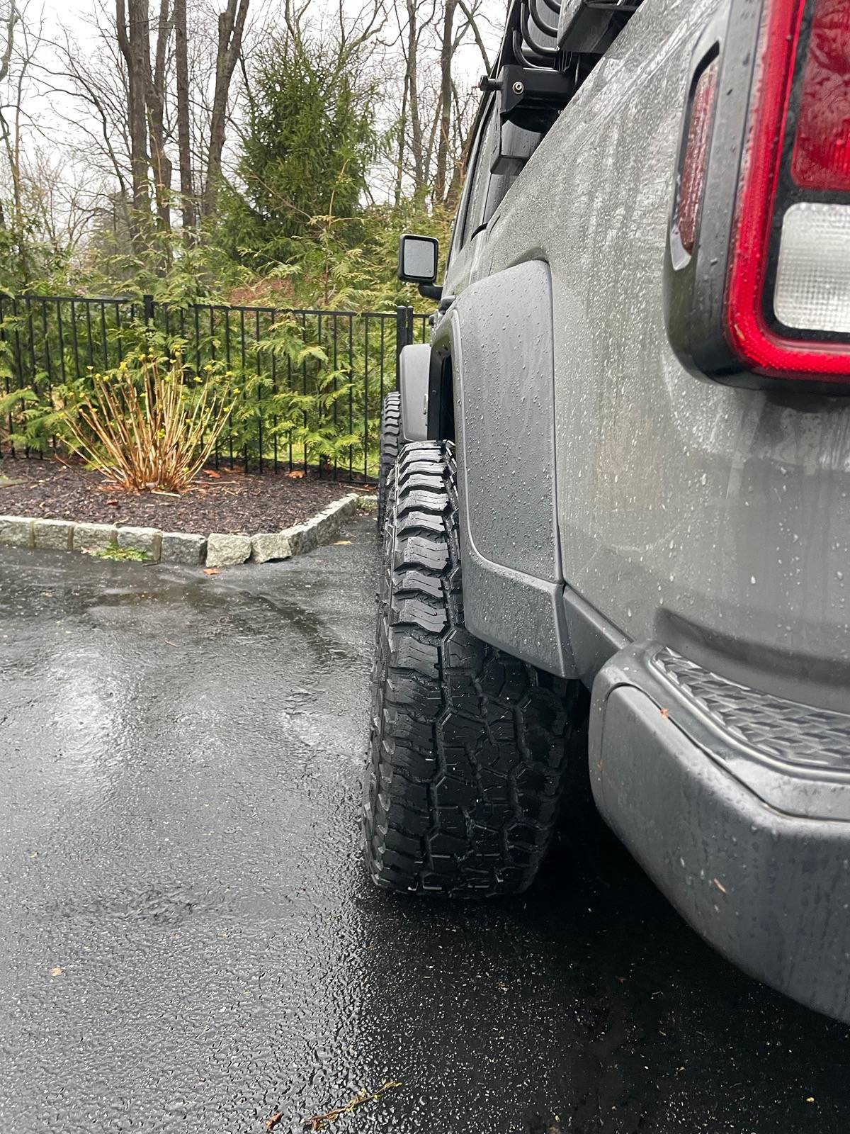

I have a sport S, with AEV 2” spacer kit and 35”s. Very pleased with stance/lift height as I didn’t want it to be too high. Doesn’t ride stock anymore for me though since I went with the Bilstein 5100’s, if your keeping all Mojave parts this shouldn’t be an issue for you. For the money I don’t think there is a more complete kit out there and AEV obviously stands behind their products/testing. As for longevity I can’t speak to that yet.

Thanks, still very happy with it, have about 3,000 miles on it. Did not regear and I am still seeing 8th on the highway. I did recalibrate with the snap that came with the kit to change the tire size to 35”.
Kept stock springs, I went with next size up on the Bilsteins, so longer shocks and did NOT use the extenders with the kit.
The Baja’s are amazing in wet weather and very quiet. I will have to see how they wear but so far I’m very impressed and it’s a bonus that they look like M/T’s.
if your not looking for a huge lift this is a really nice kit. With the Bilsteins it’s definitely firmer than the stock Sport suspension but FAR more stable on the highway.
FYI I also added the Bilstein steering stabilizer and the Steer Smarts sector shaft brace and that tightened things up quite a bit. I would highly recommend that to stop the floating around on the highway. Next will be the steer smarts adjustable track bar and some new brake lines although the stock ones are performing just fine.

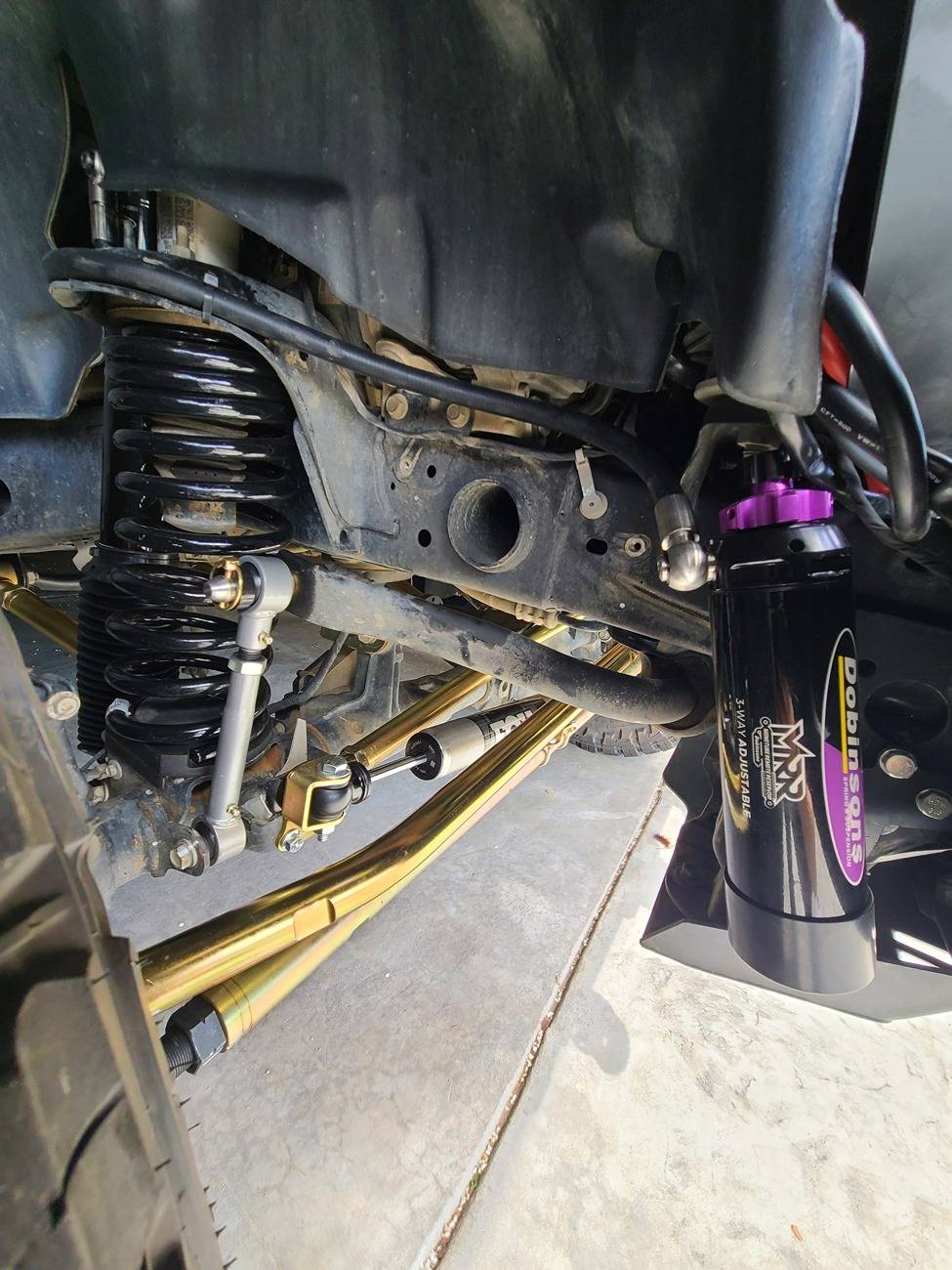

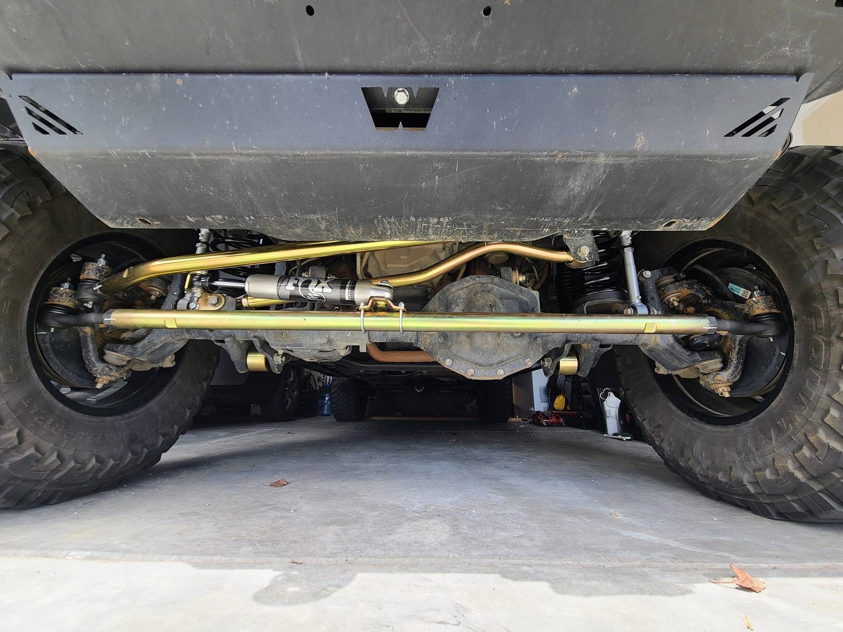

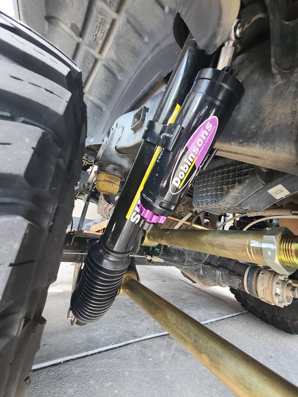

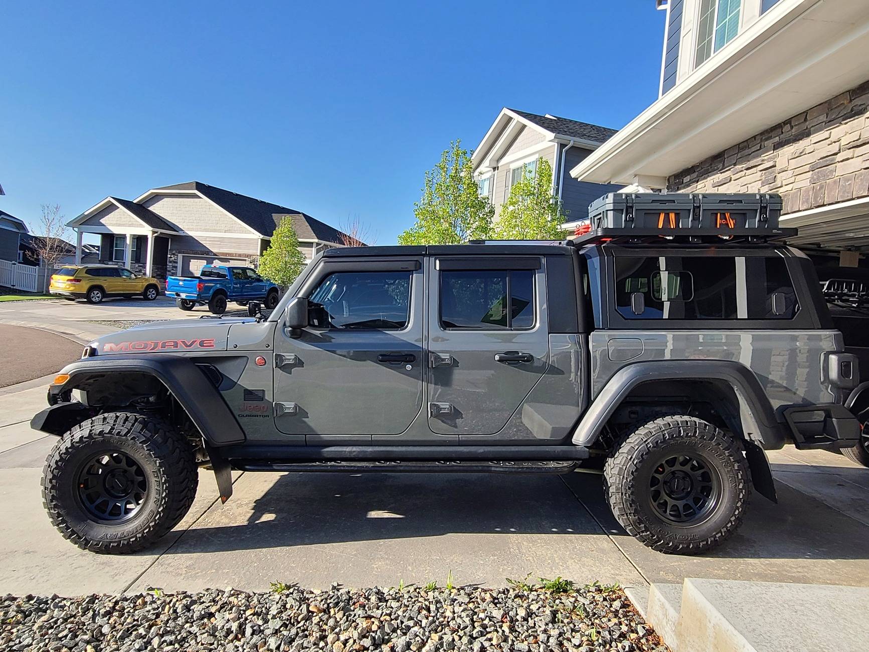

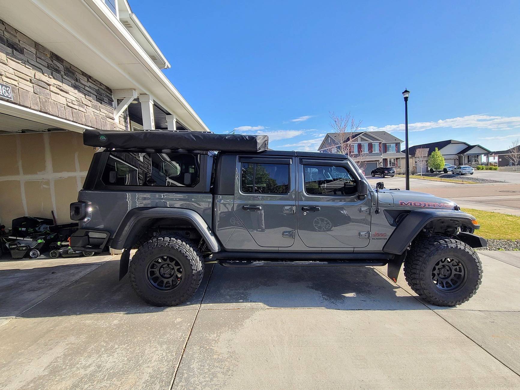

Weight is going to be your biggest issue with the AEV lift. I would wait until you have added more to the Mojave. I added steel bumpers, winch, smartcap, frontrunner roof rack, sliders, recovery tools and lost about 2 inches of rear lift, you can see it my profile pic. I was 5970lbs without camping gear and family. I dont think the AEV lift using the OEM suspension will handle the weight as well as upgrading your shocks and springs. Really depends on how you plan to use the Mojave. I found some guys with a lot of weight on AEV lift didnt like the way it drove and some guys are fine. With OEM suspension, I was bobble heading badly on rocky trails and quite a bit of lean and sway when turning, that boat feeling. My bump stops were hitting on speed bumps. Being lifted a bit more with that suspension, with the exception of bumps stops, I didnt see those issues getting better. I went with 3in Dobinson Mono Reserve Reservoir adjustable shocks and 800-1200lb rated front/rear springs, adjustable control arms, track bars and steering stabilizer from MetalCloak and have non of those issues. I was worried about losing the comfort and being to stiff but that was why i went with adjustable shocks, I can soften or stiffen as needed and not lose the OEM driving feel/comfort of the Mojave, the difference is, it handles the surprise bumps or pots holes with ease. I can handle those down hill mountain curvy roads with confidence and not have slow down, although, i think switching my 35s from 7.5in wide stock wheels to wider 9in Methods wheels help with that, Im planning on 37s. Be patient, do it right the first time! Good Luck!
