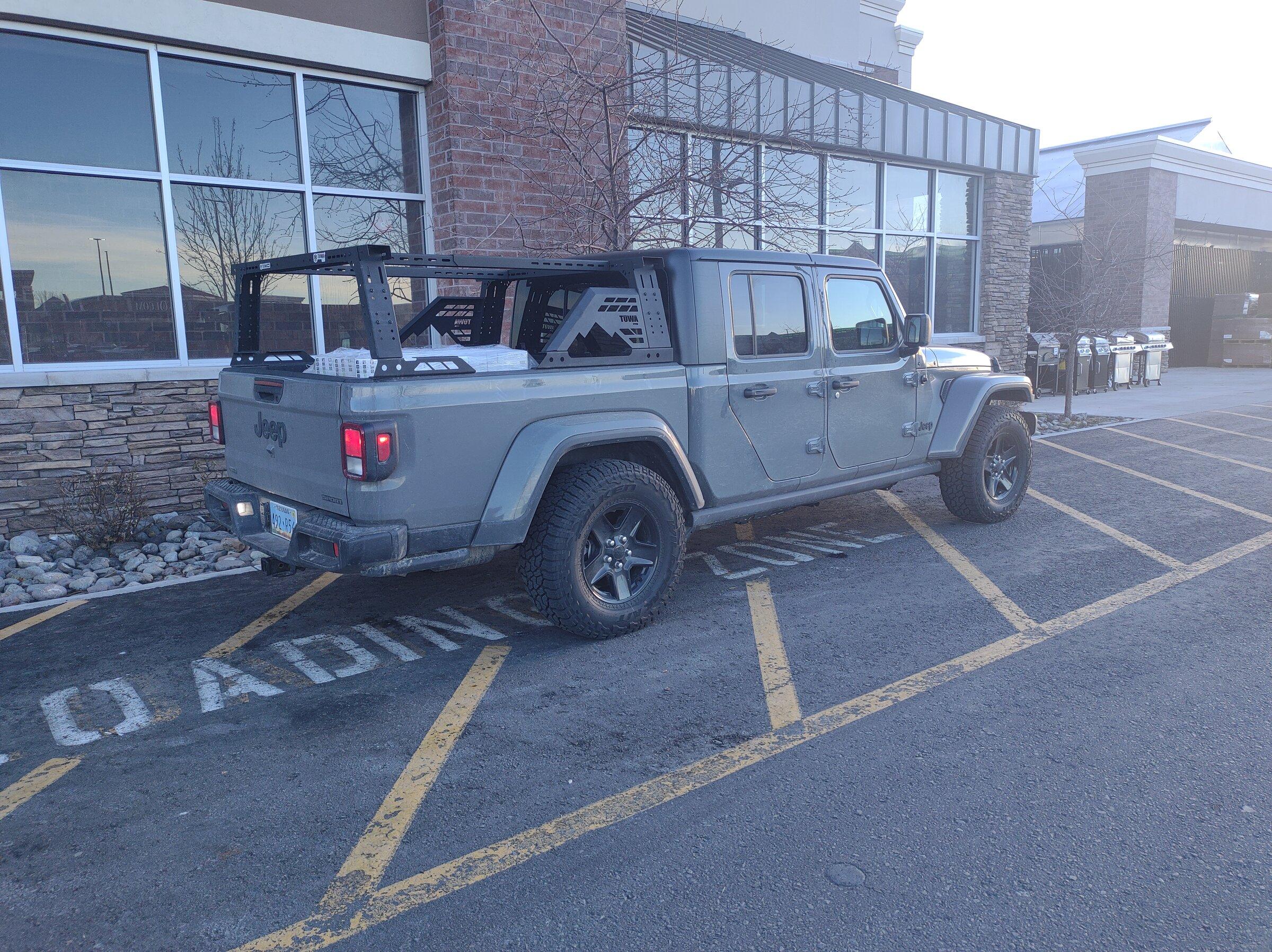

So it's ok to haul stuff in it and not be dragging my butt?
Nice to see so many naysayers but they are all wrong ....
Works great for folks like me who are capable of pushing 4 containers from back to front if they ever need room or of loading mulch bags on top for the 10 minutes home
And way better than modifying the engineering of the jt with $150 worth of bumper which might increase wear on swing arms etc ..

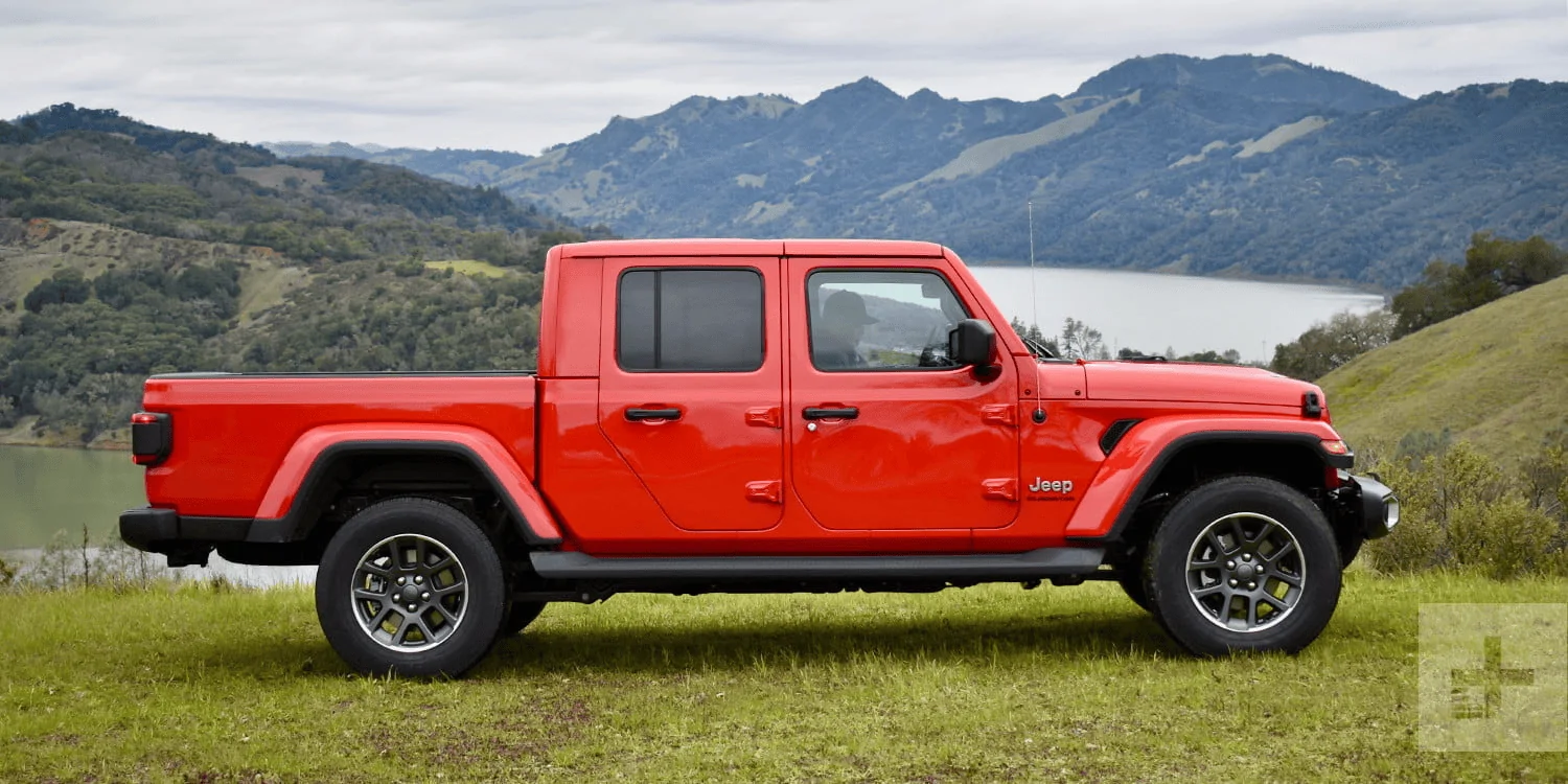

What is the question exactly? Are you asking if that’s why they designed it with “rake”? Because that’s always been my impression: it’s a pickup - so when you’re carrying load, it flattens out instead of having a Carolina squat. I’d take daily rake over squat under load ??‍♂

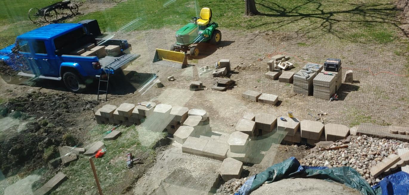

I have 2 70lb sand bags in back for winter. Yes truck handles better with a little weight in back.
But I also thought factory rake too much. Added 3/4" pucks in front. Happy with it .
