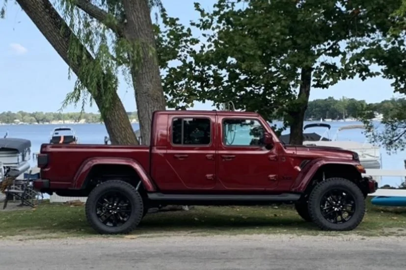

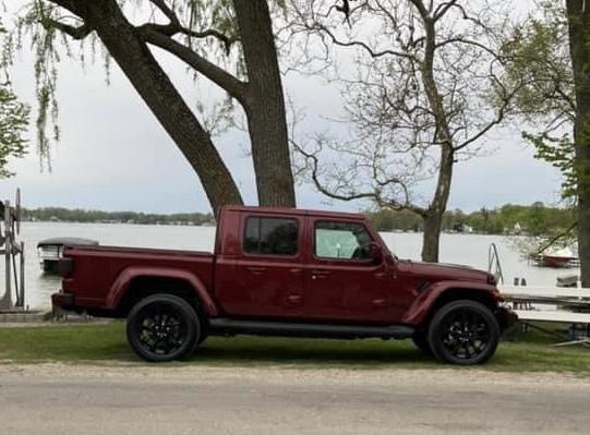

Reduce rake by adding weight in JT bed
WILDHOBO
Sep 24, 2021
73
11,684
17,786
2021 Gladiator Rubicon
Network Engineer
So you are going to
1) make your truck handle worse.
2) accelerate worse
3) get worse fuel economy
4) wear its suspension faster
5) create the added hassle of having to remove 250 lbs in order to access the rear of the bed. (the most useful part in day to day use)
6) have to adjust your headlights for the new rake and have them pointing into the ground when you temporarily remove the weight.
7) consume about half of your remaining load capacity once you put 2 people in the truck
All to subtly change the look of the truck??
Uh. no.
I still do't get it. Its like a skinny teen age girl with body dysmorphia who sees a fat girl when she looks in the mirror. Rake Rake Rake. Oh My God. My truck has "the rake".
I like the rake. It’s there for a reason. When I lifted it, I put different springs in the rear to get the rake back. It performs amazingly off road for it. Great departure angle and better on steep climbs.
