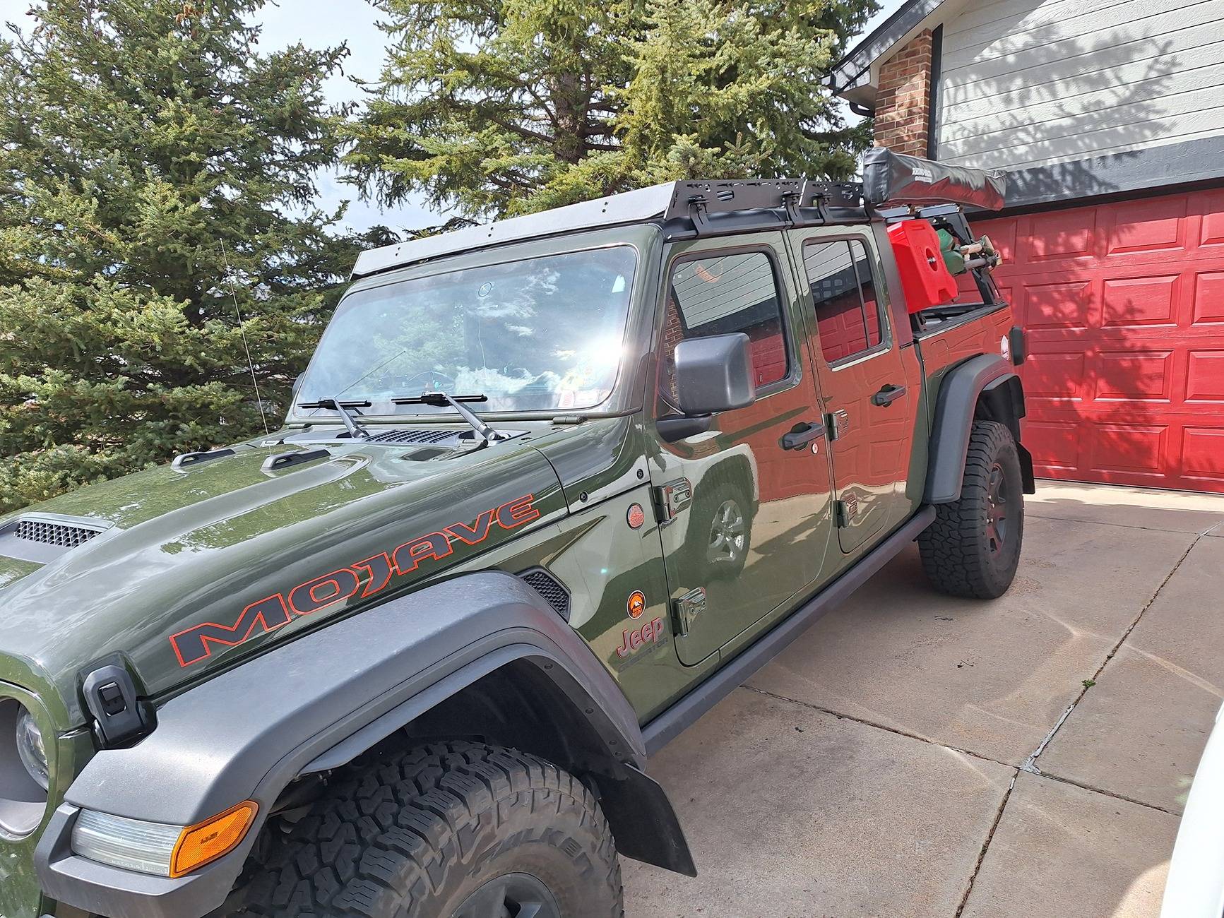

I have located a New mojave at by dealer, but want to add new rims and true 35's. I think the 35x12.5 looks a little squatty stock. I think a small lift would make it look better, but I do NOT want to sacrifice ride quality???? Any ideas?? Thank you!!
2021 Mojave with the AEV spacer lift which does include the shock relocation or correction brackets and 35s.
Jeep Gladiator Can I add 1 or 1.5 lift to my stock Mojave and not hurt ride quality? 20240422_161831
