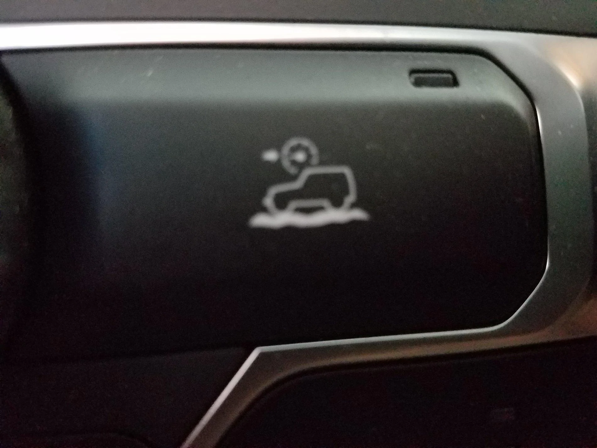

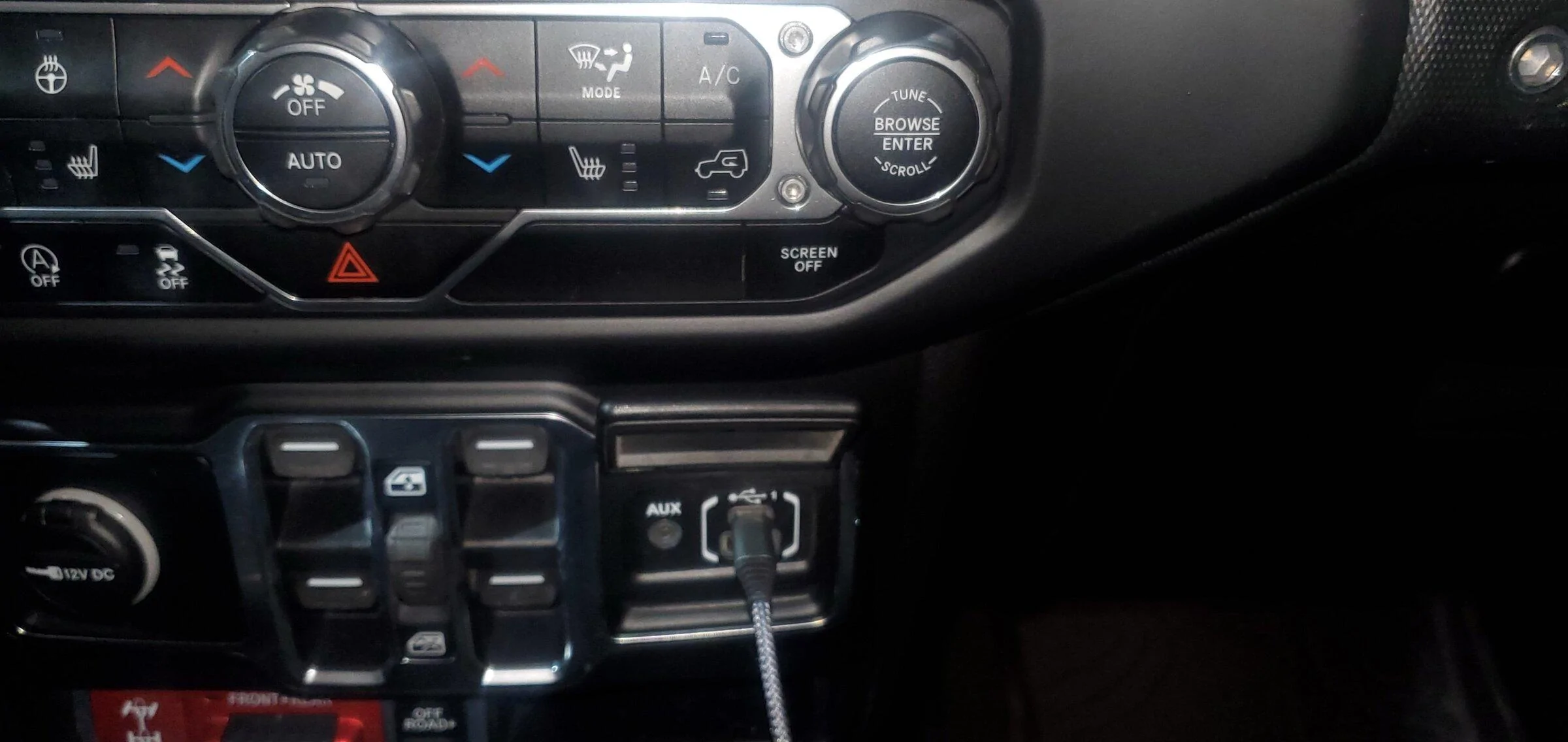

Manuals don't. All automatics do. :). You guys have an extra button that I don't have. Still get BLD, of course, but no offroad cruise.
Manuals don't get this.:

Ours is blank there:
That's duck mode.......
