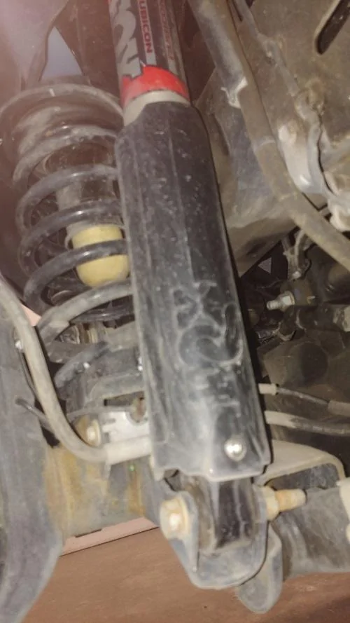

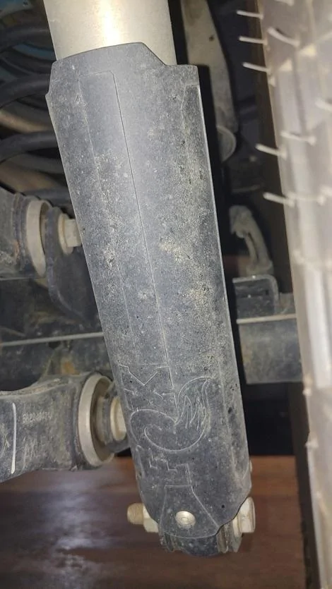

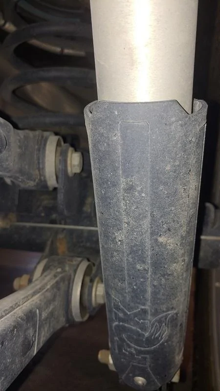

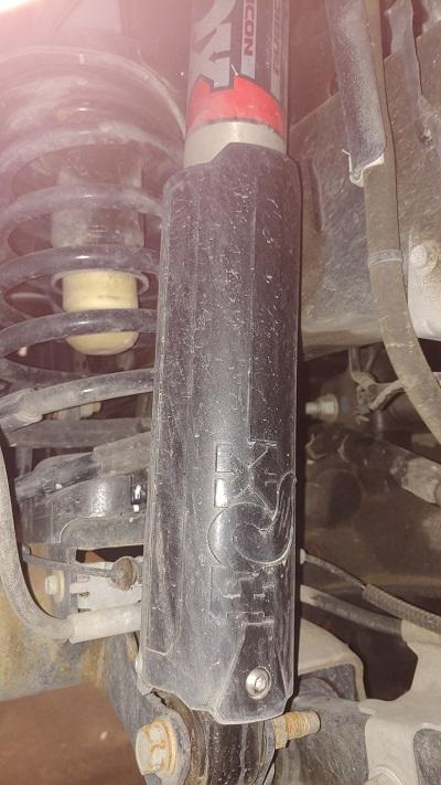

Yes. They went right on mine and would go right on yours.
There's a forward and rearward direction but I have pictures of that - or will get a picture or two.

Left rear shock looking backwards toward rear of truck -

Below - left front shock looking forward from behind wheel ->
