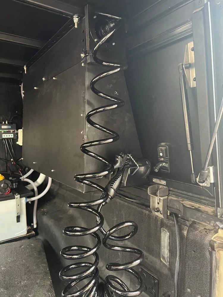

I’m probably not going to be much help as I am running an Alu-Cab canopy with a James Baroud Evasion RTT. I specifically got the Alu-Cab canopy to “combat” the very issues you are dealing with.
First off the Alu-Cab has rails manufactured into the roof which makes attaching load bars and a tent extremely easy.
As far as your issue with the canopy coming loose, the Alu-Cab actually has rails inside along its base that allows it to be clamped to the Jeep Trail Rails using bolts and nylon nuts. See the below picture in the foreground near the spray nozzle. I haven’t had mine come loose in the two years it’s been installed and it gets a serious workout all the time. If your RSE cap has the ability to be attached in this manner, it should do well.
I know there are others on here that run the RSE cap, so I’m sure they’ll be along eventually and will probably have better and more specific advice.
