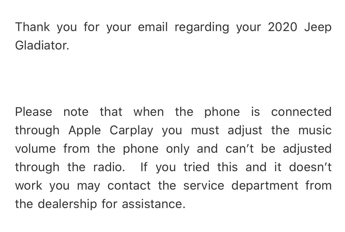

Here’s the response from FCA Canada! Not much help and doesn’t understand the basics of CarPlay system...
Jeep Gladiator Carplay Volume limiting F3980535-956F-4FC8-A07D-3C1F60613933
so I played a bit with the system and if you turn off the volume adjusting options in the headunit, it seems that the sound doesn’t stop to go higher at 28 like before!
still need to test a bit more!
