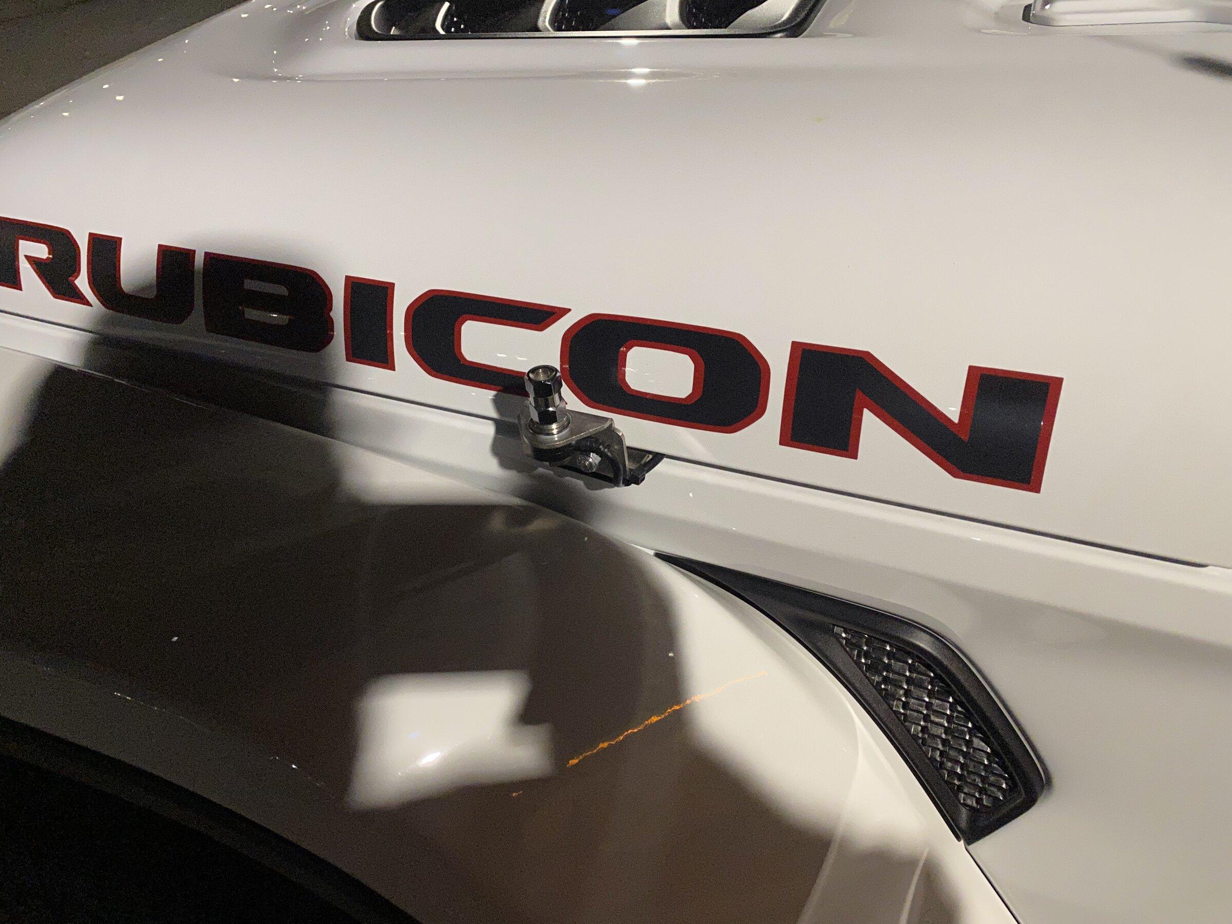

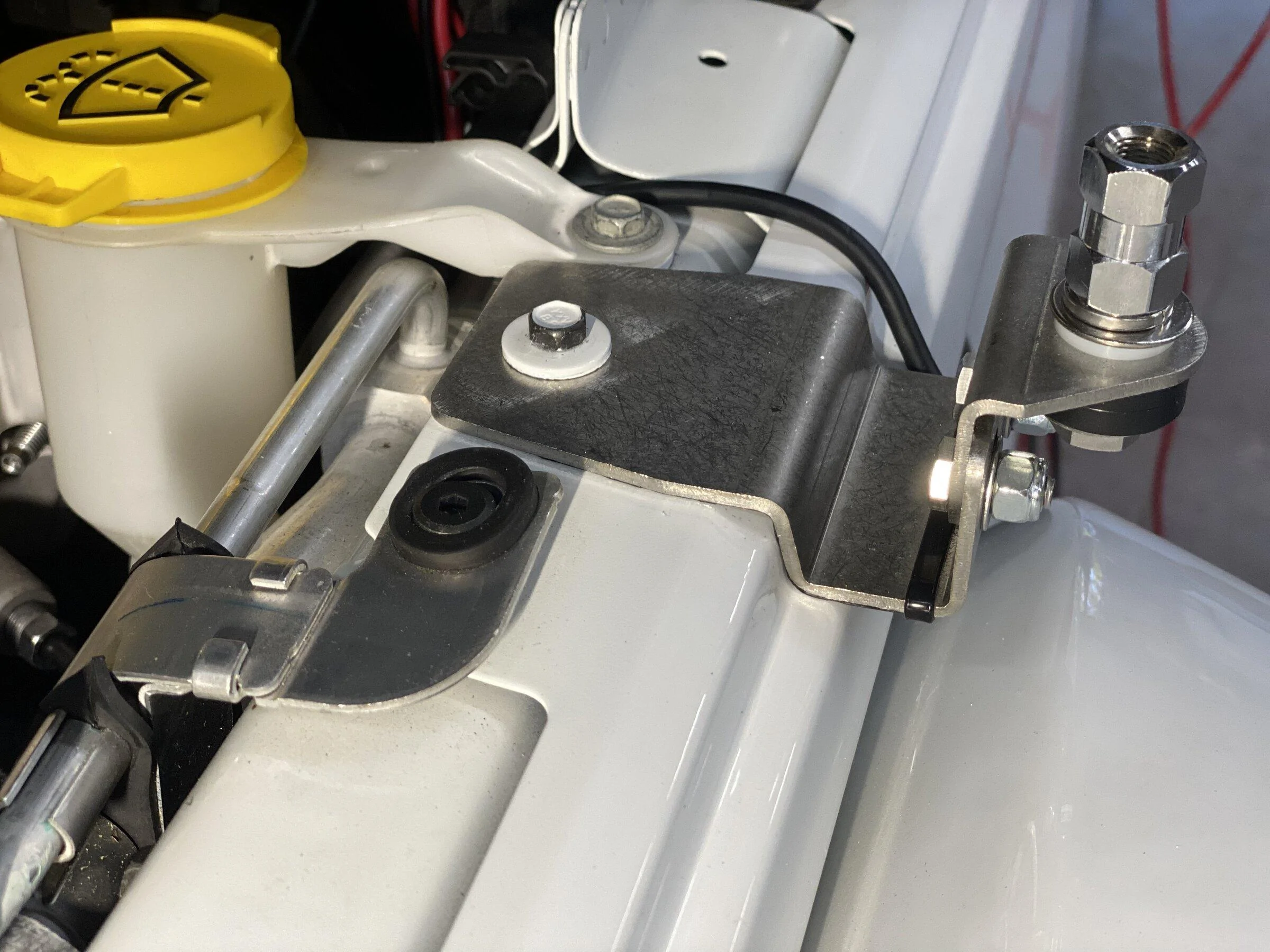

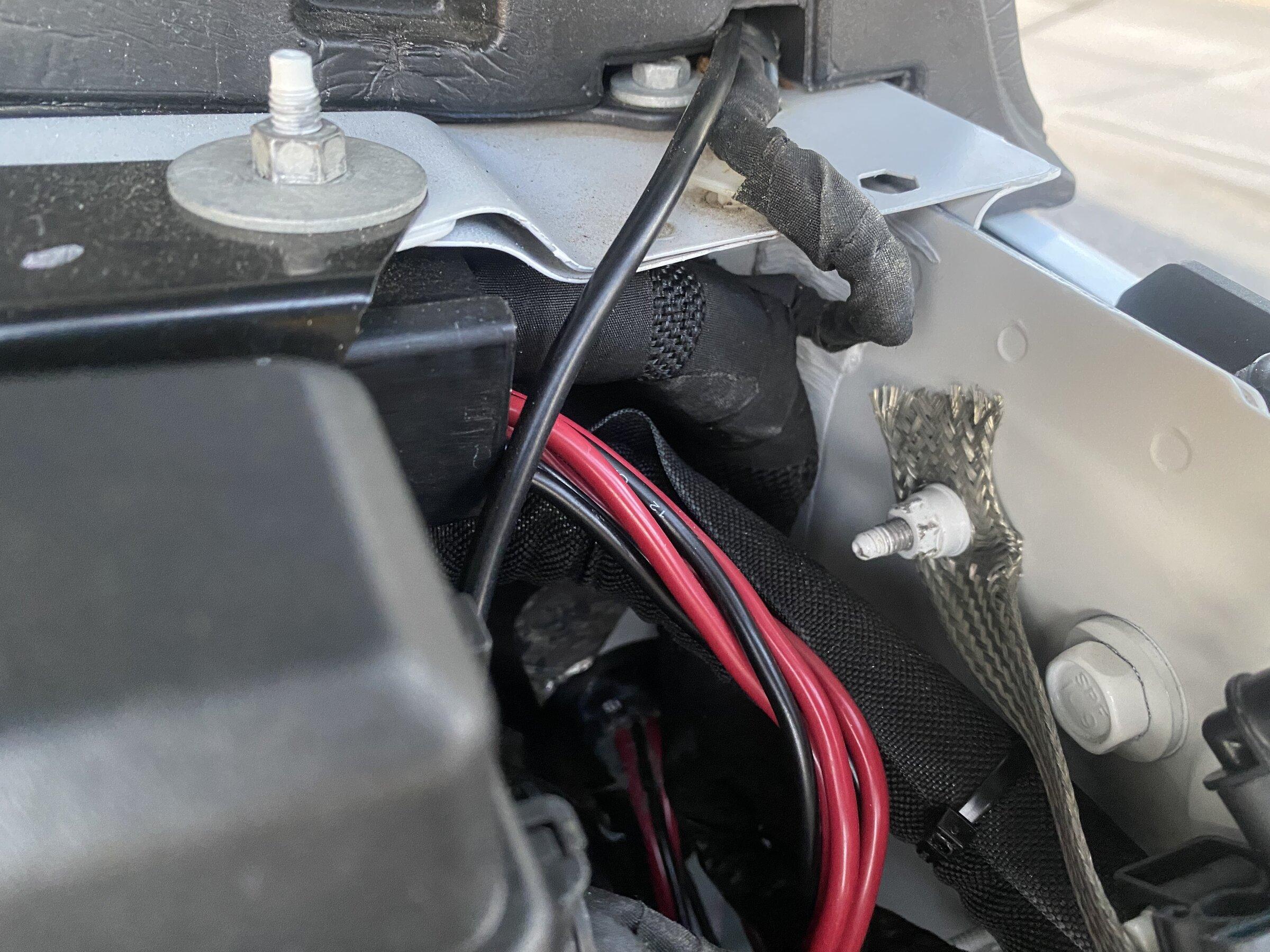

I had my CB antenna setup tested yesterday evening and I have a bad ground. I have a ‘21 JTRD. My mount is a fender mount on the drivers side. The CB shop didn’t have a tech available and one isn’t available during my non-working hours.
The fella cautioned me on using Body ground points, which I confirmed by using one near the hinge of the hood near the fire wall on the drivers side. It doesn’t provide a good ground. The routed coax was tested with a dummy load and it tested 1.1 to 1.
So I don’t have to tear apart a bunch of stuff, is anyone aware of a good place to attach a grounding strap to the chassis on the drivers side?

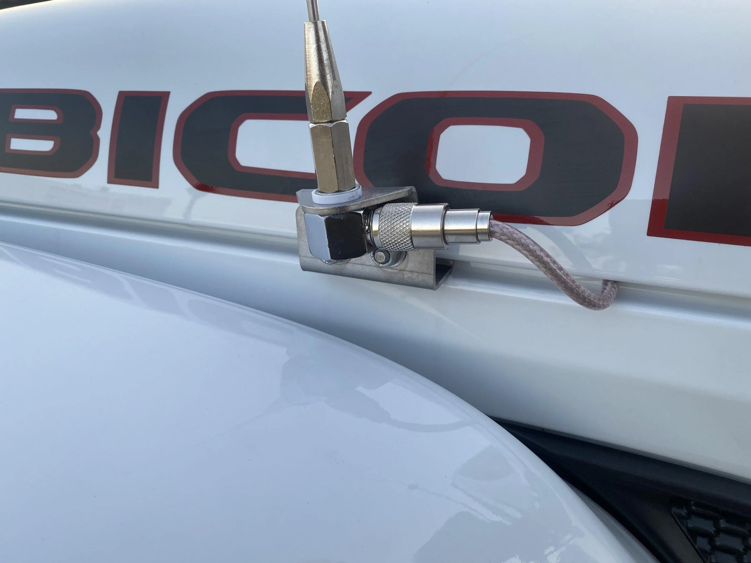

The antenna is a 55” Husler center load whip (Hustler (HQ-27). I also got the magnum version for the thicker main shaft for less flex…to run on the street. At highway speeds the non mag version is all over the place.
I got 8 ft of ground strapping I’ll run from the mount off to the drivers side after work so see the result.
I also replaced the Stryker 94, previously shown in another post with a Ranger X9.
I also changed the coax. The attachment to the bracket is now a 90 degree with a proper end on it. The owner of the CB shop on Saturday indicated a ground issue so it was swapped out. I really hope I don’t have to reroute the cable again. My trim panels around the roll bar will be pissed…lol.

The grounding at your current antenna mount should be sufficient in that its making contact with the sheet metal right at the mount, which is all you can hope for. If that checks ok with an ohmmeter to another known good ground point then any additional grounding at the mount should do absolutely nothing for the VSWR.
Your antenna probably wants more flat sheet metal right under it and the major ground plane right now is the hood, which has virtually no ground current flow back to the antenna. Even if you were to put ground braid across the hood hinges its nowhere near the antenna feed point.
Your antenna mount has raised the feed point way up and away from the sheet metal and there are other mounts that simply stick out the side just a little with the antenna mount much closer to the hood. Those mounts would work slightly better because they keep the antenna feed point closer to the sheet metal. When you raise an antenna feed point just a few inches above the ground plane you compound the problem and it will be harder to match the antenna. Just remember, the people marketing the type of antenna mount you have are not antenna engineers, they are jeep parts fabricators. Its about the same as an antenna engineer trying to design a suspension component or new pistons.

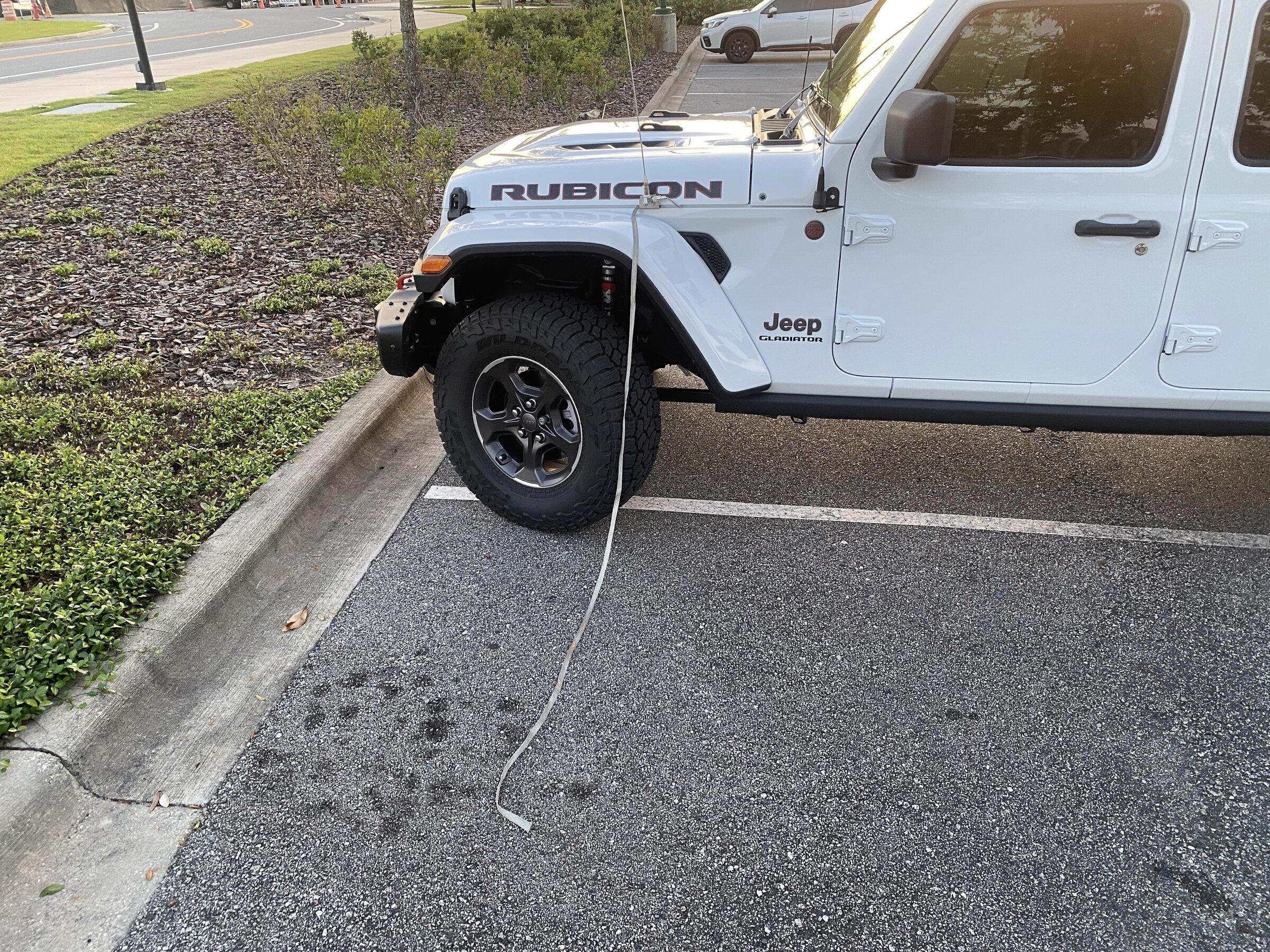

If you have time to do the flying 8ft ground radial out the side, that should be very informative.

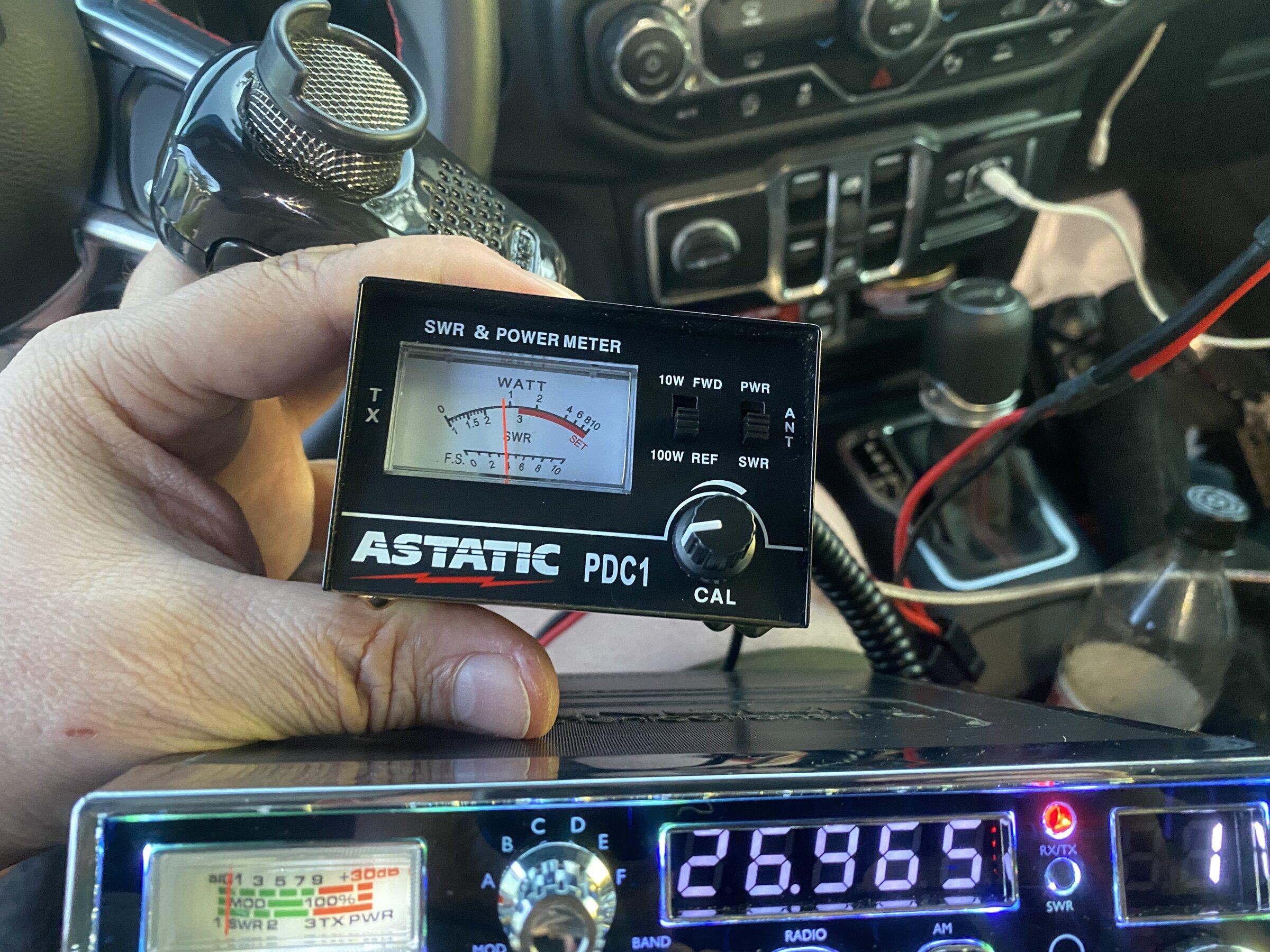

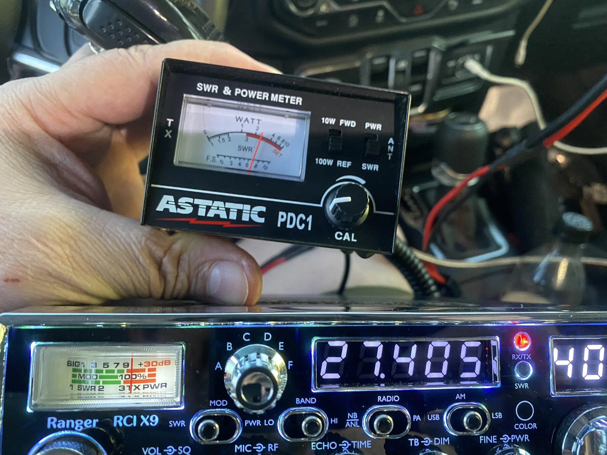

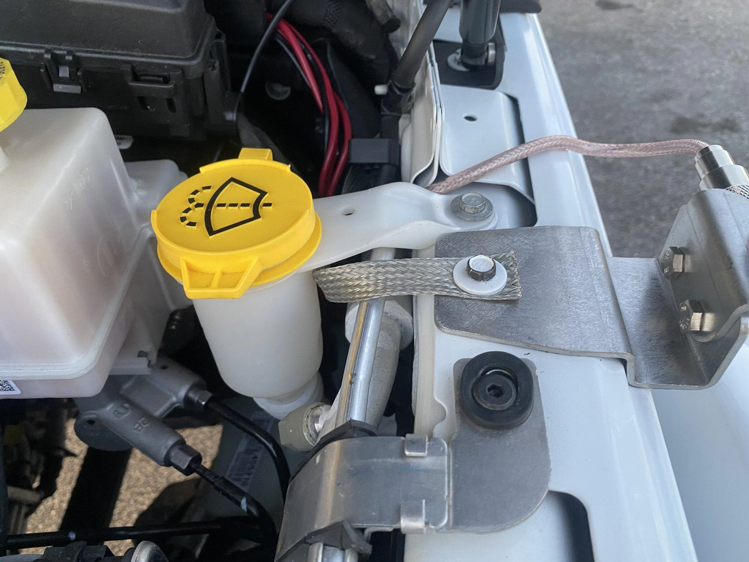

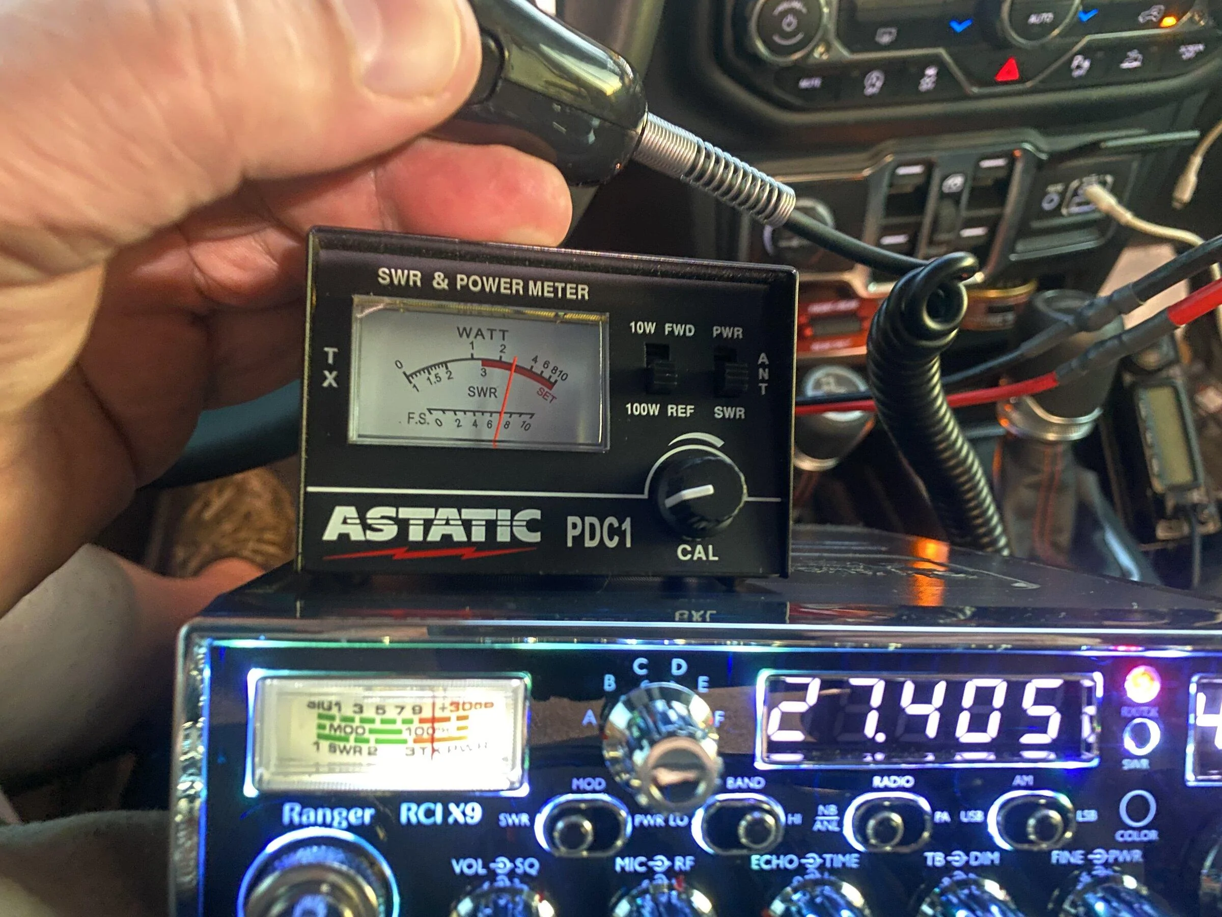

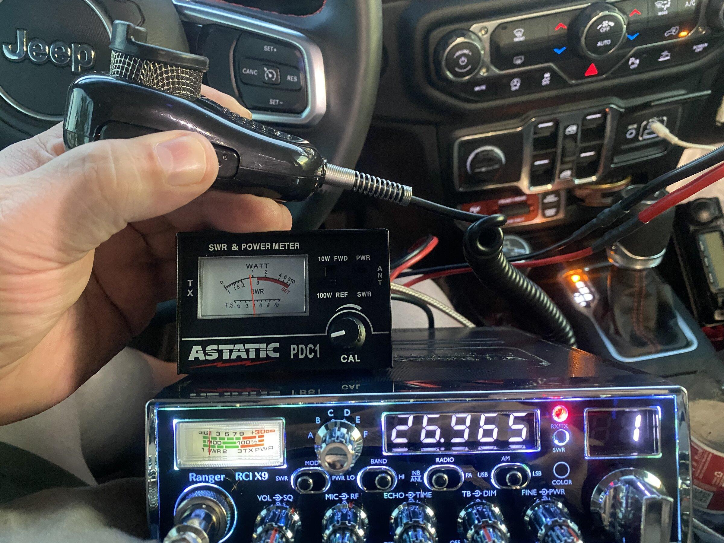

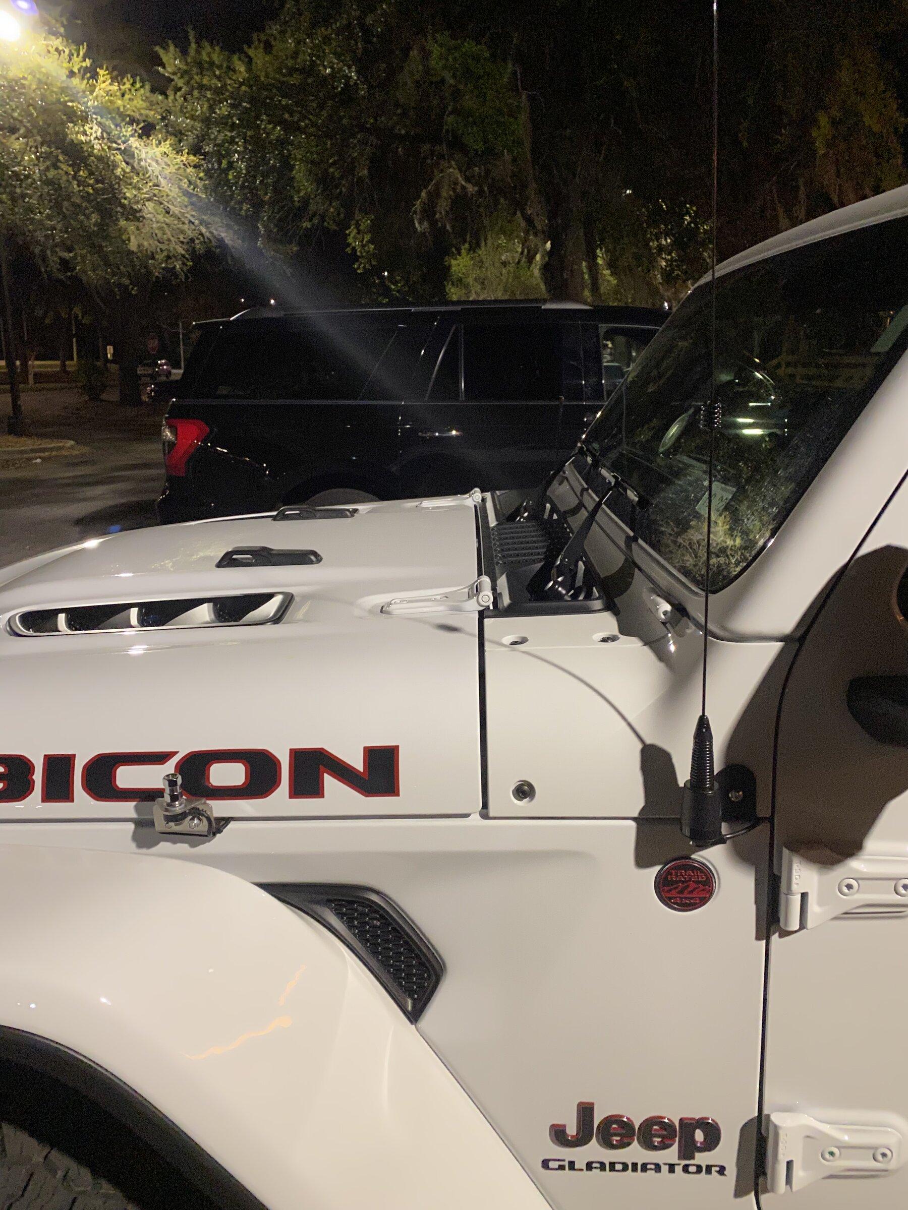

Well…. As I indicated I would, I followed through with the recommendation of @Radio Guy.
-The first 3 photos are of the current setup followed by the corresponding SWR reading.
-The next few photos show a longer ground strap stretched out followed by SWR readings. I threw the strap over the hood with the same result.

In both sets of pics it shows a better match on channel 1 than 40 which would indicate the antenna is too long. It looks like the match might be very slightly better without the long strap and if the antenna is actually too long adding the strap would make it worse.
Are there any set screws that would allow shortening or lengthening the whip? If so make an adjustment and see if shortening makes it better or lengthening makes it worse. Its possible that cutting the antenna shorter will put you in a useable VSWR range but you gotta prove that shortening it is the way to go before committing to the cut.
