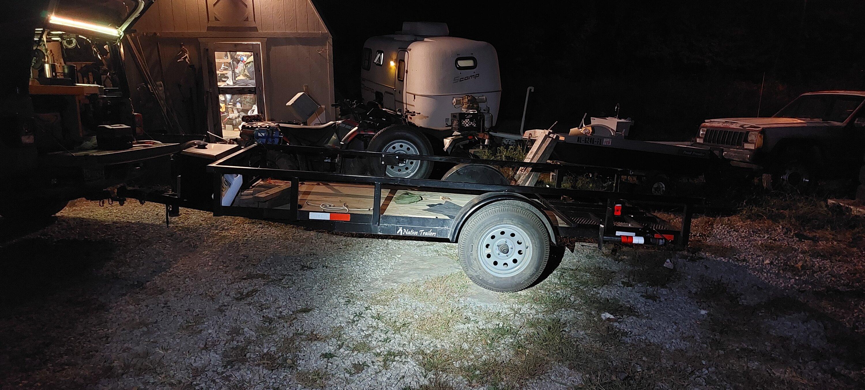

Oddly enough I bought a new utility trailer a month or so back. Check if there is a "local" builder somewhere in your state. I got a 3500 lbs trailer built to order for about $1700.°° now I'm modifying it too.
Jeep Gladiator Cheapie Home Depot trailers 16655326995681376728162825473647
a heck of a better trailer than the box stores sell. 15in rims spare tire is $106.°°
