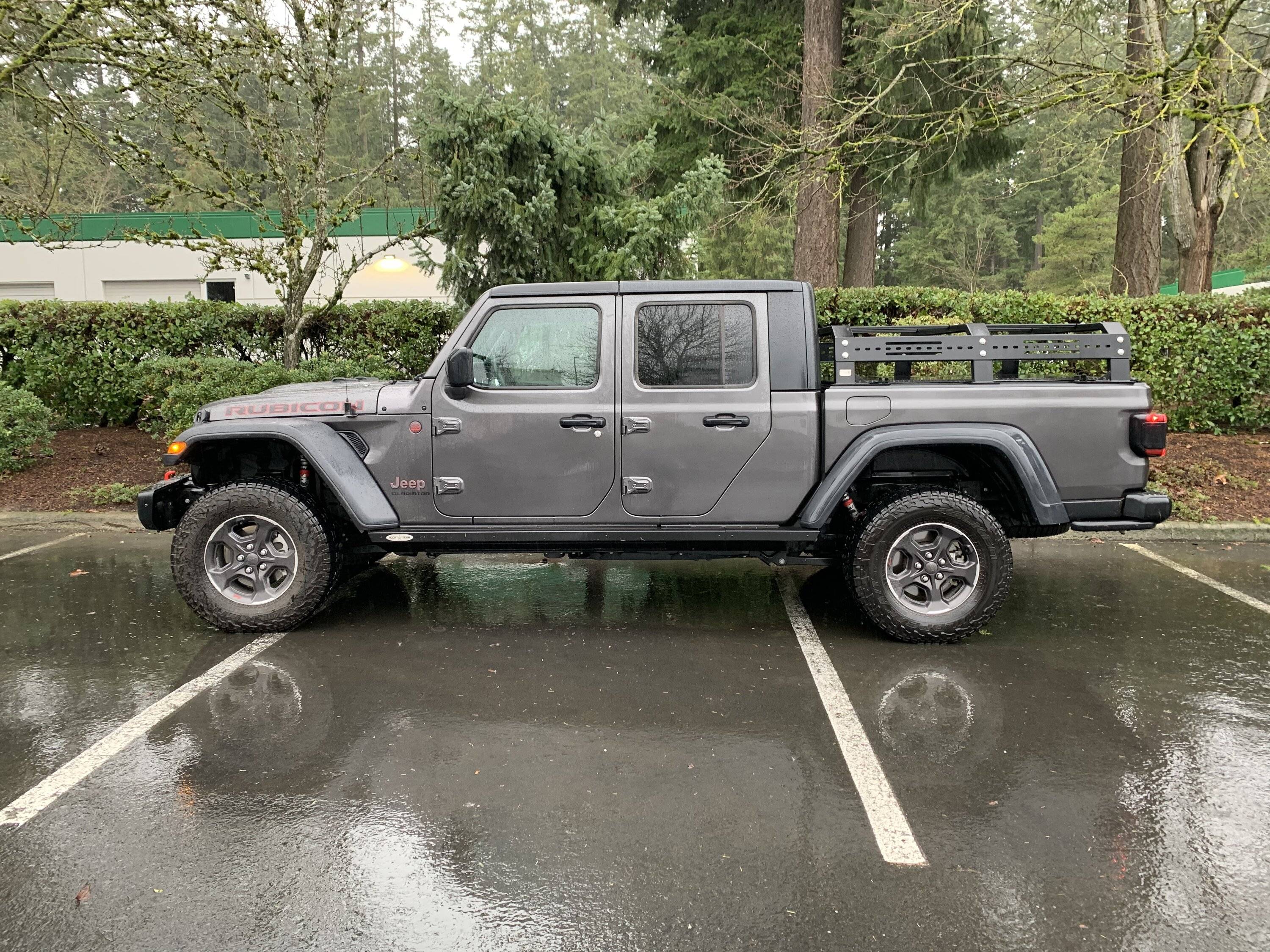

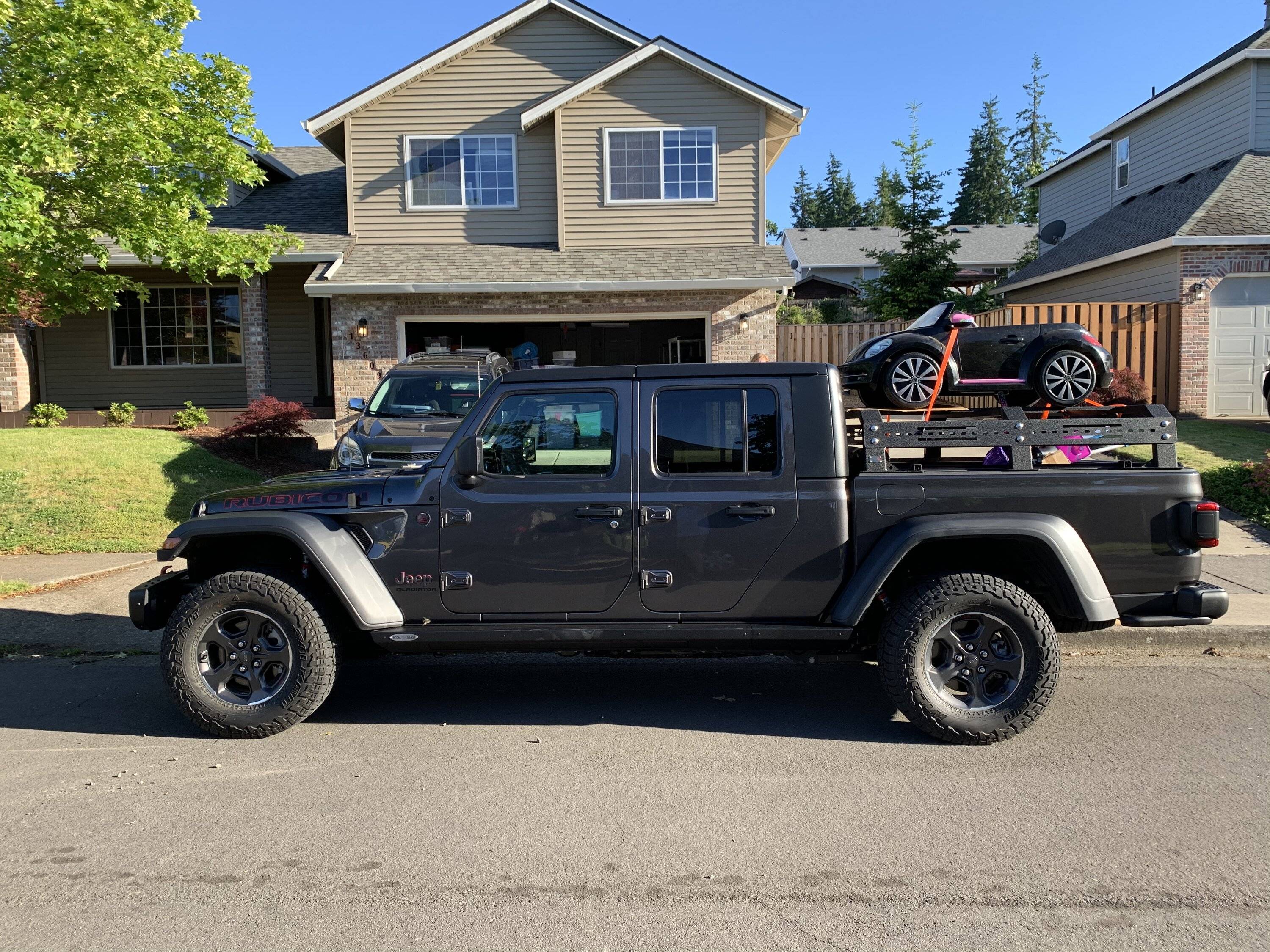

Summer vs winter rain in the Pacific Northwest, haha. It really does look different though.
I added a link to the Clayton kit, in the original post.
Lmao. When it's sunny in oregon it's a great view makes everything look like crap. When raining it's gloomy and makes anything clean look great :CWL:
