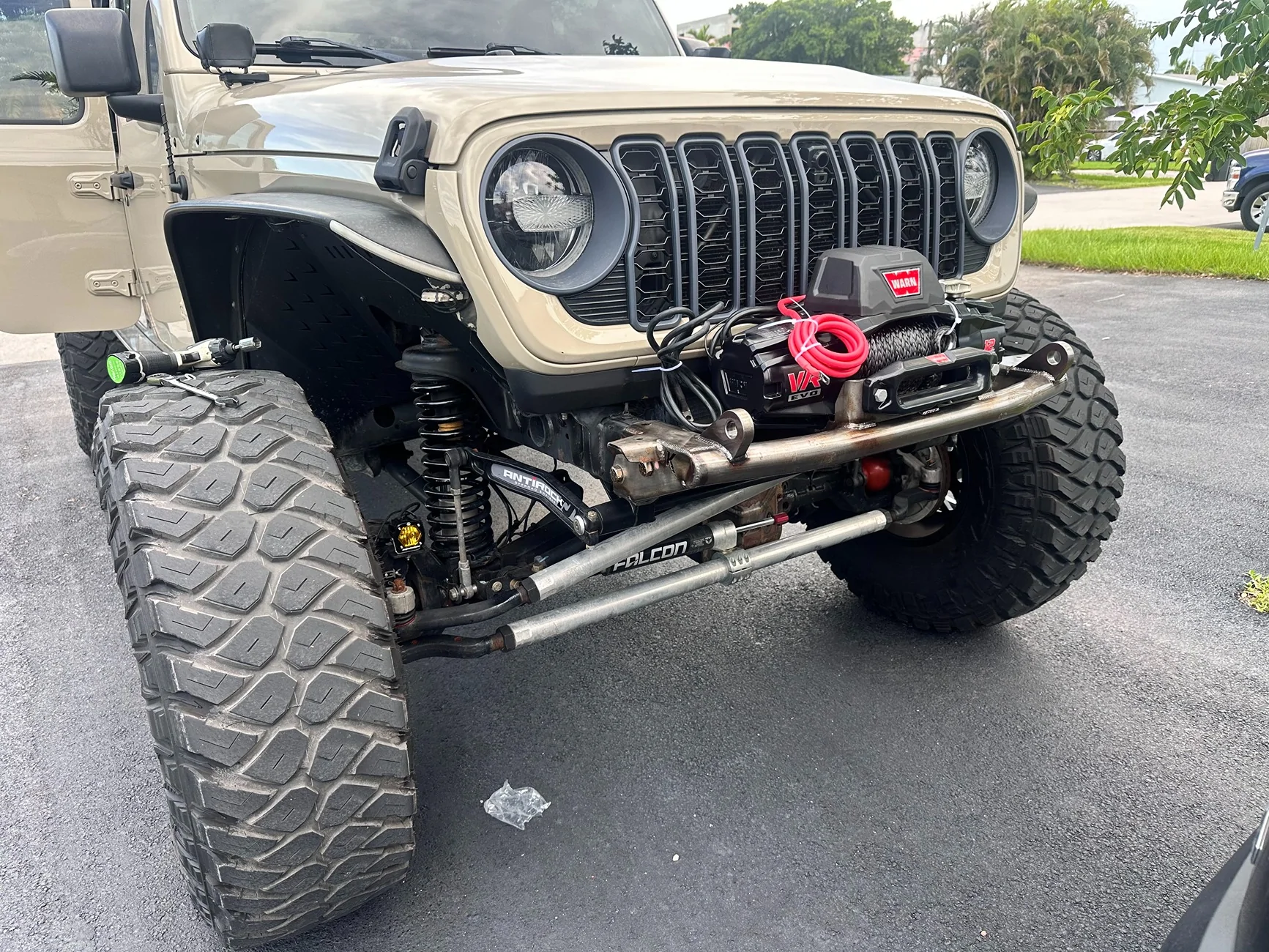

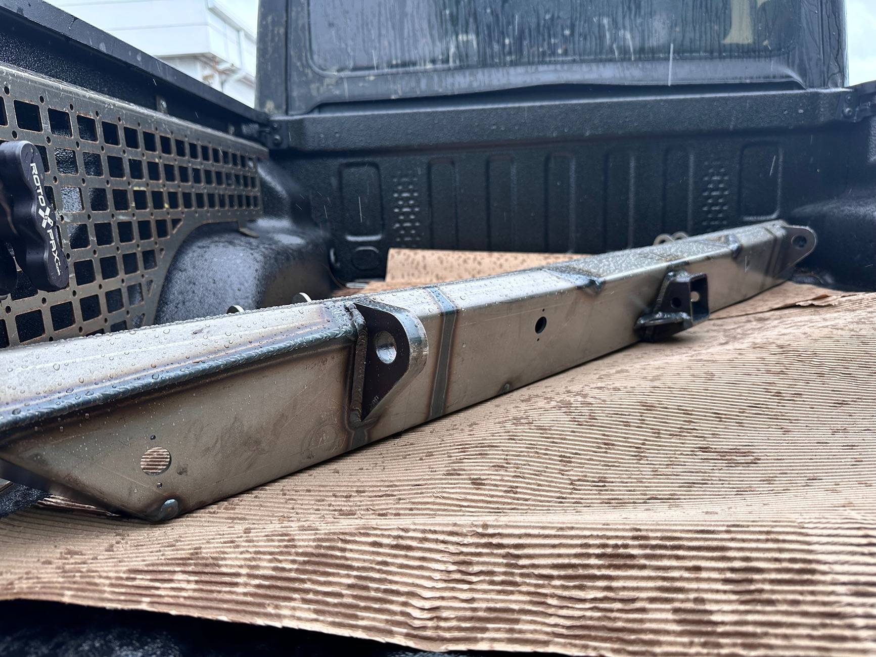

I clear powdercoat all my steel stuff :) Holds up fine, if you see it nicked, just hit it with a can of clear
Bonus, you can see my steel bed attachment thing in the first pic with the bumper, also done in clear. I've had it on there about 2 years

Looks cool and I’m considering if I’ll go this route. Wish I could do this at home, but I definitely can’t powder coat in my garage.

Is that a one off homemade bumper? Been thinking about doing one myself. If so what winch mounting plate did you go with?

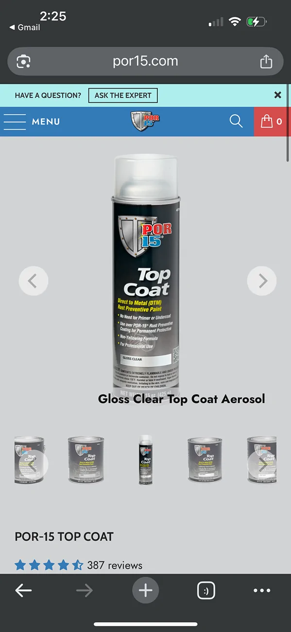

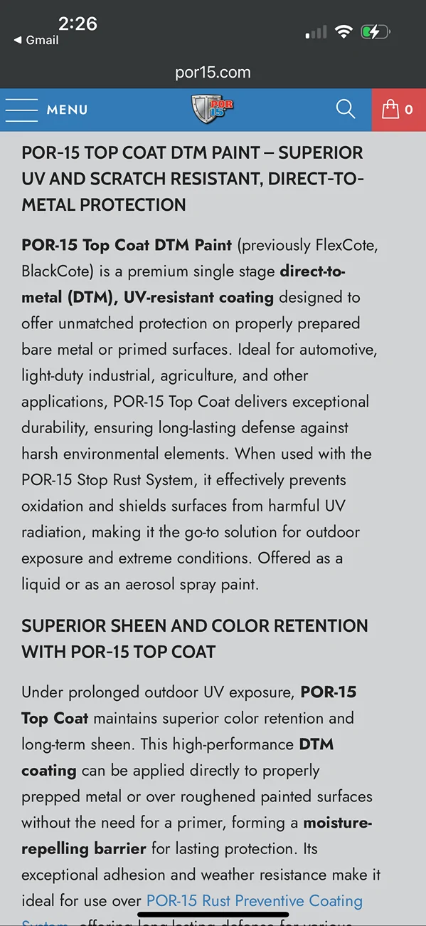

Rattle can the sh*t out of it and it’ll be fine
I briefly searched the internet for an appropriate coating and saw that POR 15 makes a direct to metal clear coat product in a spray can. Their rust converter coating was absolutely magic on an 84 Datsun/Nissan pickup I had. I would probably trust their clear to hold up well on a front bumper.
