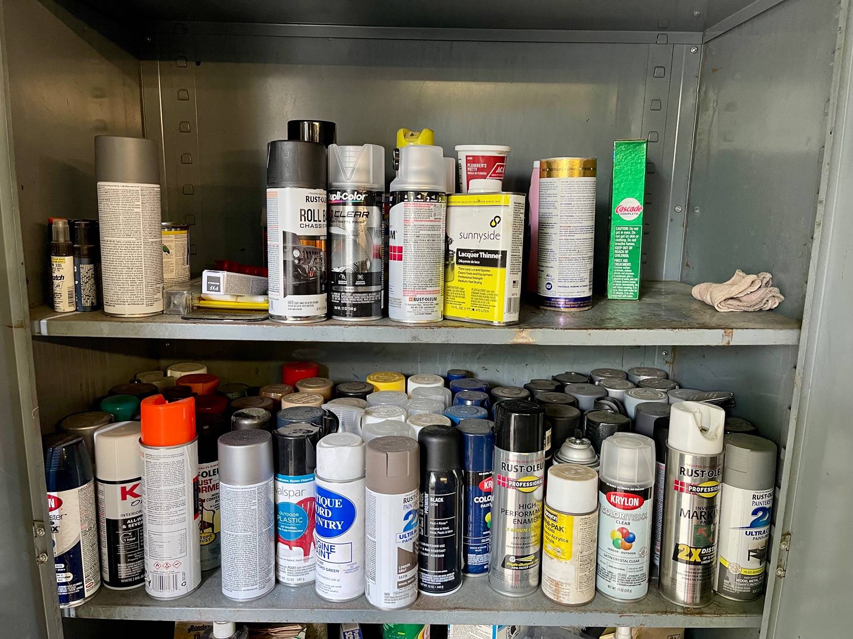

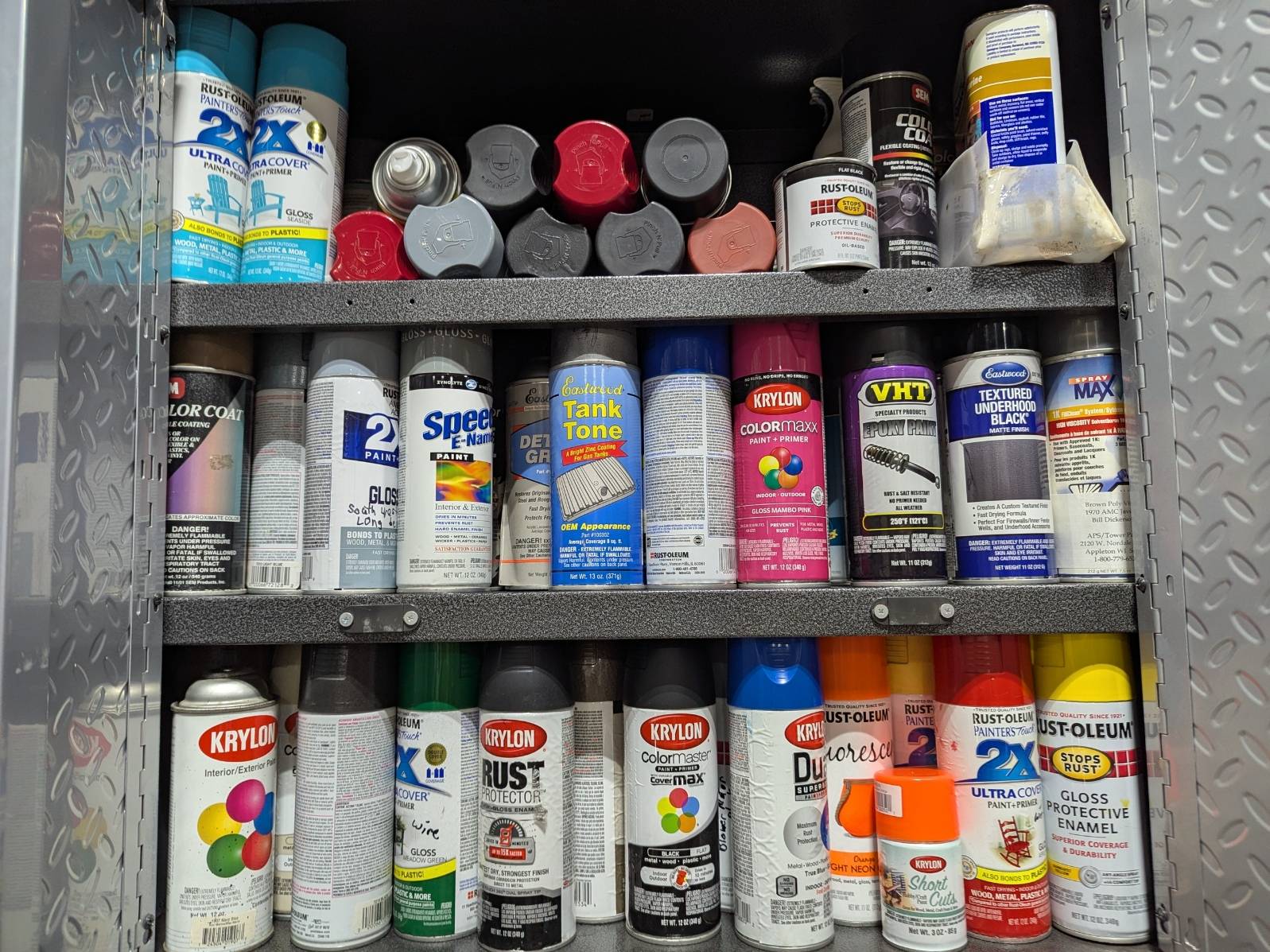

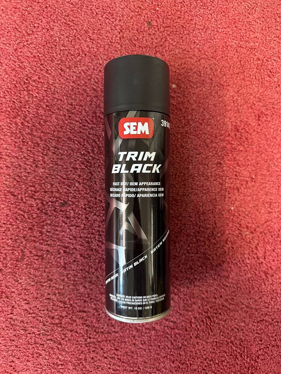

That looks great. Another option for paint is SEM Trim Black.
I use that on some of my car parts - nice for trim, stays put even on plastics.
I have a number of SEM and other types of paints for restoration purposes.
I'd bet I have that, and the textured paint he used on his bumper!
the VHT black I have is a 1 part epoxy type paint and I used it on the door locks of my SX4 to black them out to match the Jeep door handles on the car. It's a great paint and holds up to weather.
I also have a texture paint that's used as a base and then you spray a color over it..

Many get used pretty regular, touchups on cars for show and so on, or other restoration projects - but - Yes, there's probably 4 or 5 out of all of them that won't.
The Eastwood sprays still work fine after several years. Just used the tank tone recently.

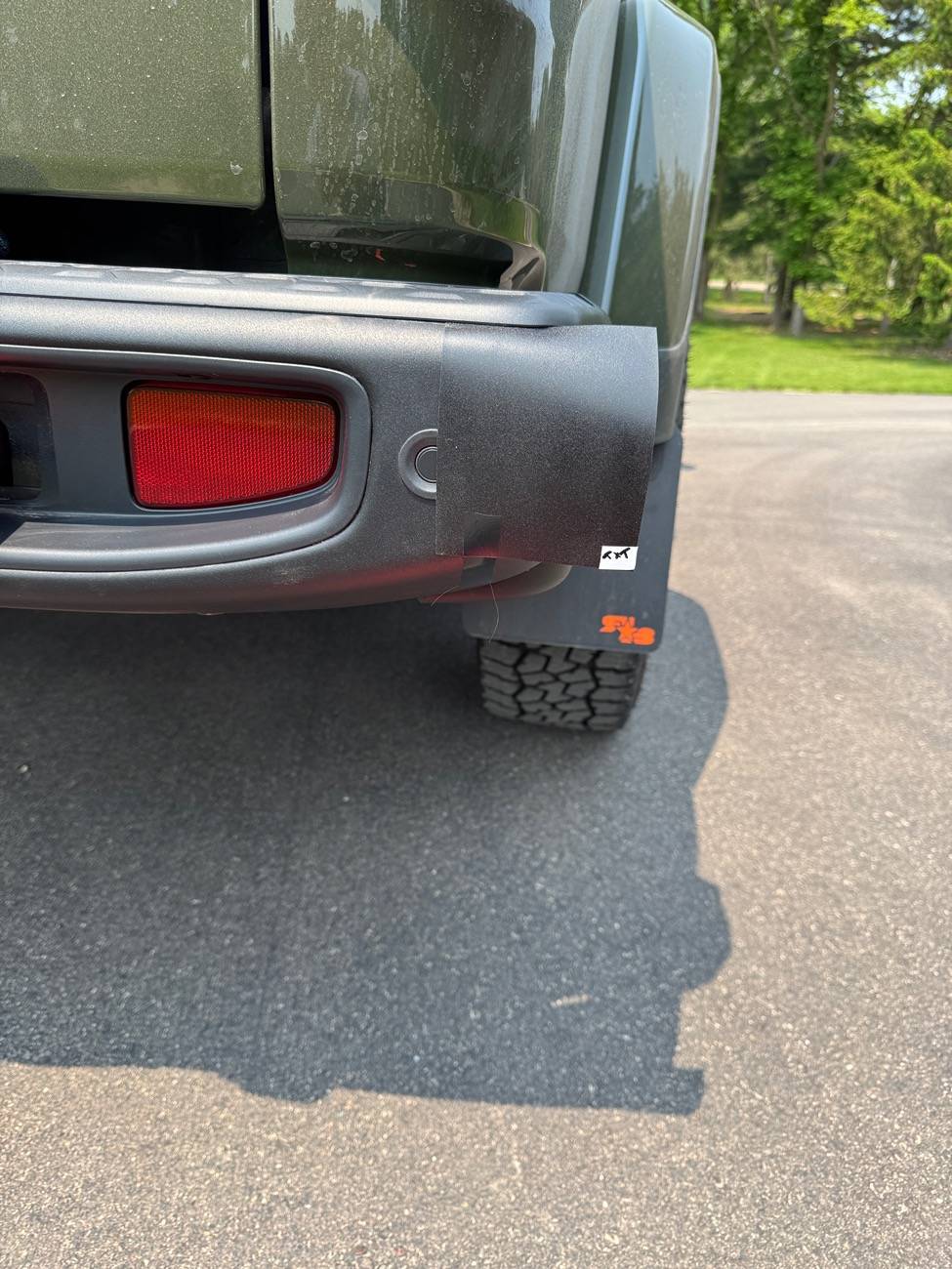

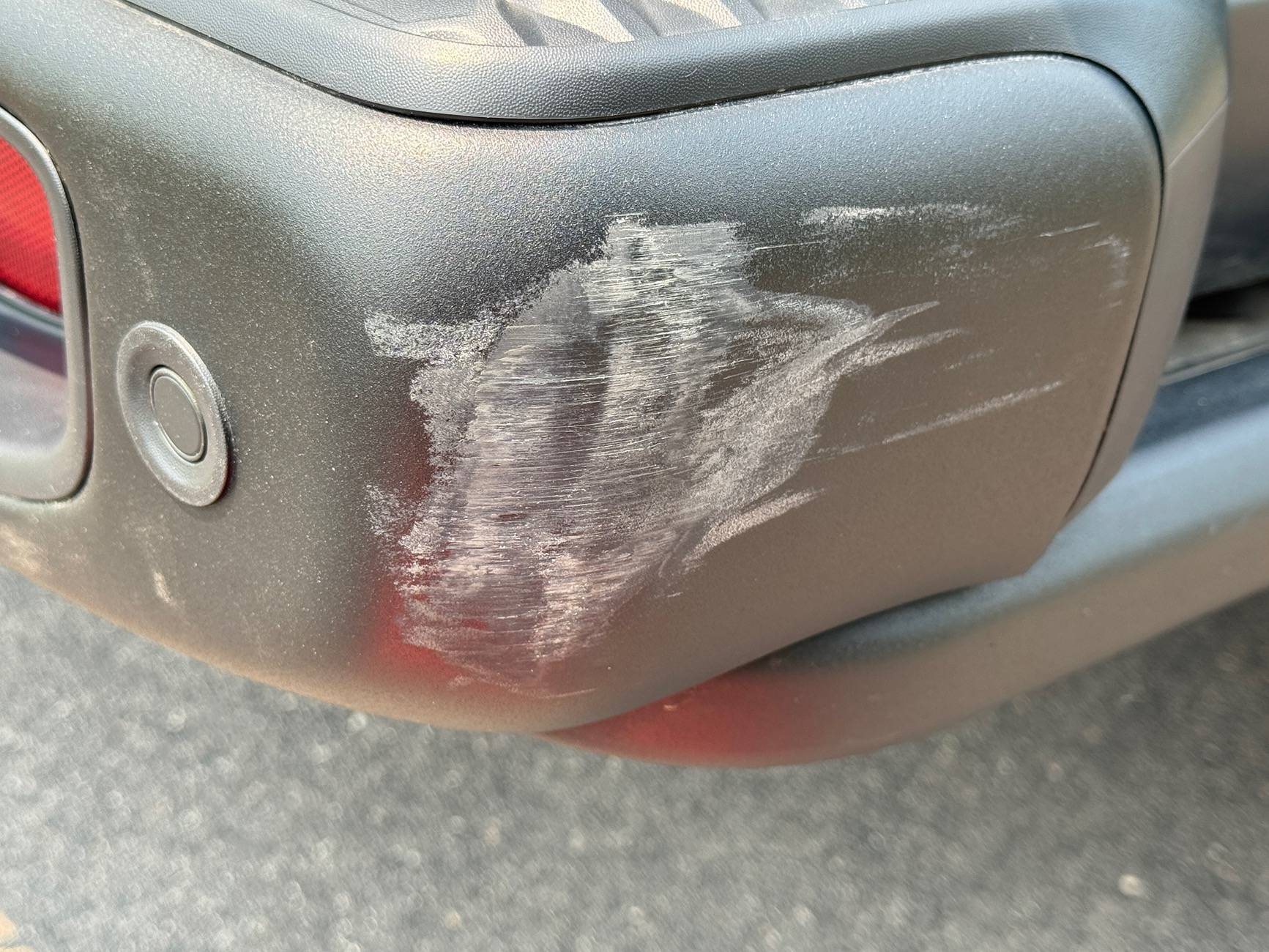

Someone cut a little too close to my bumper and left a large scuff. I am guessing he got the worst of it, however;). Some of the scratches were deep, so I would have had to sand down to metal to actually smooth it out. I decided to go with just painting the surface--turned out very acceptable.

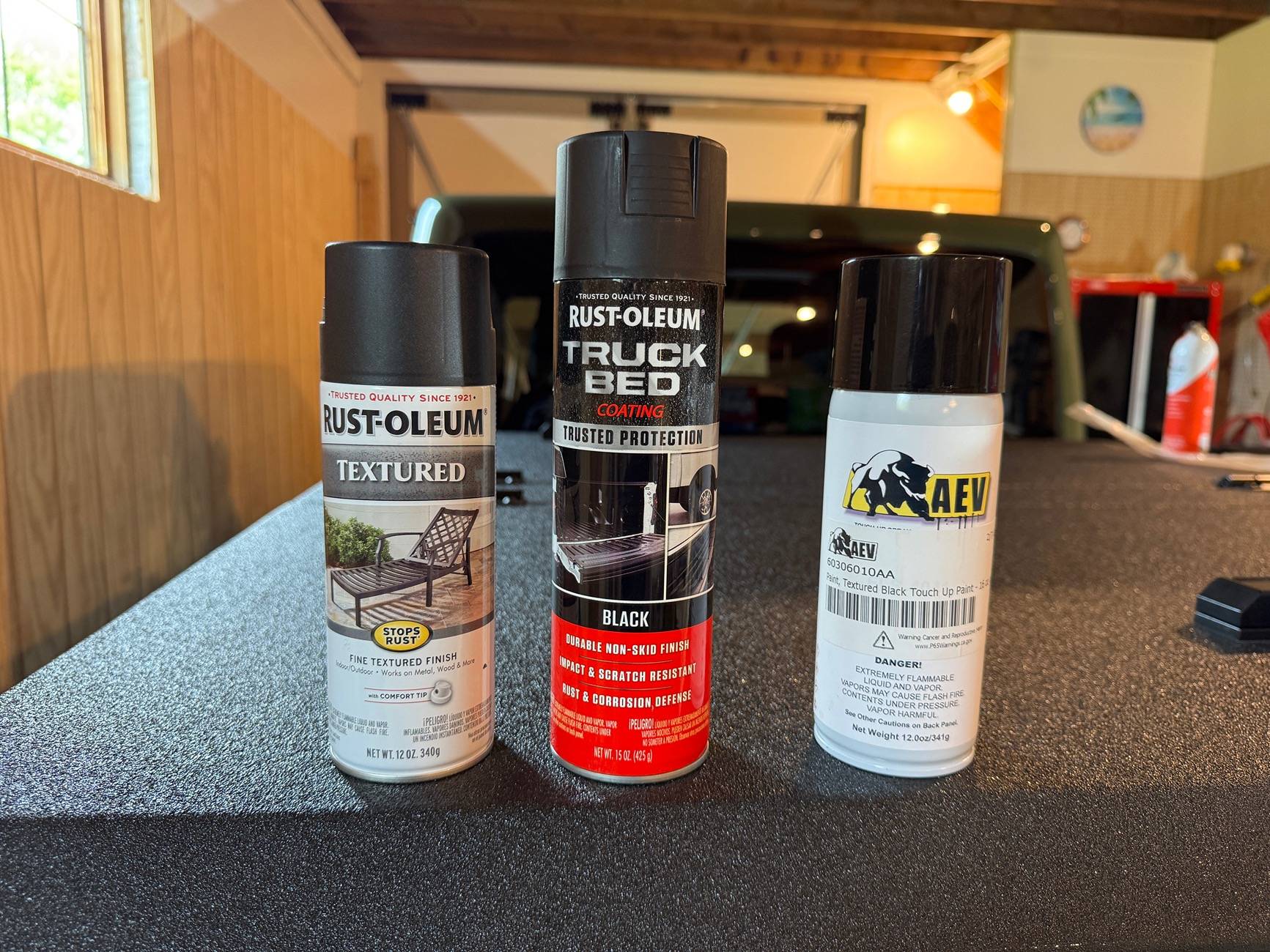

Looking thru various forums, I saw three main candidates for paint. I had one of the Rustoleums already, so I bought another as well as the AEV designed for this.
Short version: Rustoleum Textured (black) worked great.
Here are the paints I compared.

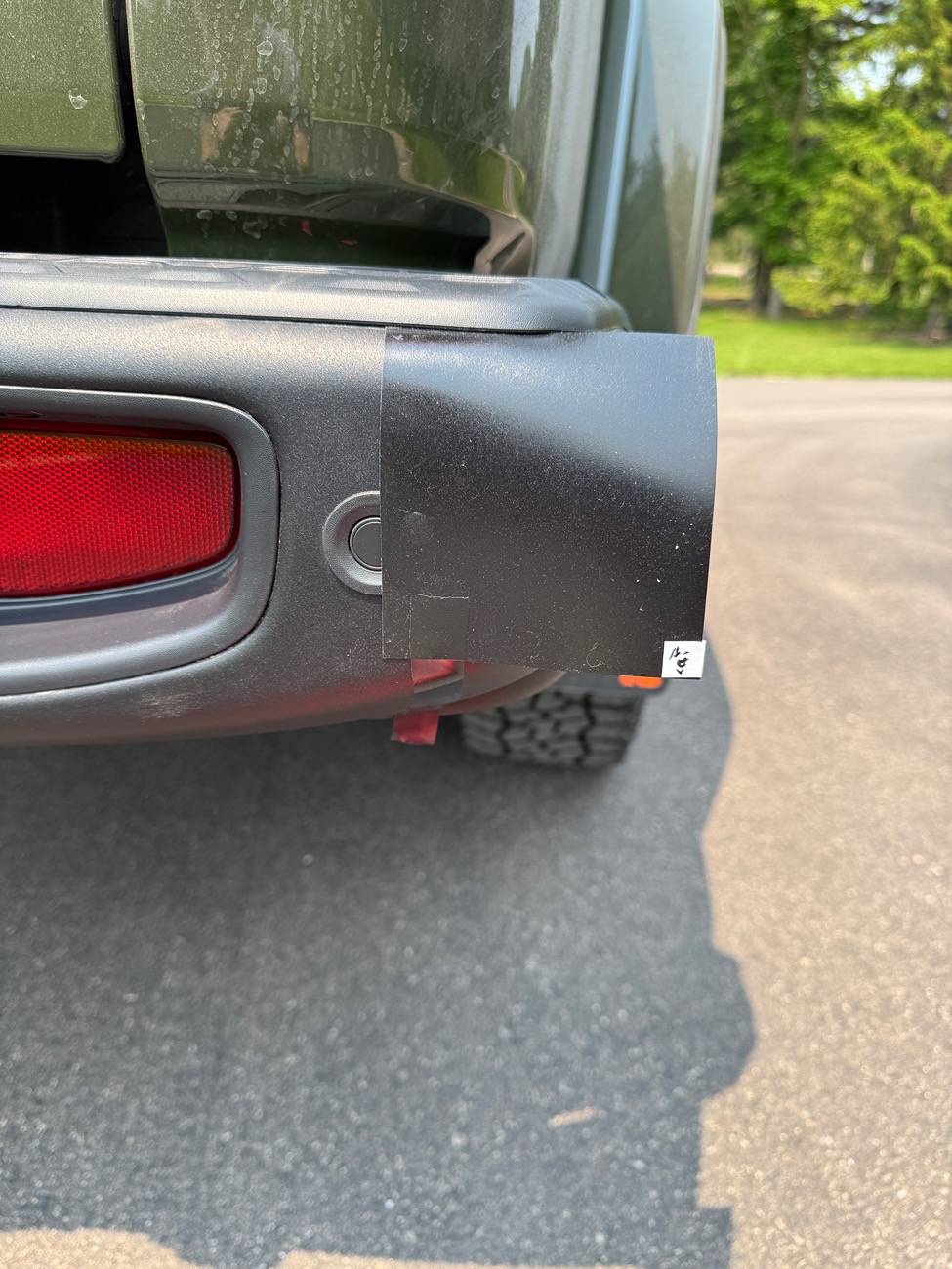

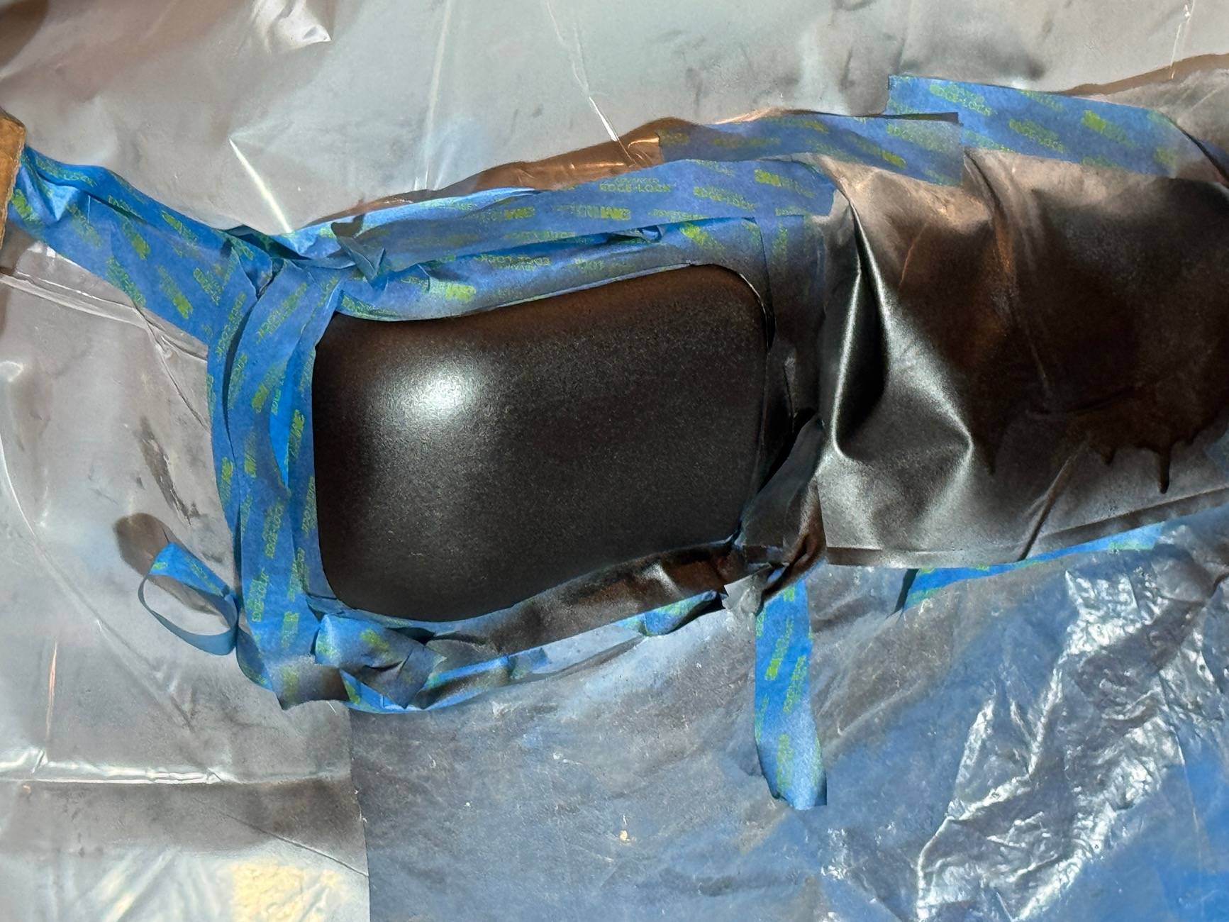

I taped some black plastic to cardboard and sprayed it to get some samples for comparison. While it was a bit of a challenge to photograph, here are the samples next to the bumper. In person, the choice was pretty obvious; RustOleum textured was really close. TruckBody was too coarse, and the AEV was a little too shiny. All would probably be acceptable, but the Textured was the clear winner to me and a couple others I showed the samples to.
For comparison, here are the samples:
RustOleum Truck Body:
AEV:
RustOleum Textured:

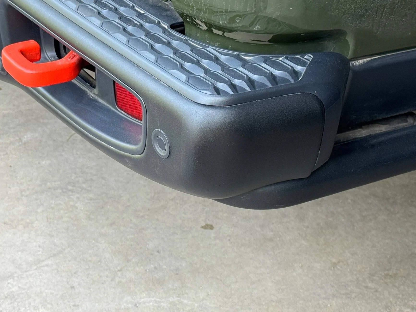

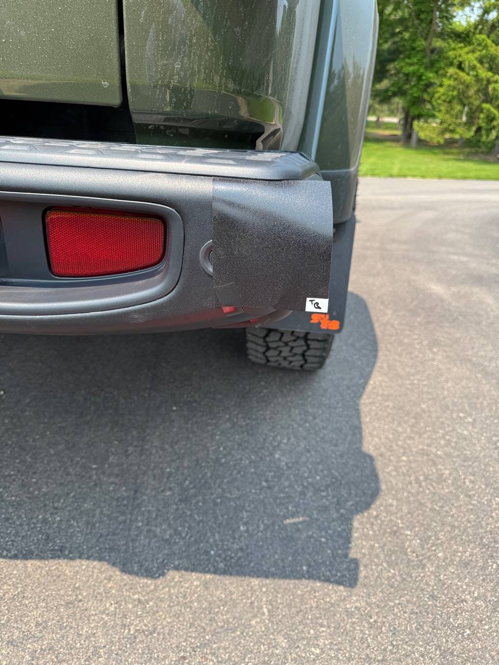

So here are the before and after. Quite an improvement!
I went with 3 light coats.
