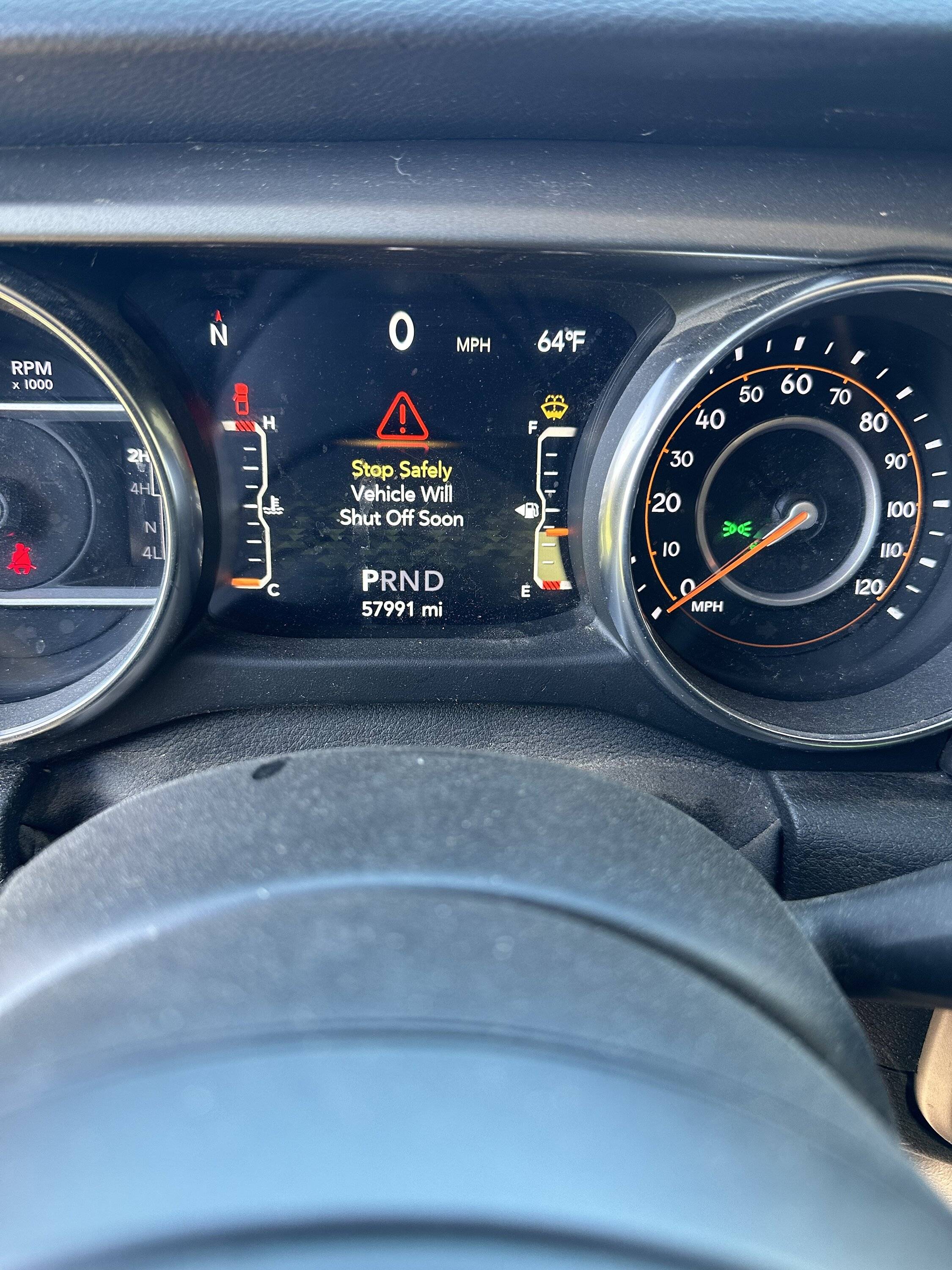

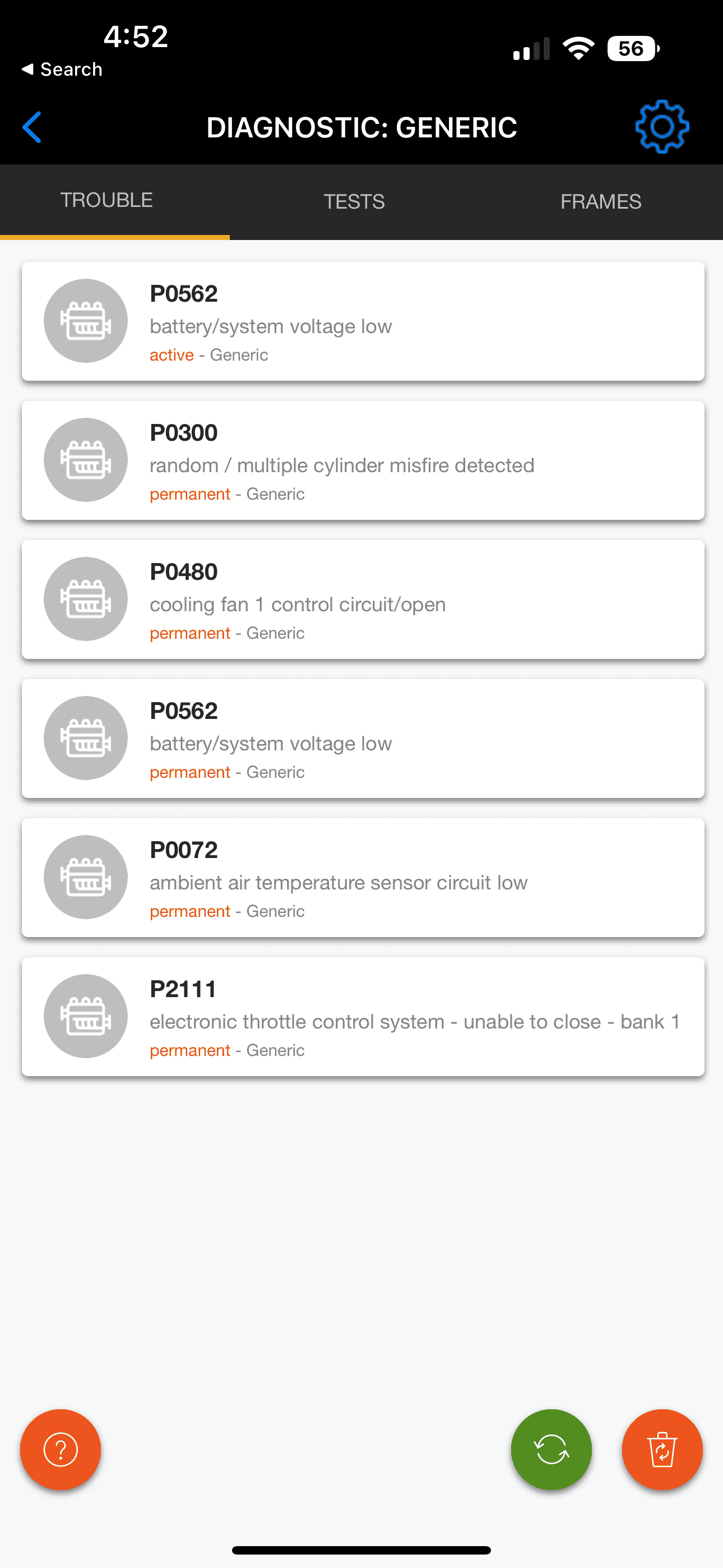

Hey gang,
so I have a 2021 JT Willys. 58k miles. Started having idle issues and the dreaded “check engine” light came on so I took it to the dealership (yuck) and had them diagnose it. They came back saying I had the dreaded P0300 multiple misfire code pop up. They kept it for a day only to call me saying it needed new plugs, new alternator and both batteries replaced.
I picked it up and did the alternator/batteries swap myself and gonna have a trusted local shop here replace the plugs.
I was excited the gladiator fired up perfectly after installs, butI now have multiple addition codes. I also get amessage the start/stop is not working, battery power is low AND a scary warning saying to park safely because the vehicle is about to shut off. Anyone ever experience this after doing the batteries and alt swap? Thanks in advance!

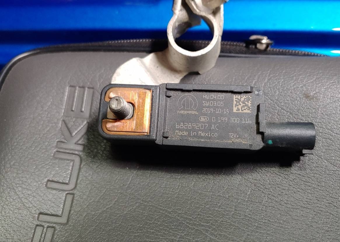

The IBS is the sensor attached to the negative post of the main battery. Pull the cable off the positive post of the main battery. Make sure it doesn't touch anything under the hood. Connect the charger to that cable and the negative terminal to charge just the Aux battery. Charge the main battery using the negative terminal and the positive post. A standard AGM charger that runs the battery through the charging cycles is best. A trickle charger is okay, it will just take a little longer.

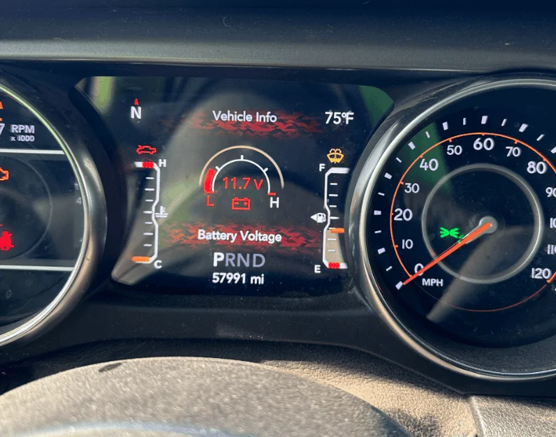

If this picture is with the truck running, you have serious issues!
It means you've blown something like one of the high current fuses, or your alternator is crap, etc.
That's not due to a low or bad battery, that's due to a bad alternator, bad install, I'd even lean toward you having blown the high current fuse when doing the replacements.
If you didn't pull the negative cables off the main battery and separate them and keep them from touching anything, then you likely have a blown fuse. You must take them off the IBS, which sits on the main battery negative post, then take the two cables apart. Otherwise things are still hot.
Jeep Gladiator Codes after alt., main/auxiliary battery swap. 1680409365916
This is the IBS -
Jeep Gladiator Codes after alt., main/auxiliary battery swap. 20220329_093938
but seeing that voltage tells me - you've got further issues than a low battery.
Bottom line -
Alternator is toast
or
you blew the high current fuse by not taking the cables apart, preventing them from touching anything and the hot cable touched ground, blowing the high current fuse.
I'm quite shocked that no one jumped at that 11.7 volts with the truck running. That's not an aux battery being low issue, IMO. The thing is screaming low voltage.
Even with a dead aux battery, there will be power from the main battery to keep it from reading that low. Looks like the whole truck is having to run off the batteries because the charging system isn't working.
(cooling fan circuit is part of that high current fuse)
