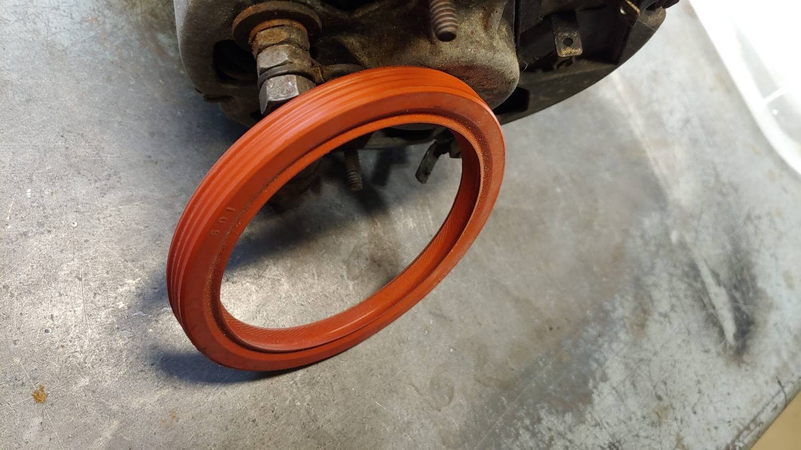

Are these a full circle endless seal (picture) or a seal in two halves?
I'm betting the latter since you can replace it without pulling the pan.
Anything else requires the pan be dropped and the rear main cap be dropped.
It is a one piece seal that is bonded into a metal retainer. It is possible to pull it without dropping the pan, as I noted above, but it is not the factory recommend procedure. Overall, it is a much better way to seal the crankshaft than the old two piece seals we had in the 4.0. But my favorite crappy seal design was the one piece seal that superceded the neoprene two piece seal in the GM 2.8 V6 in the Cherokee back in the eighties. To be honest, I hated those engines anyway.
