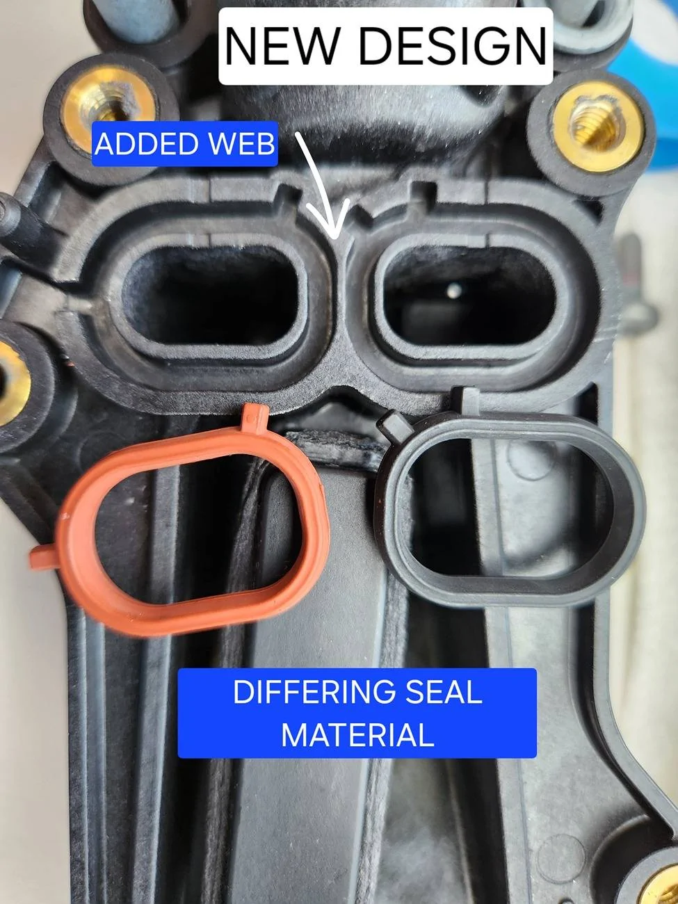

This is the new Design, I think on another thread it came out during 2023 - would have to check your vin and build sheet....etc. (Benny may help or you gotta go to a dealer).
68596318AB - New design has more barriers to prevent leakage.

I took my original apart and it has the divider between the O ring. As I said my Jt was built 5/22 hence its a 2022 and came with the new style and thats not the area where most have a leak. It seems to be at the base not where the picture shows. The Dorman did not leak between the cooler and the housing either. Do some searching here and the Jl forum , same deal. My new OFH is no different than the one mine came with. Its normally just O rings. For $125 more I was not chancing a problem I could not see so I swapped the whole thing at the time

The O ring on the inlet pipe on the bottom is a black 23mm od / 18.3 mm id on 22 which is newer OFH. Red 22.3mm od / 17.5 id on 2021-2014 O ring. It comes with the black O ring installed.
That is interesting - idk the research I have been deep diving on - two reasons Mopar did the plastic/aluminum mix on their cooler - Cost & Temperature. Modern Plastics tolerate temperatures a lot better than they used to, and a lot better than basic metals - it also allowed them to save money -is it perfect, no a human made it a human will figure out how to break, only to improve it again. So when your wheeling in the hot desert and then run through some water sudden change in temperature causes expanse and retract - metal will break - modern plastic will tolerate it longer/better have a higher threshold before breaking.
