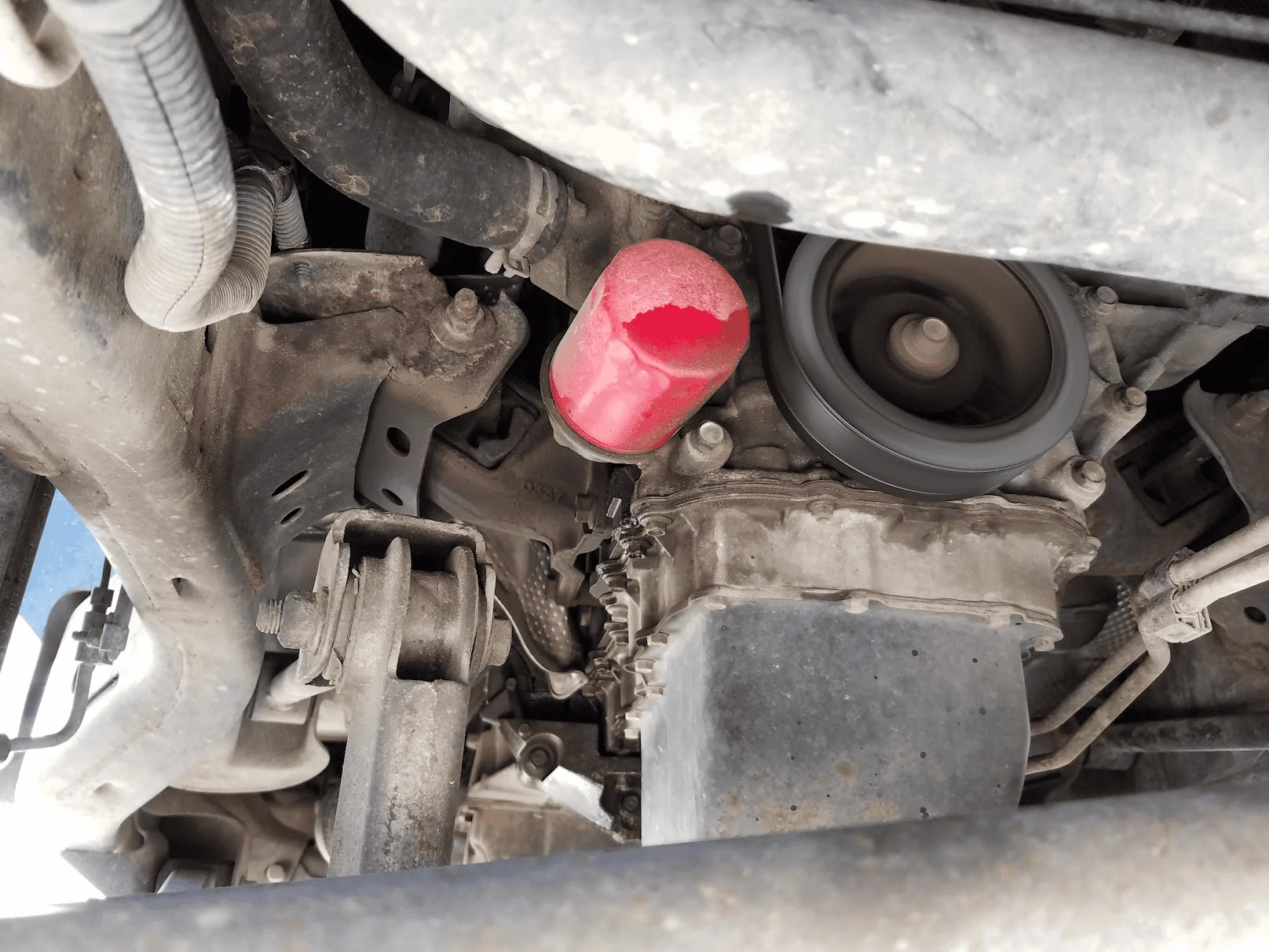

Has anyone else found a leak from the front of their Gladiator? I started noticing it right after the last oil change and it looks like its coming from the front of the engine because I can see oil around the front of the pan and on the front differential
I wonder if the oil fliter gasket isn't bad since its located near the front but cannot really tell and just figured out it was my vehicle leaking. The dip stick still shows oil on it but I cannot tell exactly how much
With no warranty I guess i will diagnose on my own LOL
I will see if the dealer is open tomorrow and see if they will look at it since they changed the oil and there was no issues before hand. I just discovered the thread talking about broken filter housings
In my experience, that's usually due to the person refilling your oil spills some, it runs down the engine, and you see a puddle in your driveway.
I had valve cover gaskets replaced under warranty around 35,000 miles
