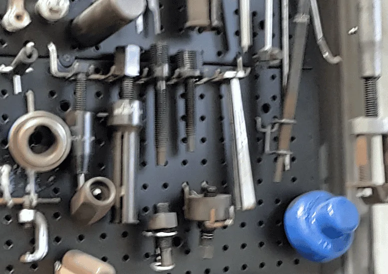

Others are located (for proper balance) by a key in the crank's nose and are also retained by a bolt and heavy washer with decent torque to secure it - but are a mild press fit as well.
Would be interesting to know the "why" of the differences. Maybe less weight on the balance of these?
The balancer for a typical SBC, like a 350 is something like 9 or 10 pounds (unless you are talking a racing balancer)
The harmonic damper on a Pentastar is only a damper, all the Pentastar engines are internally balanced. Many older engines also used the damper as a balance element, especially in GM engines. Chrysler traditionally balanced it's engines internally, it was a rare old Mopar that used external balance. As for the press fit, the Pentastar engineers decided that it wasn't necessary since the damper wouldn't be used to as a balance element.
You just made me (possibly) so happy... I've been working on the 3.8L's for 15 years - knowing that the 3.6 isn't a press fit just made my day. Or, at least will make my day the day I need to change a crankshaft seal on one ?

The problem with using the same bolt to pull one on is that you are only gripping the outermost threads, not a lot of strength with only a few threads.
That... and that you're putting a hell of a lot more torque on that bolt (and threads) than what it was meant to handle by trying to press one on that way. You're literally grinding the threads right off.
The "static" force of a jack-screw against those threads (whatever the right term is) is a lot less likely to strip than trying to put 100+ ft lbs of torque on one of these to force it on - and, to your point, only using a few threads of engagement to do so.
That flange bolt is only meant for 40 ft lbs on the 3.8. I assume it's something close, or even less on the 3.6.
You must really deal with PRESS FIT dampeners..... I can't recall one that took that much. But then, I can't remember every single one of them, either!
once messed up, getting proper torque is difficult and they've lost strength and integrity.
Either way, the correct tools make the difference. or - make your own tools.
