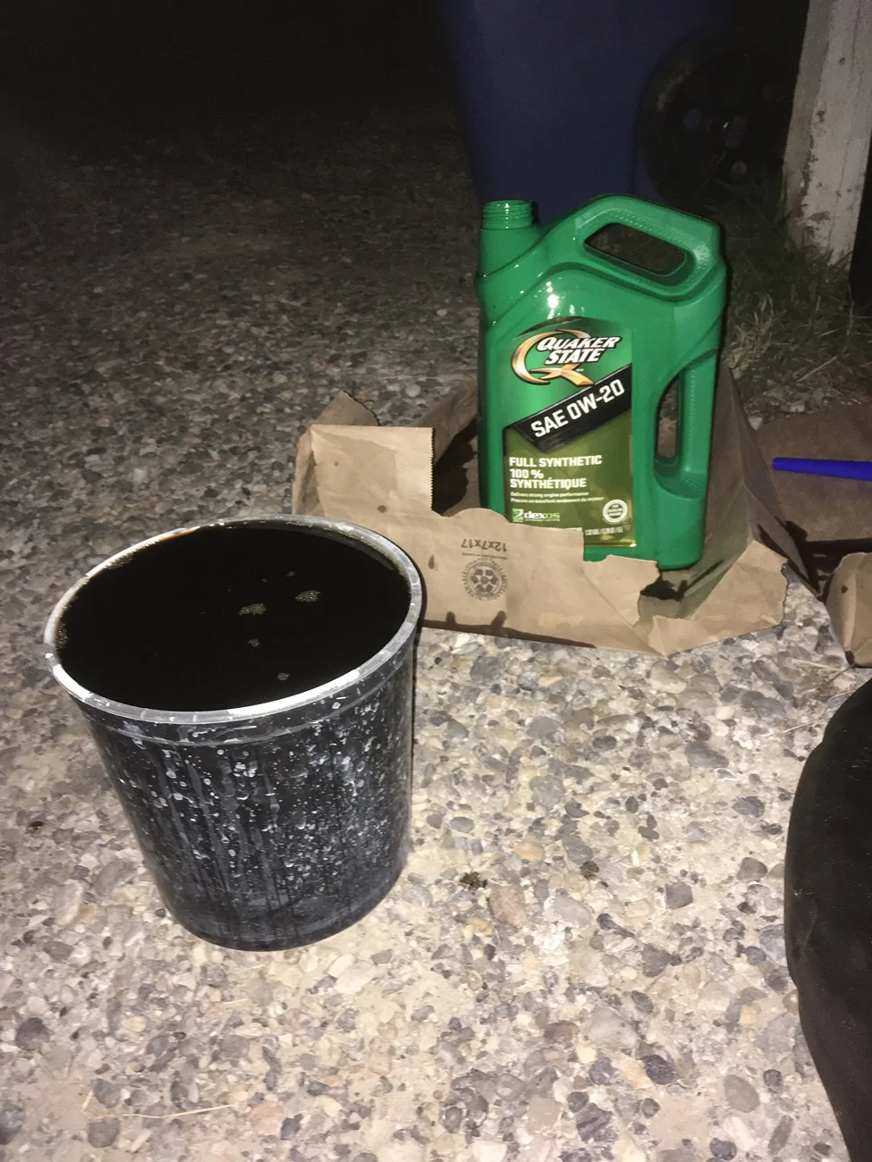

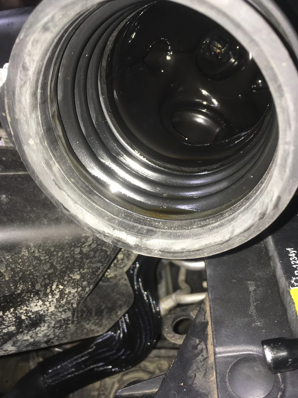

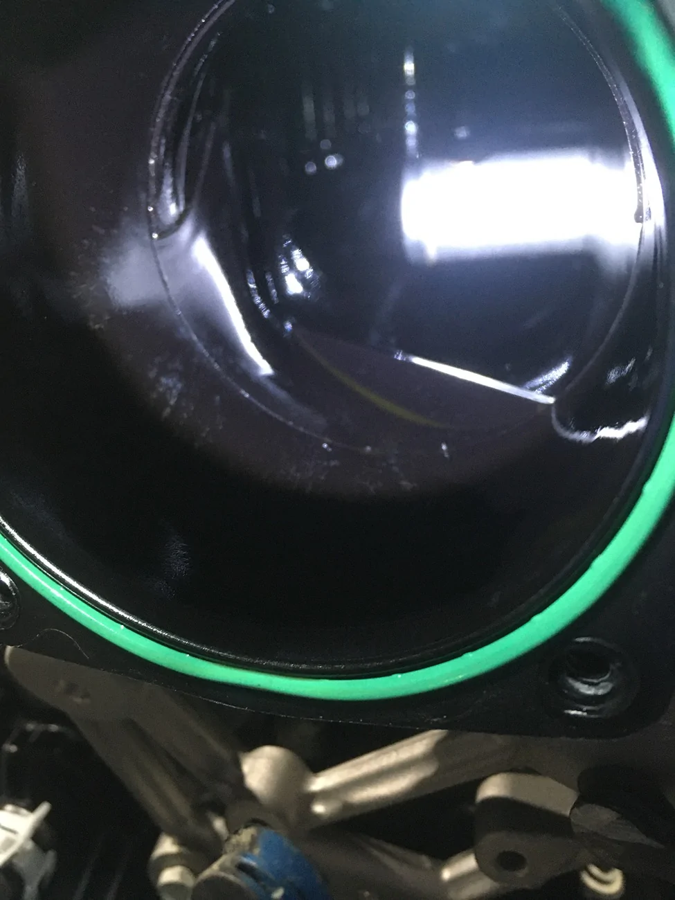

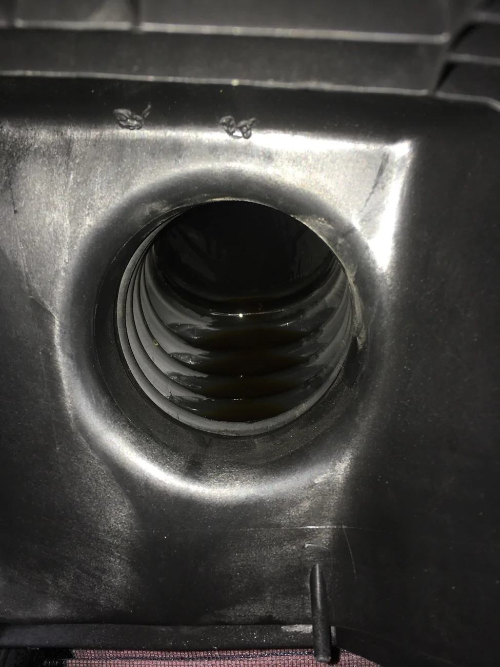

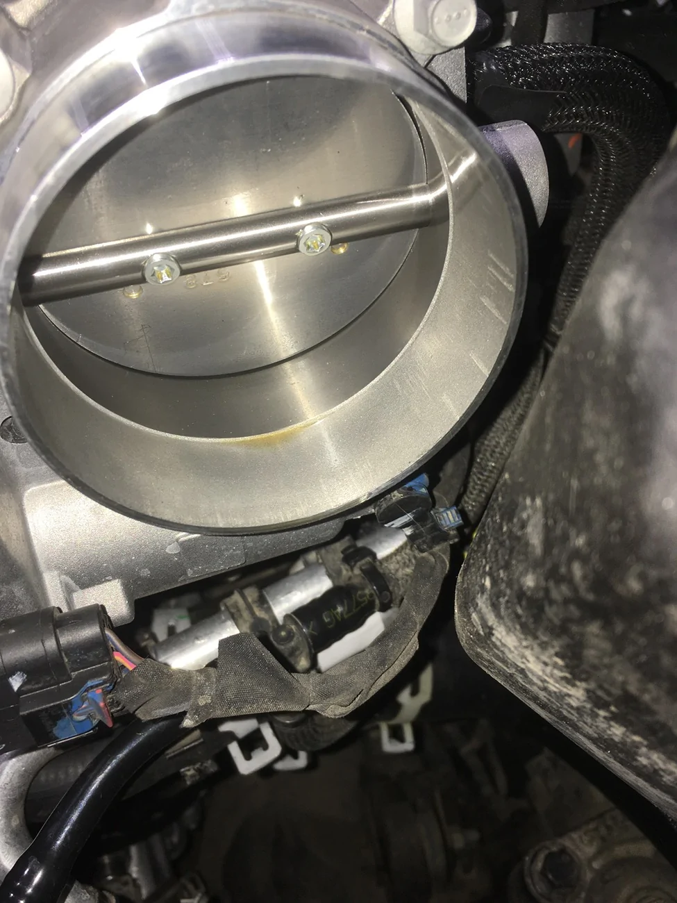

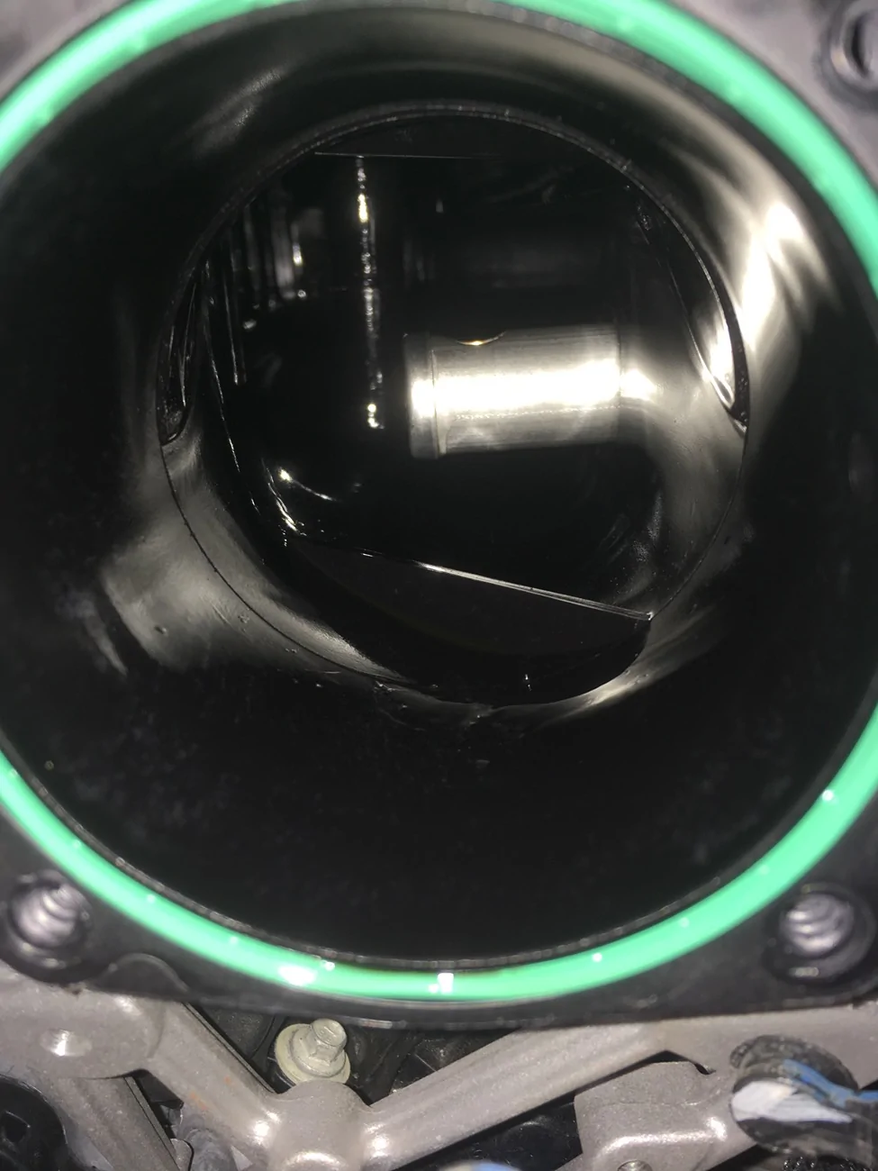

My new replaced second 3.6 engine had 12L when picked up at the dealership. Drove 1567 kms (973 miles) to BC from Alberta, summiting at least 4-5 mountain passes there and back. I left Calgary on the Friday and came back on Sunday. Would hit speeds of 120-130 kms/hour (75-80 mph).
Have put on nearly 100k kms (60k miles) since then, no seal leaks.
Sure made a mess of things in the intake though, but so far, nothing catastrophic resulted from the error.
Jeep Gladiator Can an extra oil quart cause a seal leak? Here's some facts - 68654225759__423E933B-B4E3-4AE9-8231-DE73FF6B9AD4
both bucket and oil jug are filled to the top with what drain out.

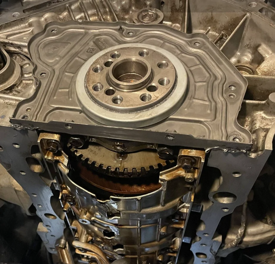

That pressure has to go somewhere.. yea. Good by seals
No no no no no no , How do I know this . I have admitted to this before I run extra oil in mine have since Day 1 why ... I work in super steep territory it often reaches 18%-20% grade lots of Mud & spinning etc.
I have 132k on mine looks at the pic the windage tray will control the oil and prevent frothing. Up to 1 quart over.
Am I doing something not recommended yes , Has it blowed my seals in the last 132k miles Nope will it blow my seals Nope . Why cause the only way the seals will recieve pressure like what your saying is if I stuck a air compressor hose in some port going into the engine and forced all the contents out. The pressure in an Engine cause by blow by from the rings is negated by the PCV valve and channeled back into the intake plenum.
I have owned mine for 4yrs. 9 months and I can promise you 1 quart over aint gonna do jack crap.
