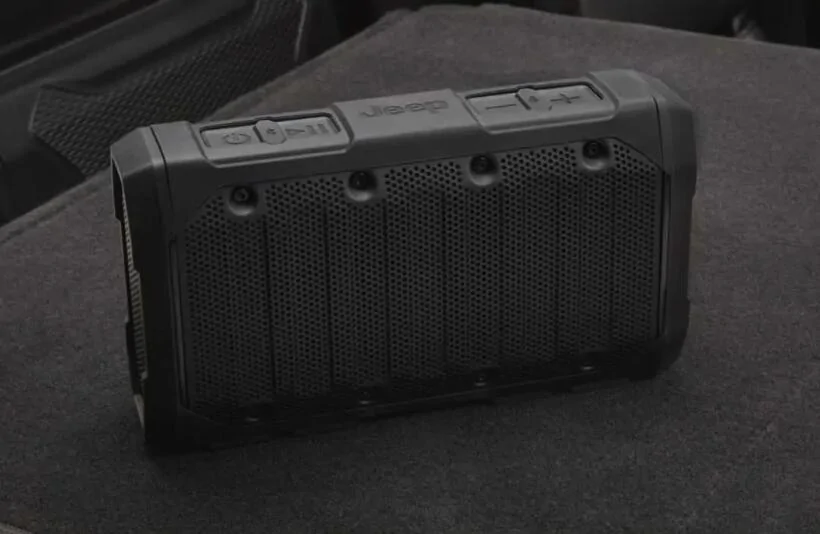

I remember I read somewhere you could do that in like a party mode or something, has anyone done it? If so, how?

I have some Bluetooth Speakers that allow this. The manufacturer instructions tell how to link the speakers to each other. I don't know if the Jeep speaker has that option.

Yeah I have a couple that work that way too, my brother in law has a another jeep speaker, so I was wondering if those have that function too. Im not even sure it its possible, I probably dreamed I read something about it...I dont know

If I recall it's more of a limitation of Bluetooth than anything. The speaker would have to allow linking and I'd bet a quarter pounder with cheese meal these don't.

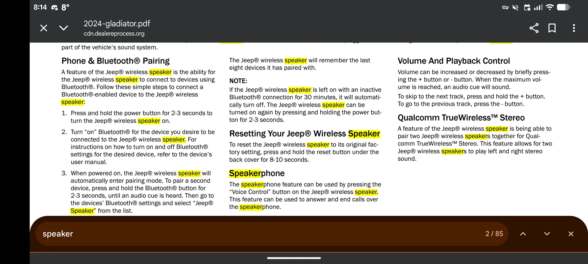

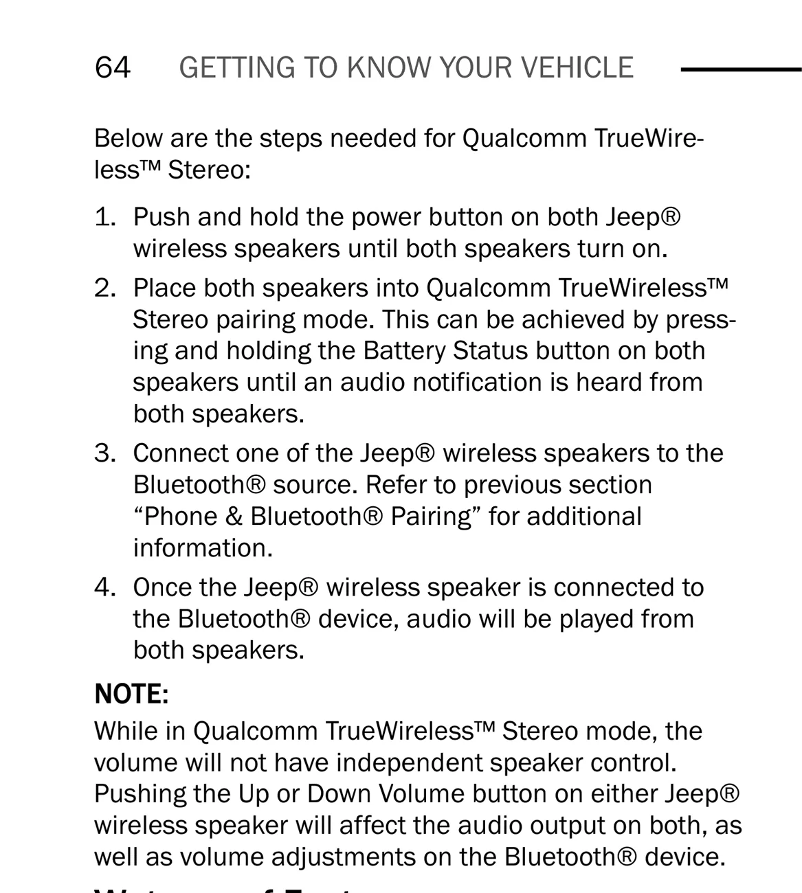

There's some incorrect information here.
This is illustrated in the manual.
Press the "battery status" on each speaker until you hear a notification. Then pair one speaker to your device.
Attached are screenshots from the PDF manual. We did this over the weekend.
Jeep Gladiator Connecting 2 Jeep Bluetooth speakers (The portable ones) at the same time? Screenshot_20250903-081452
Jeep Gladiator Connecting 2 Jeep Bluetooth speakers (The portable ones) at the same time? Screenshot_20250903-081518
