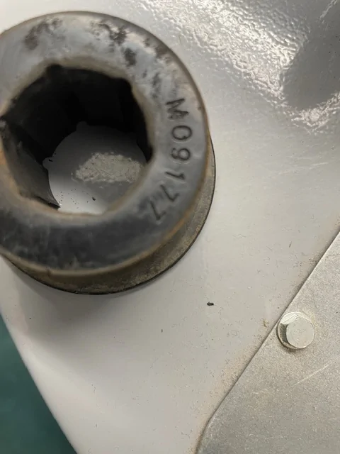

My latest project was to install some MC control arm skids on the front. When I pulled off the lower control arms (aftermarket, they appear to be similar to BDS non-adjustable ones, but not sure on that. I am the second owner) these were the bushings that were in them. They are worn and I thought they would be easy to find replacements for.....lots of searching but no joy. They have the part number M09177 on them. Any body have any ideas? I tried BDS website, they show fixed length front lower control arms, but do not show replacement bushings. I emailed them but am waiting for reply. They may not be BDS arms. There were no grease fittings on the arms and no grease in the bushings. Tried cross-referencing them with Moog, but no part number like this came up, or on google.

Well, I was finally able to determine what lift my Gladiator's previous owner had installed. It is a Daystar KJ09188BK 2 inch lift. The part numbers on the control arm bushings are still good numbers and I have some coming direct from Daystar. ( 5 dollars apiece ) The lift install instructions tell you to lubricate the bushings prior to installation, this was not done when the lift was installed and I think that is why they prematurely wore out. We shall see, since the DS lower control arms do not have grease zerks. Maybe I will try to install zerks when I replace the bushings. Funny that when I googled the bushing part numbers M09177 in several different ways, nothing came up.
