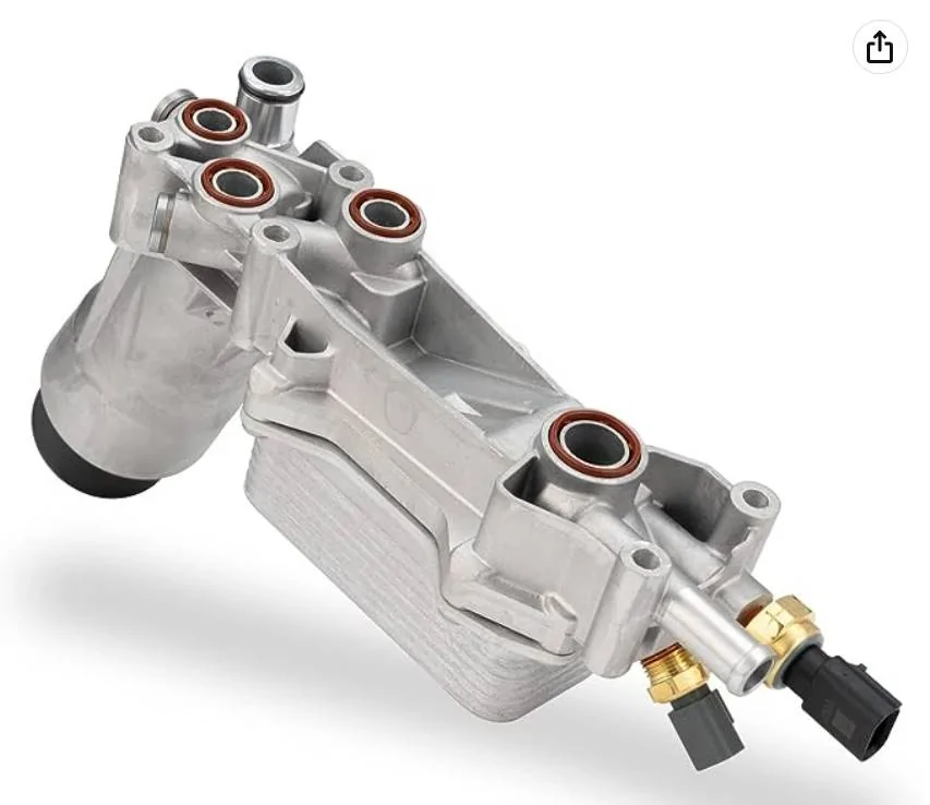

Yes. the 3.6 has an egr which coolant does run through it, but coolant actually runs through the oil cooler itself. The oil cooler has multiple ports on it. All of the ports have o-rings. Two of the ports are for coolant flow which keeps the oil cool.
Earlier this year when I replaced the oil cooler in our JK, I didn't release the pressure from the coolant system and coolant leaked all over the place.
I'll attach a pic of the underside of the oil cooler.

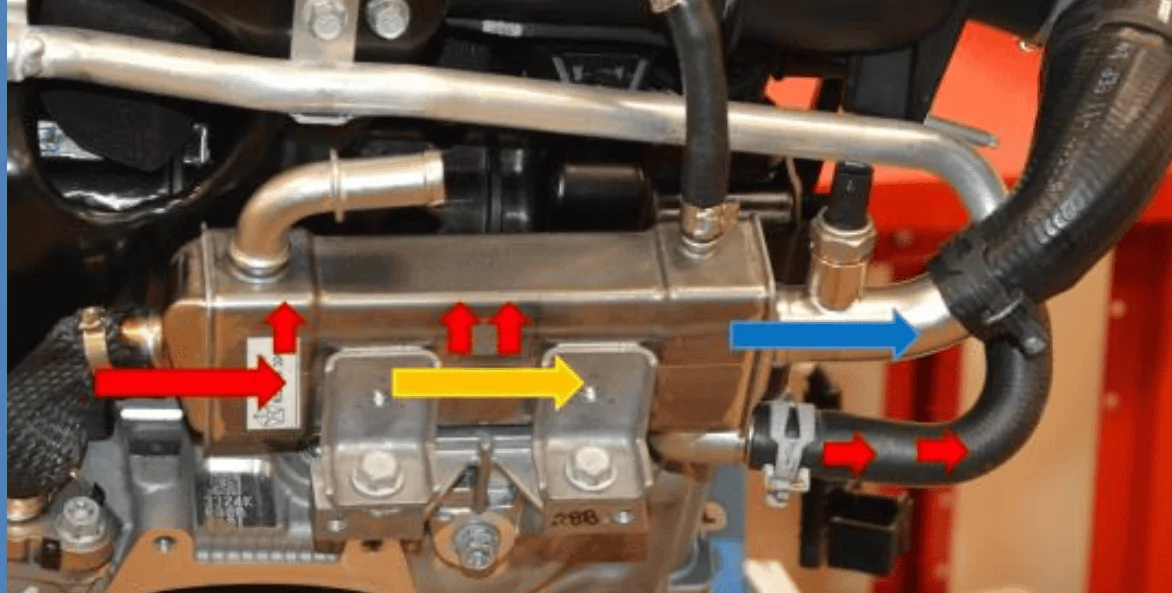

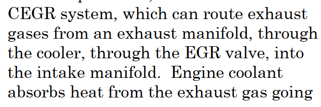

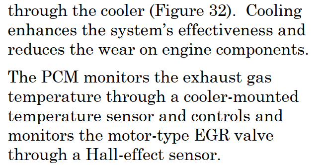

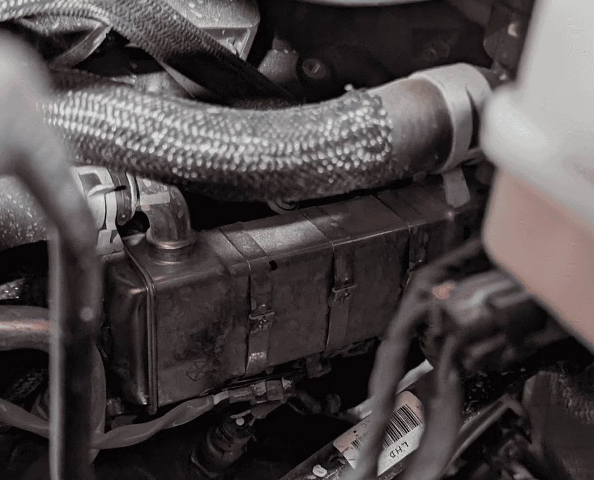

JT cooled EGR for anyone wondering where it is........recognize that white tank there on the right?
Jeep Gladiator Coolant and Overheating 1690076623461
Jeep Gladiator Coolant and Overheating 1690076765718
Figure 32
Jeep Gladiator Coolant and Overheating 1690076827934
Jeep Gladiator Coolant and Overheating 1690076863906
