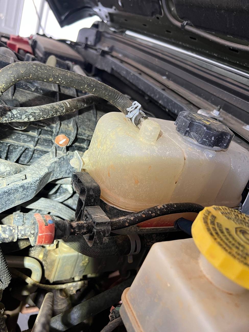

Should I add coolant to the reservoir when the engine is warmed or cold. When warm the level is low.

There should be an indicator on the side of the tank showing the level when cold. It doesn't need any added until the cold level goes below that line. If you add any, make sure it is the correct type.

If it’s at min cold I can add to max correct?

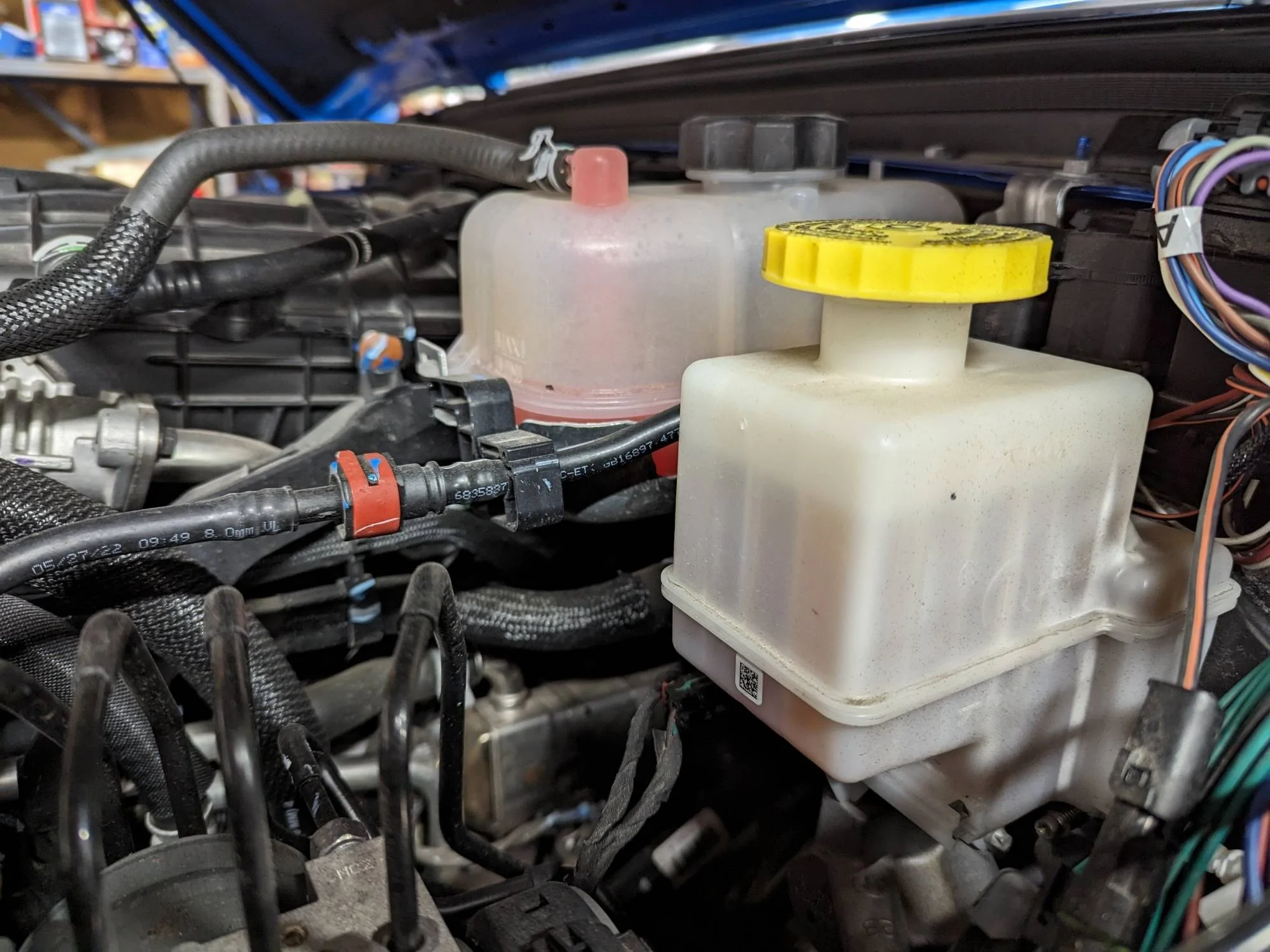

Fluid levels such as brake, power steering and coolant are "cold" levels.
And it will vary with the ambient air temperatures - it will appear lower if it's 20 outside than when it's 80 outside - engine off and cooled in both cases.
I make sure it's in the middle engine off, cooled down and air temps outside in the 60-80s or so. In other words, engine off for several hours, moderate air temps.
