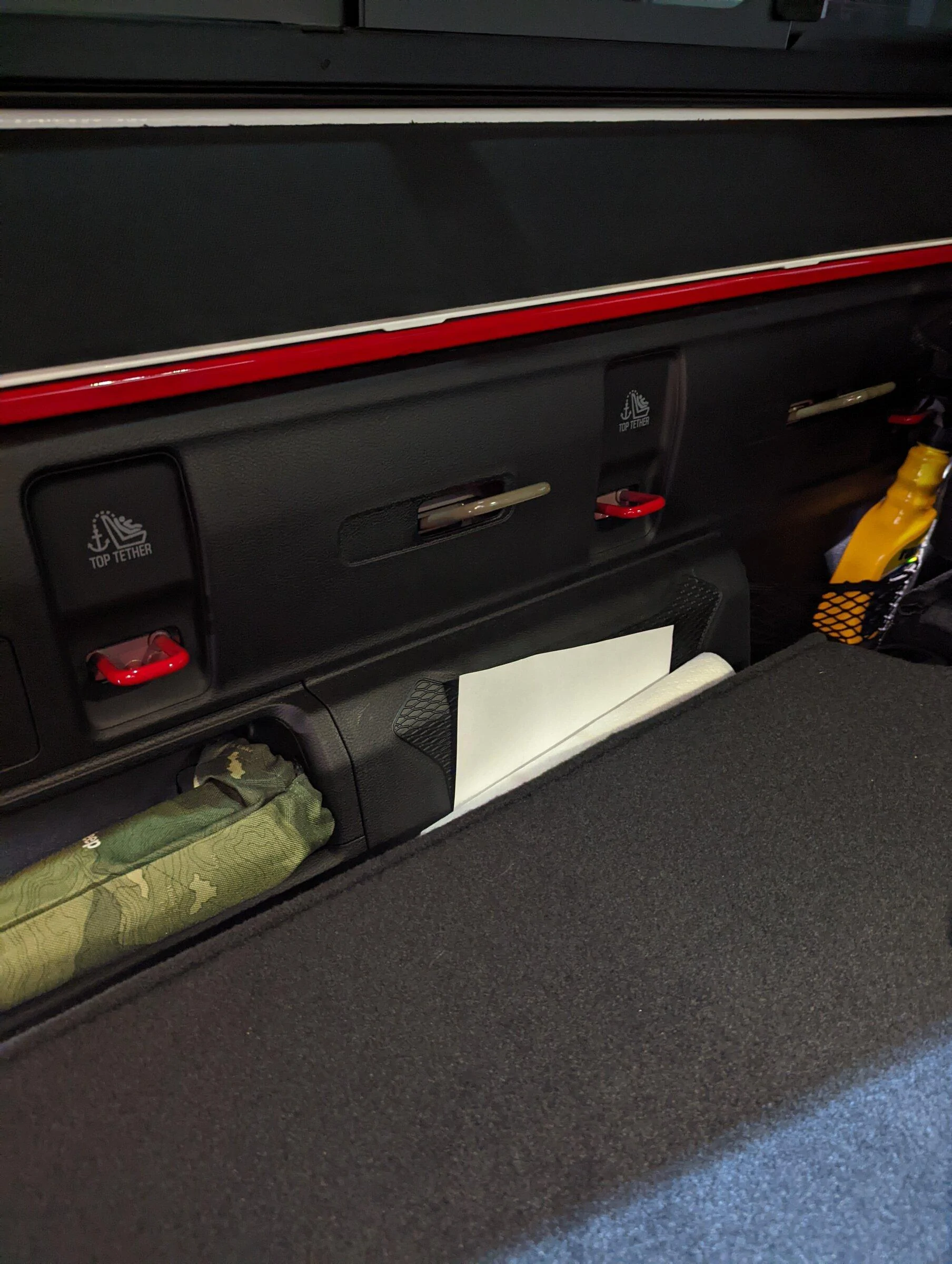

I paid big bucks for the Alpine sound system.
At 2000 miles it developed a bass rattle.
Man was I pissed! So I did a search and read about all the causes. Today I went looking for a general area to narrow it down because new a dealership would be unable to take care of such a technical problem.
This is what I found, a piece of paper stuck to the bass speaker behind the back seat. I am so glad I didn't make an ass out of myself... Again ?

Just an FYI - I also notice a rattle when I have the rear sliding window open and I crank the Alpine system, especially songs with much bass. It took me a while to identify it at first, but once I learned that's what it was, I learned to not leave the rear window open as much.

Same here! Going to try to figure out something this summer to make that stop.

If I hear a rattle, I go to YouTube and pull up a tone sweep video. It starts at like 15hz and slowly runs up to 20khz. Its a great way to sweep a room or a car for buzzes or rattles.

There are audio-only sweep files available, too.
Stick it on a thumb drive and play it back without having to have video.

Had a similar experience with the premium alpine system in my '20 JT. The Torx bit had slipped out of the tool kit and was rattling around in the plastic molded tray next to the sub. I was looking at infinity aftermarket speakers before I discovered the cause...?
