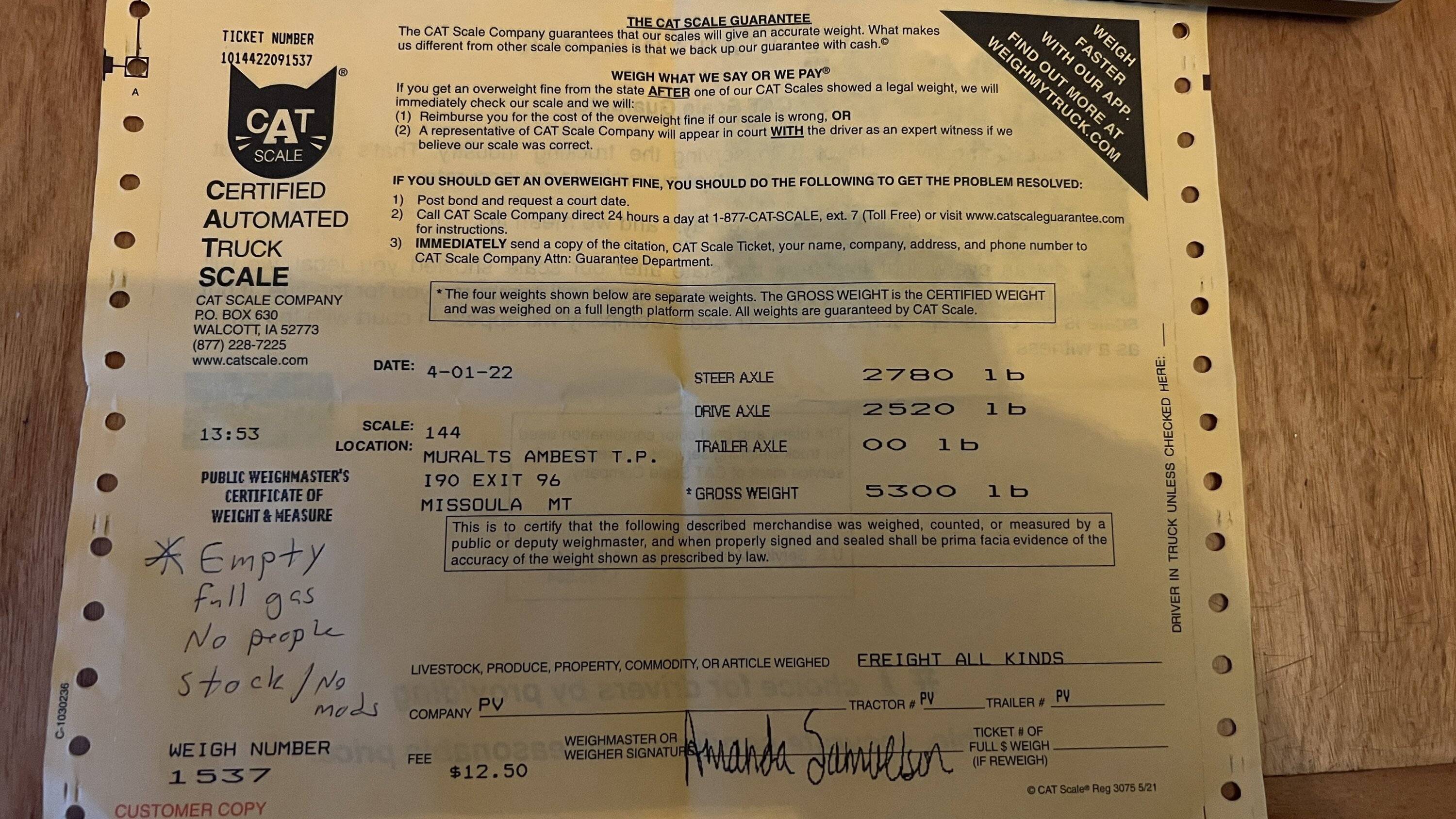

If you want accurate weights, go to a certified scale such as CAT - although they are designed for semi's they do work for gladiators - as long as you try and make sure the gap between front and rear scales are at the midpoint of the truck.
Here's an example of mine when new with no accessories.
Jeep Gladiator Curb Weight (and balance) on scales Weights - stock - 1 Apr 22
I find it very interesting to note that although @mog (op) had a lighter scale, which is weird, than I, if you do the math, we both have the same weight distribution - well I am 1% lighter up front.
My configuration when new:
2022 JTR 3.6
RocTrakc 4:1 diff (NOT the full time option)
Hard top
Factory tonneau cover
Steel rear bumper
Plastic front bumper (steel frame)
33" Falcon Wildpeak tires
All options except advanced cruise control which also gives bumper sensors

Thanks for the quick response.
Wow.. only $12.50.... thats lower than I would have thought... but probably more expensive now that everything has covid/biden tax added to it (ha ha).
When you say center line, your not talking about weights/balances or anything right ? Just pure physical length ? I.e. measure the length of the jeep(bumper to bumper) and devide in half ?
* I see it on paper, but it's still hard to believe the numbers are so close, I'm sure mine will be somewhat different being a diesel though.

Yeah I went off the bumper to bumper centerline, not the midpoint of the wheelbase. The reason was purely for consistency and to try and get the wheels spaced evenly over the two scales as much as possible since the scales are huge and meant for tractor/trailer combo.
Since the scale works off the wheels or axles, it won't matter to the scale. The scale can't see what's above just the weight pressing down on it.
I recall weighing grain trucks and they wanted the truck on the center of the scale and they stopped you when your truck was centered. (WHEELBASE-WISE, not body)
They wanted the front axle the same distance from the front of the scale as the rear axle was from the rear of the scale at the elevators I sold grain to. I'd hope it wouldn't matter but..........

Proven the front of your truck is 260 pounds heavier. That makes sense considering where the weight of the drivetrain, heavy windshield frame, heavier front axle, etc. all are.
Looks like most are around 260-300 heavier in the front.
Take that red line in my other picture and you've got 260 pounds more in front of that line than behind it.
Move that red line forward just a bit to get the weight equal on each axle and then that's your center of gravity. Doesn't matter a lick what's sticking out behind the rear axle.
Your center of gravity is ahead of the center of the wheelbase front to back. Roughly where you sit.
If the truck was to spin like a top, you'd almost be the center point of that spin.
Yes, a Gladiator is heavier in the front - not by a whole lot but in this case, by 260 pounds.
Look at how much has to hang out behind the rear axle just to get the weight that evenly distributed.
I thought about this a lot when weighing my Gladiator. The issue is my first measurement, in a rush, I was vehicle centered, not wheelbase centered. So for consistency I kept vehicle centered. As for the scales themselves, I sure hope they are accurate but I am willing to bet that due to wheel base being much shorter than a semi, there is some level of inaccuracy because weight is not being applied to the scale evenly. Then again, since they are a certifying scale for the DOT, then one would think they are accurate. I asked them once and I think they said they get inspected and re-certified every couple of months.
