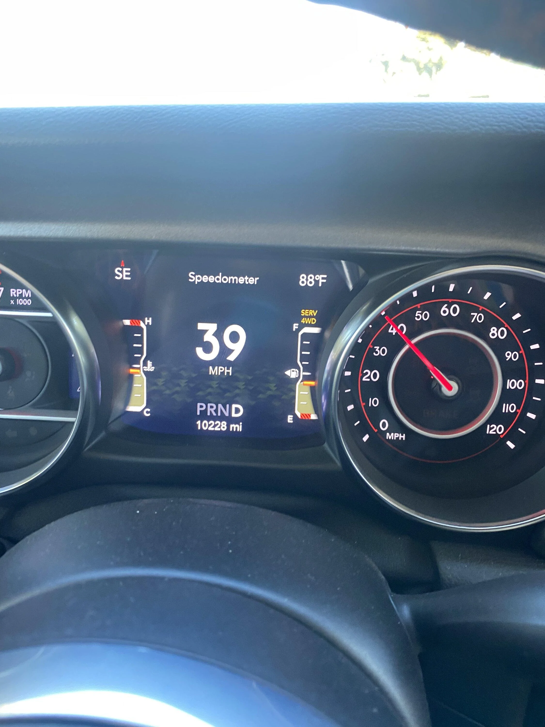

I just picked up my JT after having Currie Extreme 60’s installed. I used @Superchips_Mrktg to make the following updates; tire size, gears, disabled all lockers, and disabled the FAD. The SERV 4WD light is still on. I made sure the module was up to date, and Rebel said they weren’t sure what else to do. Anyone come across this and have a recommendation?

I would bet it is the Superchips programmer. If you used the Flashcal, it is a mixed bag leaning on the negative side.
