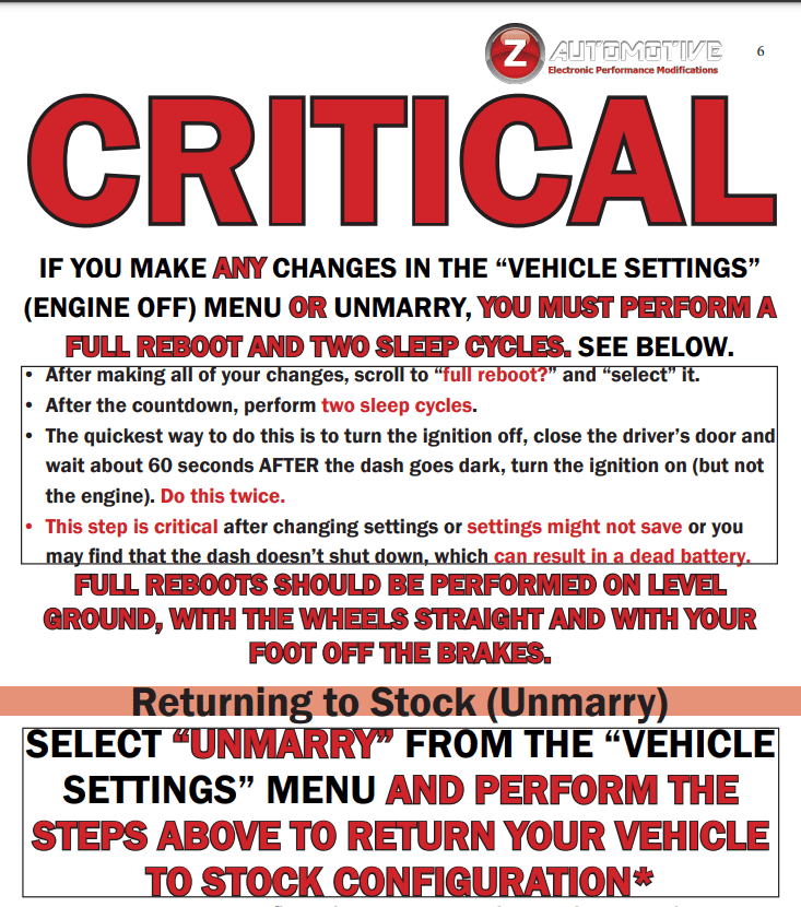

I won’t speak for anyone else but I’ve been using a Tazer mini since the first of the year, before that I was only using Jscan. Jscan allowed me to change all the settings I had needed up until then but there were a few things I wanted to do that required the Tazer live functions. The first couple of months I had nothing but trouble with the Tazer and every one of them was my fault. After reading the instructions and watching videos, I was still not doing the reboot and sleep cycles correctly. It took a lot of trial and error on my part but eventually I got it right. Since then, the strange random behavior I was having stopped and everything has functioned perfectly. In my case, user error was the problem.

I installed my Tazer as soon as I got home from the dealer. Closing in on 70,000 miles later there have been no issues other than one related to a BETA version firmware I was testing which was quickly fixed. 99.9% of "tazer issues" are actually "operator issues", usually the Red Green problem ShadowsPapa alludes to. The small percent of actual issues with the device are always firmware related and are quickly fixed when found.
It's like putting 38" tires on your stock lift Gladiator and then complaining they rub and you can't turn the steering wheel.
Just because taking them back off fixes the problem doesn't mean the tires were defective or a poor design.
