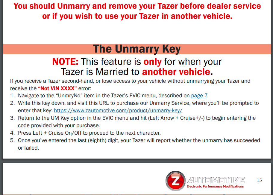

I didn't unmarry it, since it had the larger tires on it. What then should I do now? I only use it for tire size and pressure.
In the zAutomotive app there is an option to unmarry the tazer. You need to choose that and then get the unmarry key and then contact zautomotive with it to unmarry it.
UnMarry Key
You always have to unmarry the tazer when changing vehicles as it is tied to whatever vehicle you marry it to.
UnMarry Key
