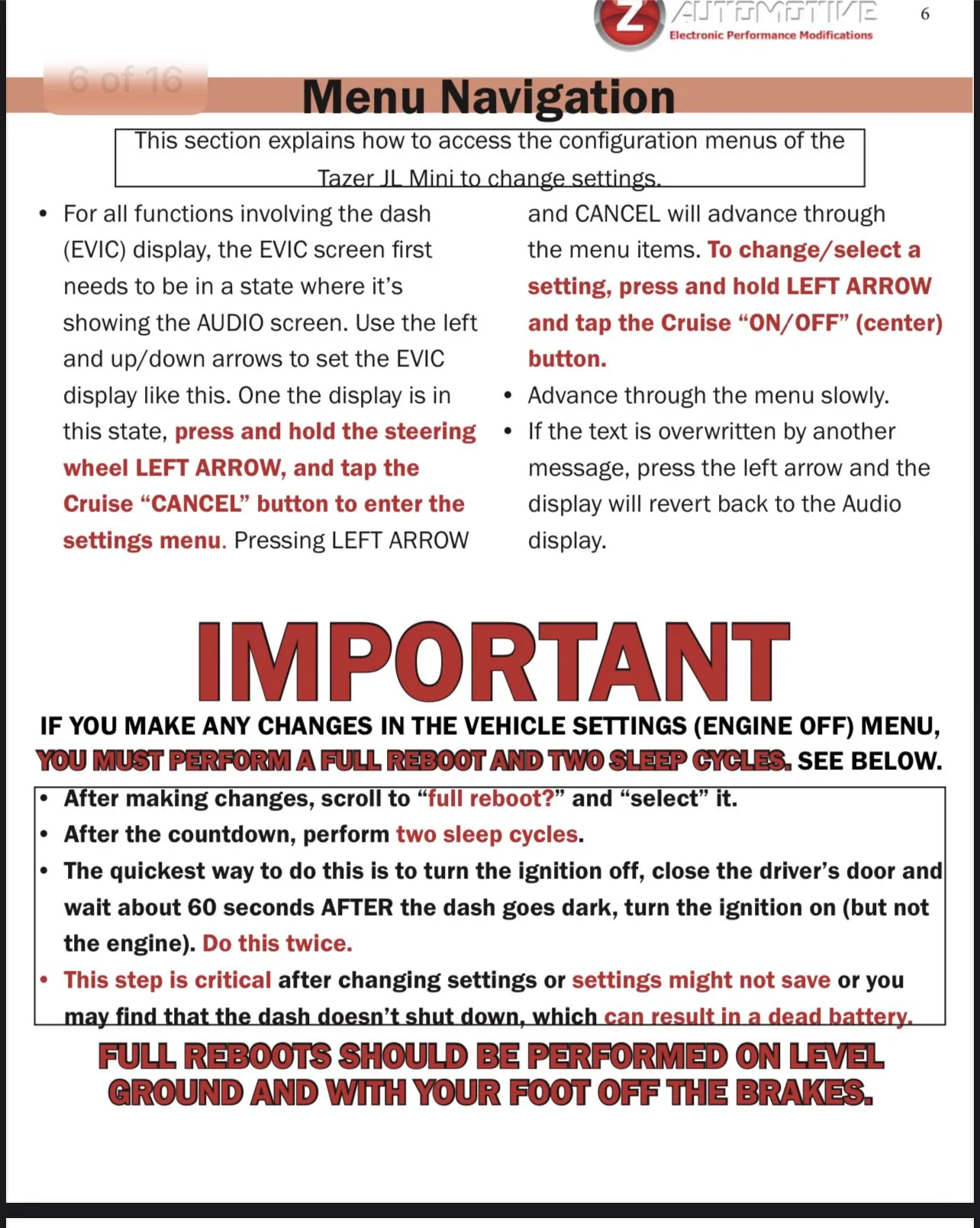

I could be wrong but I bet you're not doing the reboot and (2) full sleep cycles right.
I initially wasnt and started having various problems early on. It wont save your changes etc if this isnt done properly. Bunch of weird stuff happens can happen. I had one reverse light consistently on among other things, etc.

You dont have to unmarry it for a dealership visit. I know ppl say you do. But of course taser doesnt want liability. Think about it. So they have to say that. Its not the case. Unmarrying sets back to default settings on whatever your original settings are.
Prime example. Lets say you changed your settings due to a regear which is a pretty major modification. Unlike a simple tire size change. If you unmarry it then drive it to the dealer with the original defaulted gear setting, you can literally mess your gears up. There was a 7-8 page thread on this awhile back with people arguing this back and forth. Those that think you need to unmarry that have changed gears. Go ahead and drive it or have the dealer test drive it during whatever maintenence on the wrong gear setting and let me know how that works out.
All you do is unplug it and leave whatever is programmed alone on dealership visits.

Sarge - I would think I am doing it the right way as it is saving my settings , I can change it to 32"-37" and its off 2-3 mph no matter what ?

The unmarry thing when you go to the dealer is just a CYA thing for the tazer manufacturer. It returns all the settings back to the way they were before you installed it. Think about it. Do the jscan guys reprogram their tire size back to stock before a dealer visit?
The sleep cycles thing is basically the same as rebooting your PC after installing new software drivers. It's possible the taser settings you made dont really require it (live functions shouldnt) or you lucked out and did the equivalent in normal use. Still, 90% of the "problems" people post with the tazer end up being fixed by simply following the manufacturer's directions exactly.
